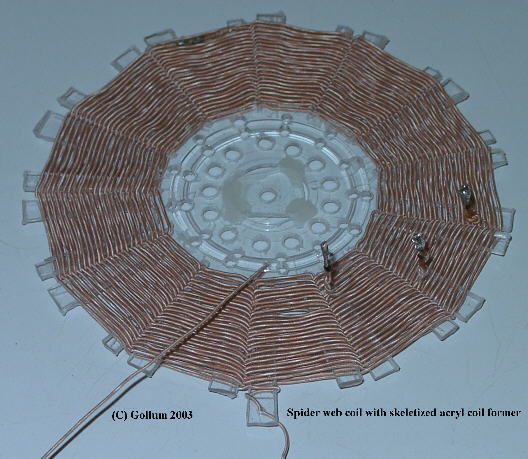

    L1 (transmit coil) - 75 turns of 0.4 enameled copper wire
    L2 (receive coil) - about 250 turns of 0.15 copper wire
    L3 (compensating coil) - 25 turns of 0.15 copper wire
    L1 and L3 are wound under a common shield
    When tuning the sensor it is possible to change places of L2 and L3

                lucifer you can help me for build coil for this detector .l3 an l2?

                  For building the coil it is enough to follow the number of turns and wire diameter. Description says that it is a spider coil type. See image.

                        coils are very hard.please guide ??
