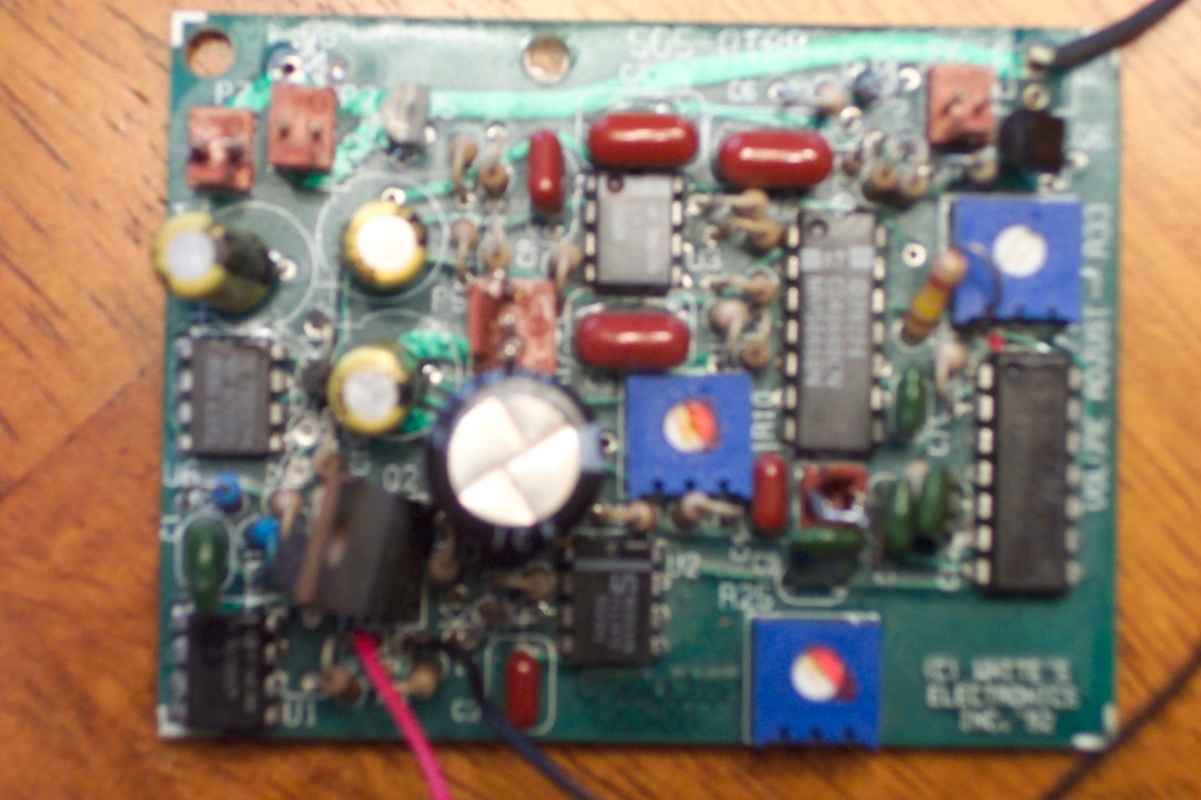

    I have a Whites PI circuit board that doesnt have any of the controls or battery or coil hooked to it. I was hopeing someone could tell me where to connect all of the above to the board. I have included a picture. Hope it is clear enough to point out where to connect everything. This would be the first Surfmaster PI, board says 1992 on it. Cant really read schematics. So any help would be appreciated. Mark
    Battery P2
    Pulse Delay switch P7
    Pulse Delay control P1, near R25
    Tuner P5
    Tuner switch P6
    Coil - two open holes near Q2
    Headphones P3
    Schematic is on this site and the first thing you see
    if you Google "schematic" and "Surfmaster PI"
    Barry
