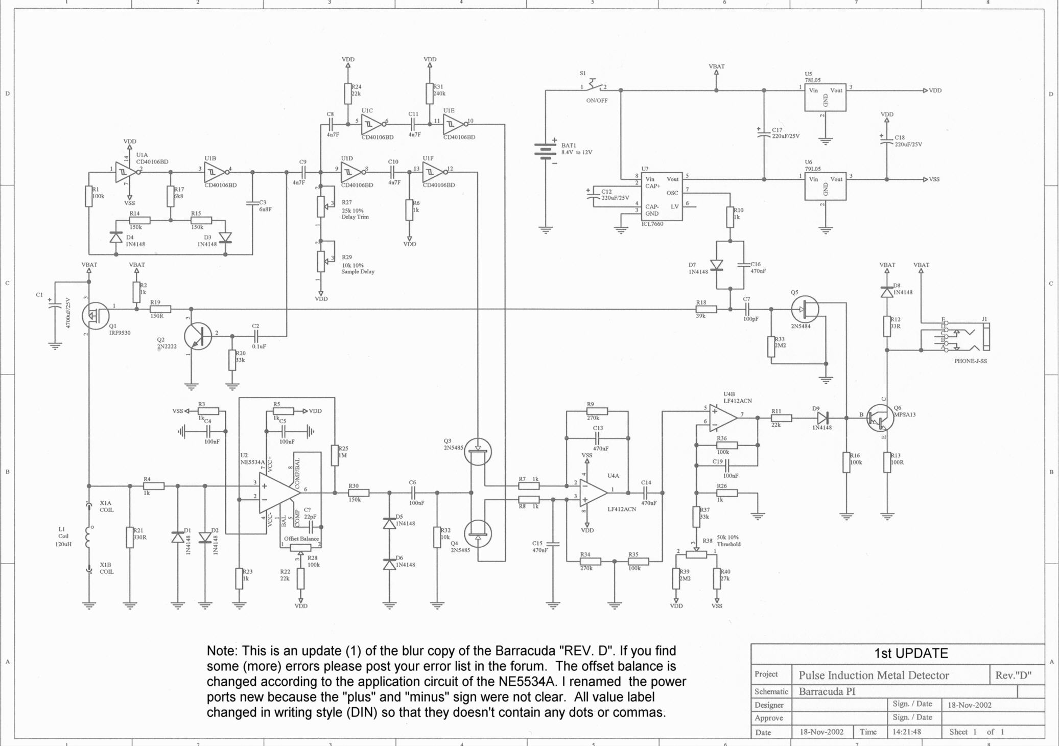

    Here is the first update. If you find some additional errors let me know. In a few days I'll post the final one if there are no more errors.

    I think you will find that Q3 & Q4 need to be matched.
    And C13 & C15 need to be within +/- 1% of each other.
    It would help.

      I haven't checked any RC in the timing circuit - so do it, please. R30 and R32 values are nonsense.

        Also R30 looks much too high. Should be 150 ohms? There are a few other things that don't look right, but it may just be due to differences in design philosophy.
        Eric.
          I show it,
          In one schematic as 120 ohm, and on different one 170 ohm.

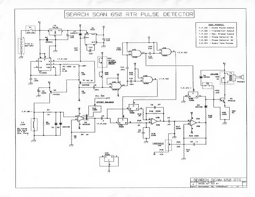

            Schematic before it was a Barracuda.
            Here is a copy of the Barracuda before it was the Barracuda.
            Originaly it was Search Scan. They have since gone out of busness. Anchor purchased the busness and did a little re-design, presto, the Barracuda.
            Bill

              Does someone know the value of the Z-Diodes in the SEARCH SCAN? I can't read this. The diagram is to blur at this area.

                Diodes & coil info.
                D1, D2,& D3 = 1N4148
                D5 = 1N755
                D6 = 1N4001
                D7 = 1N5819
                ( Coil )
                24 turns of #26 wire on 7.5" form

                    d7 psu beside pump 1n 5019 is the zener i beleve it is 9.1v zener chris
                    d5 sounder end 1N755, GODAR, 7.5 V,zener 20 mA
                    the coils i think bill has it spot on .....
