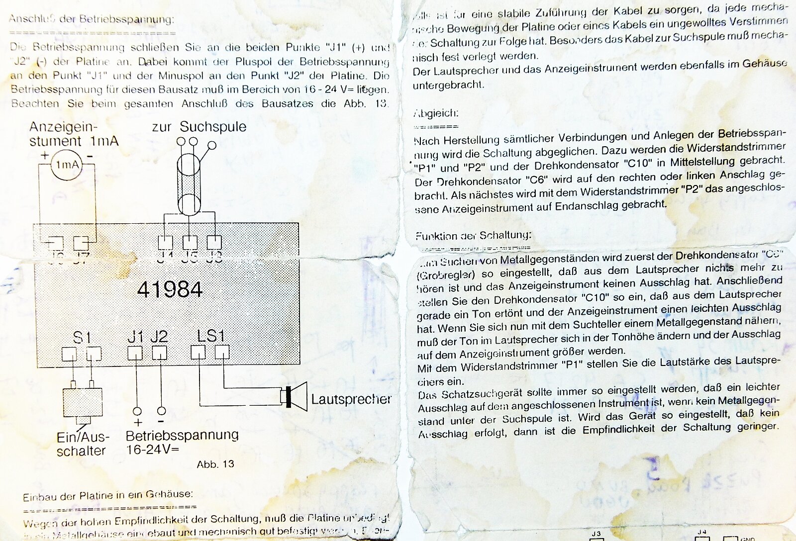

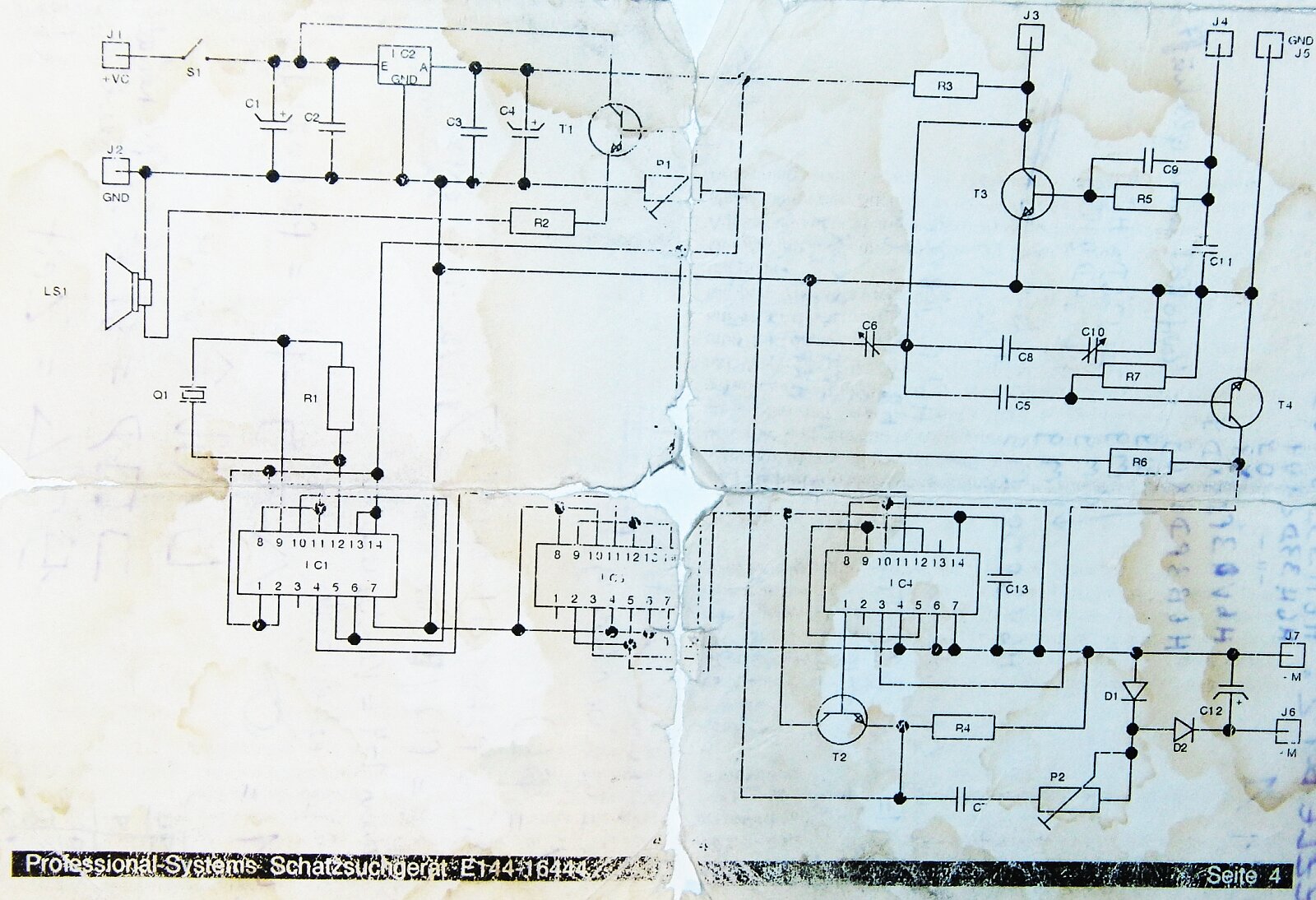

              3 days ago I asked in a german treasure-hunting and metal-detector forum for a picture or scan of platine but so far no response.
              Have you tried contacting Miro Zivkovic?
                Yeah! At least I found the schematic - but near the IC it needs some little recovery.
