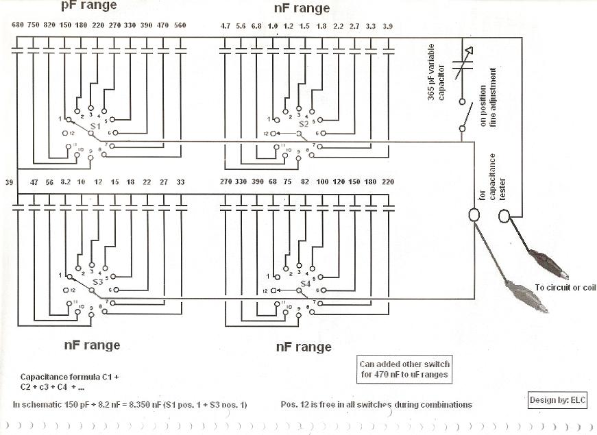

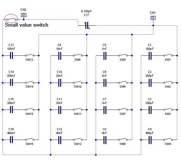

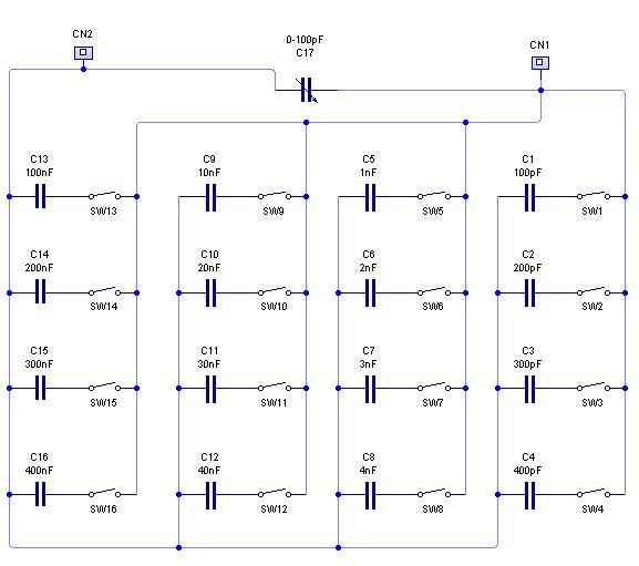

Sometimes we need variable capacitor of big value to establish proper value of capacitor needed for our LC resonate circuit.
Here published schematic show circuit of variable test capacitor, which can change the value of C from about 1pF to 1.111uF.
After finding the true value of C by test capacitor ( we need C meter for such purposes) it is replaced by one or more fixed capacitors to get proper value.

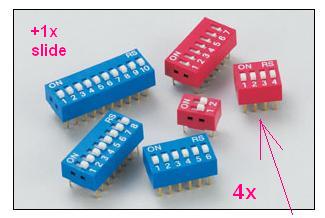

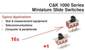

Switches can be 4 x 4DIP switch.
