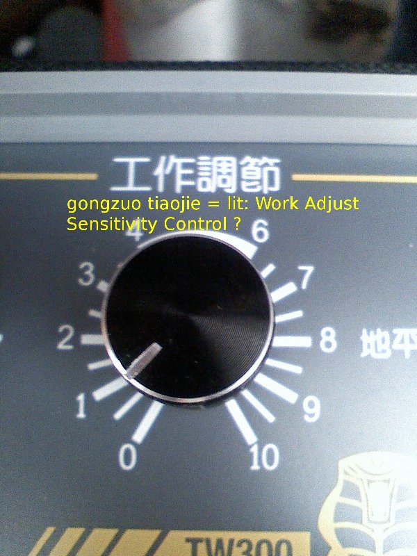

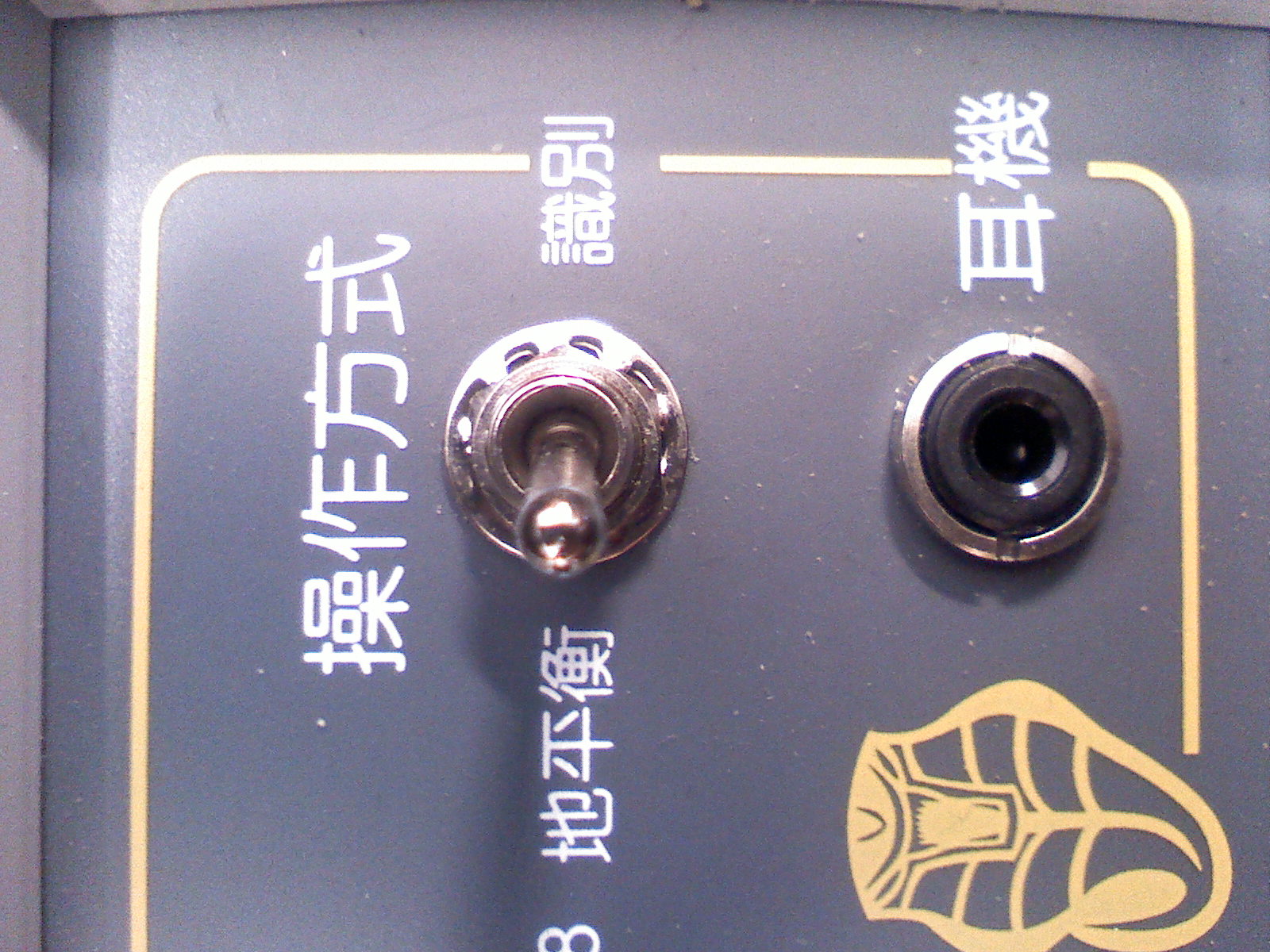

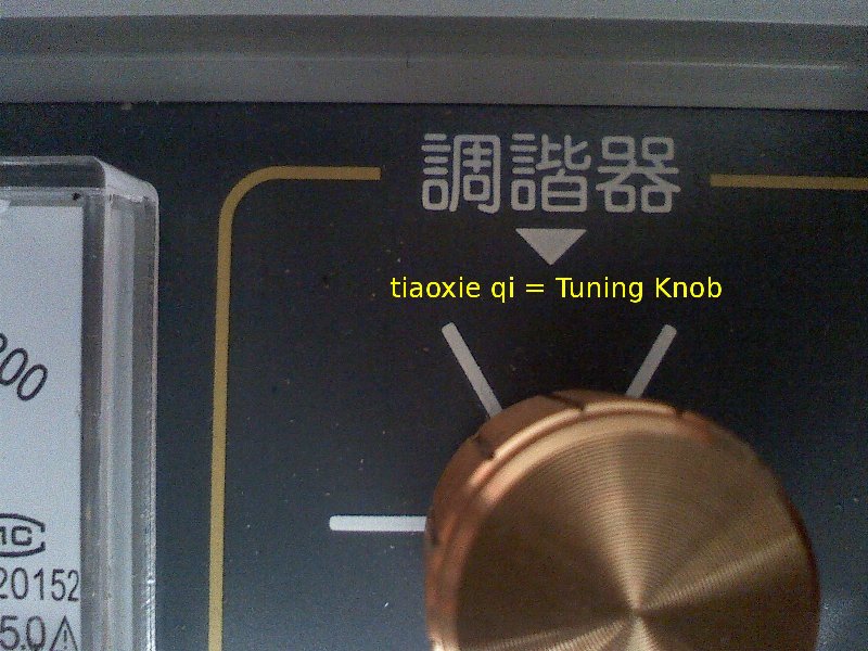

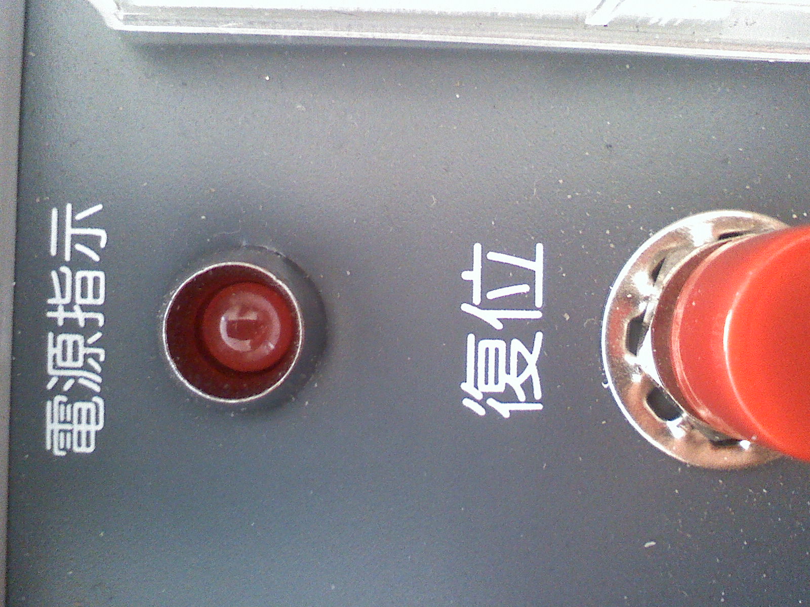

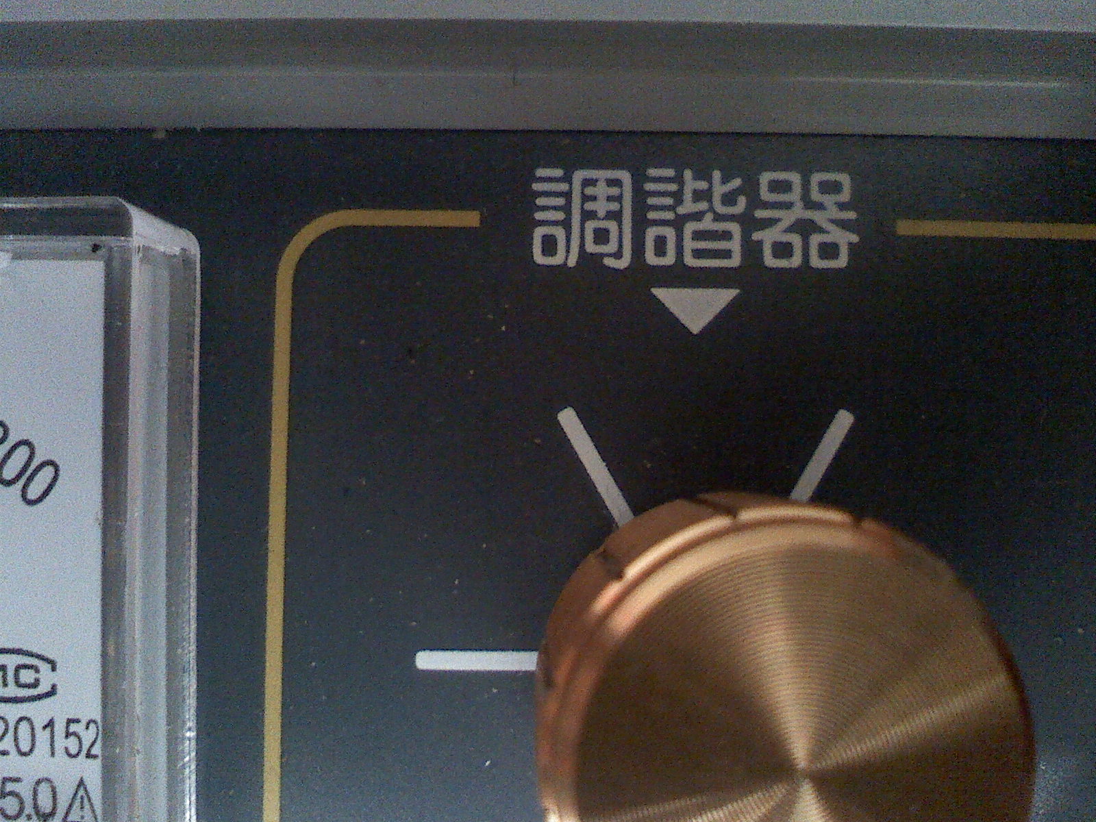

      i have a fiew questions about the control panel.
      <#7 point> is on - off for charging battery ?
      a nd where is the on and off?
      because <#9 point> back on the box there is a socket for charging battery.
      <#3 meter. > for what?
      <#4> this is for sensitivity ?
      <#5> this is for ground balance?
      thanks....

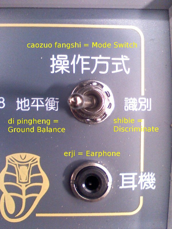

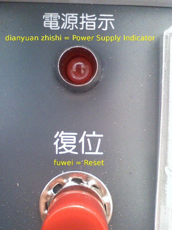

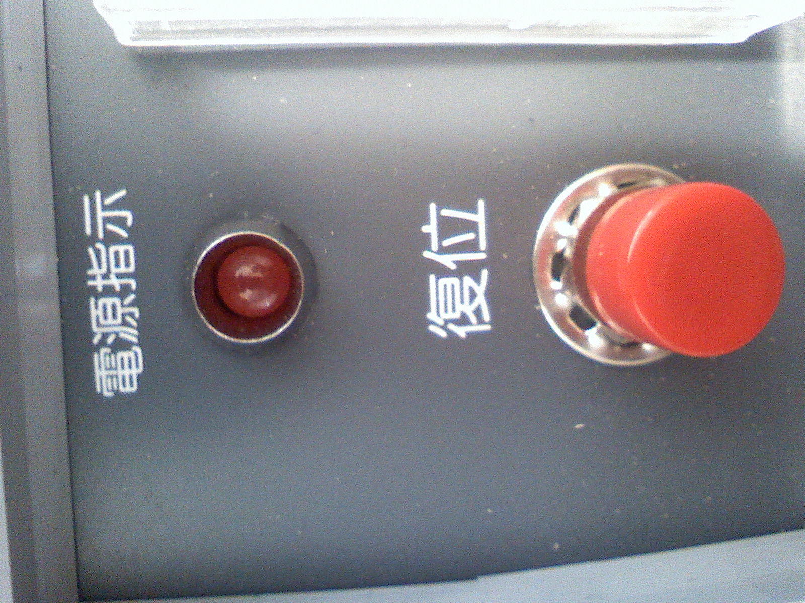

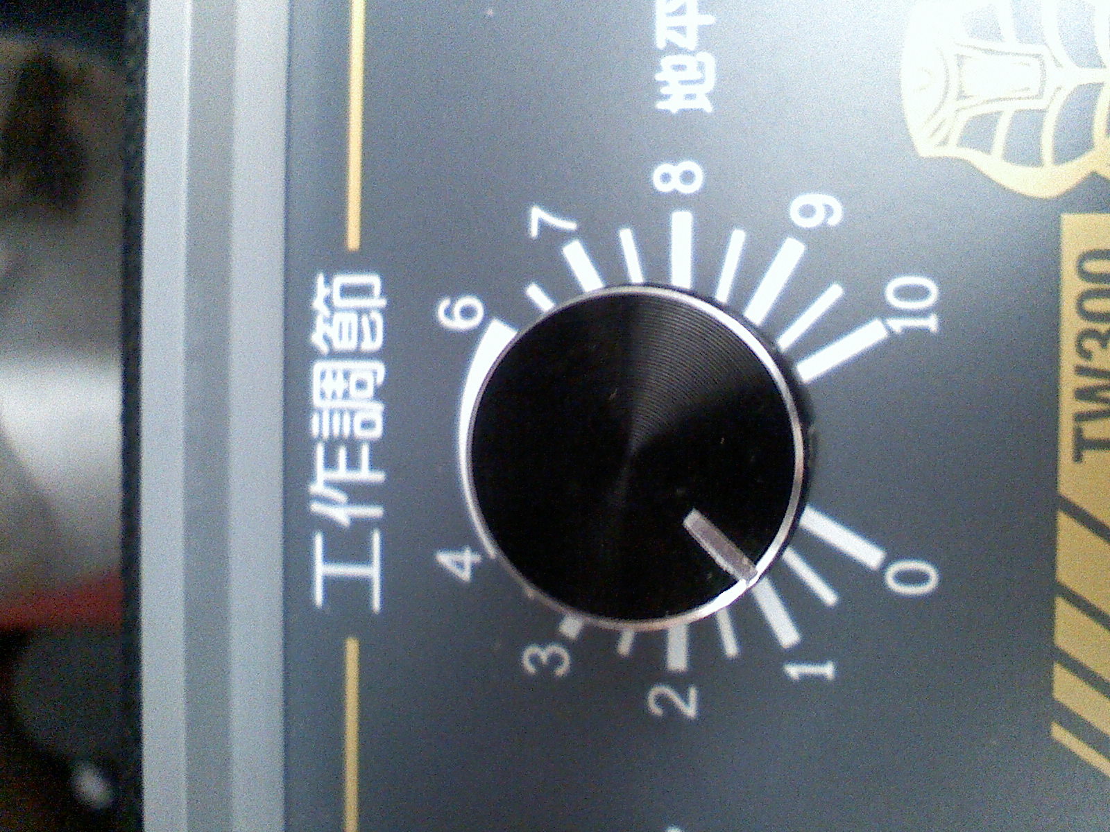

        sorry for late but i was for digging.....take a look my friend in panel of detector and tell me... thanks
          Translation:
            'white's design' again? can you give general photo of the exclusive?
              This is how it appears to work:
              The Mode Switch is set to Ground Balance, you position the coil above the ground, and press the Reset button. Then switch to Discriminate, adjust the Sensitivity control and start detecting. There does not appear to be any ability to adjust the discrimination, so this detector is a simple ferrous/non-ferrous T/R detector.
                thank you very much for the translate my friend you help me very much

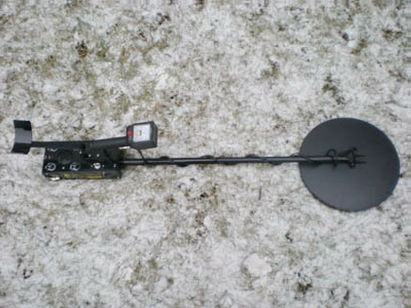

                  But I guess this one here could be a real good deal - the Snake SK500 :
                  Company : Xingtai Daly to technology companiesCountry :ChinaContact person :Jian Wei
                  12V accu, 5m depth, metal discrimination, easy handling, made in 2010
                  Somebody can tell us what it costs and what functions in detail it has? Is this a clone? Anyone here that bought it already?
                  Even if that detector goes just 3meters down it would be very interresting if it costs only around 500 bucks!
                  edit: 3m really seems to be more realistic - here on this page:
                  I found the TS500, also described at chinametaldetectors with 5m:
                  that is has 3.5m. btw. the TS500 is from 2008 and has a weight of 4,5 (8kg).
