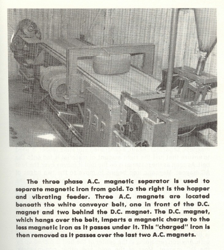

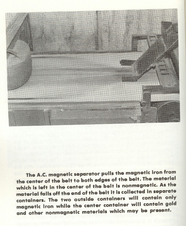

And likewise, I do not want the gold fines in there, with the black sands, as I do not want to melt them all together, WHICH IS WHY I AM ASKING FOR MAGNETIC TRANSFORMER TECHNICAL INFORMATION.
If the magnetic black sands, and the non-magnetic black sands, would not harm the gold and silver particulates of sylvanite and calaverite, I would just put a torch to the concentrates, melt them with borax, and be done with it. But that is dumb! Dumb is not what I want to do. What I want to do, is do it right and perfect, which is why I am asking for technical information on how to build an magnetizer unit...
