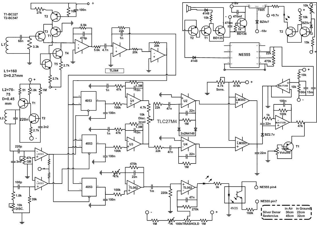

Any suggest????
  • Any suggest????
    Hi all!!!!
    Try this). Ani suggest pleas??
    Magma40
    Re: Any suggest????
    Looks Good. What type of batteries,supply voltage?? Thanks Gene L.
      Re: Any suggest????
      Hi Gene!
      - 18v NiMh 850mA
        Does anibody realized this?
        Hi ,
        i'm writing from Italy.
        Does anybody realized this detector? I would like to try but i need any suggestions to coil made .
        Many thanks
