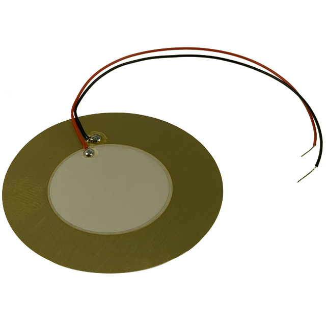

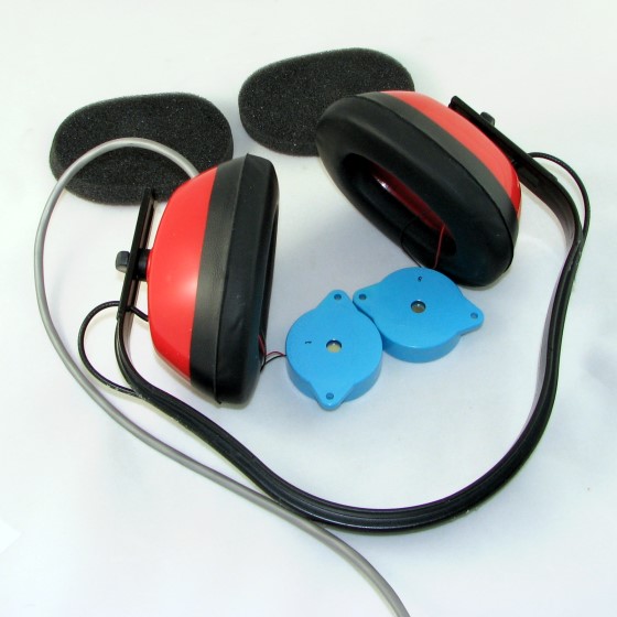

              Please note: you must to put the "crystal Earpiece "and not" ordinary Earpiece "
                How self-made crystal headphones or replaced with low-impedance
                  Crystal Earpiece (Piezo) you can make from: postcard to play, alarm clock, toys ...
                    Thank you
