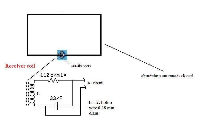

        Does enibody have data of coils for TM 808?

          Transmitter is equal in ohms and wire: 2.1 ohm, wire .18 mm

            Can You tell me, what is mean "aluminium antenna is closed"? Is it aluminium tube, and inside it wire? What are the dimensions of this aluminium antenna?Have this antenna the gap?What is the dimensions of ferrite core and his type?

              he means that antenna is really ONE-TURN COIL done aluminium tube. THE CLOSED LOOP is FIRST winding of the transformer.

                      Tm 808 ferrite core wire resistance R=2,1 ohm, wire diameter 0,18 mm, C=33H (by Esteban).
                      Frequensi is 6,59 kHz, calculated inductance must be then 17,9 mH.The wire lenght 2,24 m (resistance 2,1 ohm measured with multimeter Mastech MS8201H DMM).I found ferrite toroid core (its type probably in russian standard 2000HH) 20x10x5 mm, and get inductance 15 mH , measured with multimeter.
                      Loop antenna I try to made from Cu tube with diameter 6 mm and dimensions 25 cm x 41 cm.
                      I don`t have no experiences with this system yet, but I try in time.

                            Close mean the aluminium antenna is cut in the middle part (gap), but is screwed in this part with aluminium cilinder piece (so, is "shortcircuited"). So the gap is only for to pass the antenna through the ferrite core.
