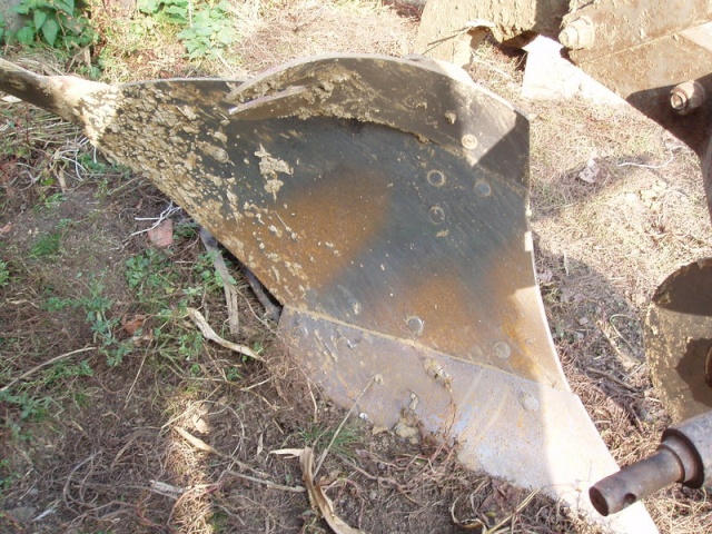

      Maikl, please attach the metal detector circuit! The farmer has such targets buried in the field, but need circuit diagram.
        Poor yhl. I think he meant to say "I'm a farmer who needs a metal detector so I can find metal to recycle from the fields. I need a circuit diagram so I can build one."
