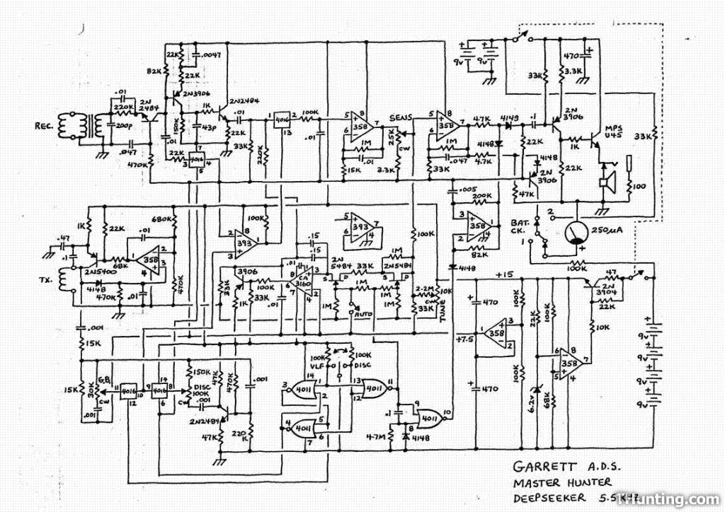

    In the early eighties we had a detector made for Australian soils that was called an A2B made by Garrett. I have one to repair but no schematic. Has anyone got a schematic for this detector?

        Any one have a garrett a2b groundhog schematic vice deepseeker as different slightly

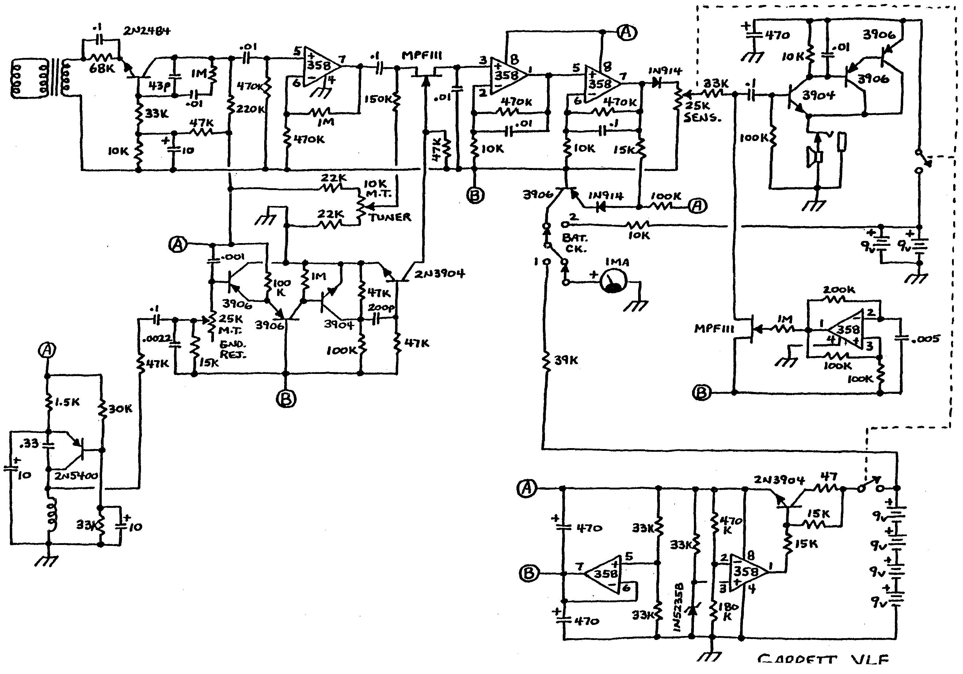

            Thanks kt315 .. but tis missing a couple of chips namely 4011 and 4016 ...CA3160 and CA3290
            Even if someone had a good pic of the main board
              The ADS has those chips, maybe similar?
              Oops no CA3290...
                Agree the circuit is a little similar but is not the same ...
