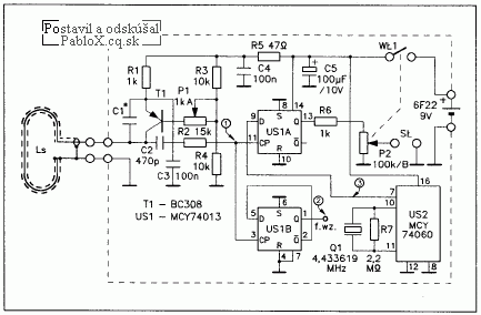

Detektor TRANSET 150
  • Detektor TRANSET 150
    http://www.detektory.wz.cz/download/transet150.pdf
    BFO metal detectors 1.5 m depth

      Congratulations on finished BFO. And thanks for schematic.
      1.5m for 60x60 plate (by 30 cm coil) can be maybe possible in air not in soil.
      Try with x-tal with lower valoue e.g. half so much.

          CD4013 how mixing, after mixing what is that? Sound

            Link is still in live. Yes it is PDF file copy from polish magazine Praktyczny Elektronik 3/95.
            US1A act as mixer and output is audible sound (or beat frequency).

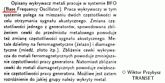

                Fred, according to author Wiktor Przybysz,the abbreviation BFO means BASE FREQUENCY OSCILLATOR.
                  How can you beat that ?
                    Hi Monsieurs.
                    This is normal BFO with stirring 8 harmonic signal from the coil with the signal generator.
                    For the purposes of measuring the signal derived from the coil 17kHz (division by 2 and buffer).
                    The range of active plate 60x60cm Fe is 1.2 m.
                    When measuring the change in tone was obtained with 1 Hz Sensitivity 1.5 m.
                    All measurements in the air in the laboratory.
