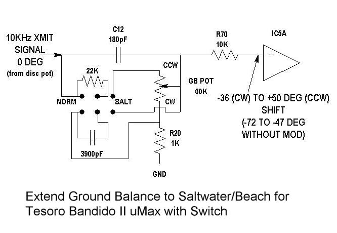

              Salt mode.
              There is my salt mode schematic again
              I worked on this and field tested for a while. Keep in mind that in salt mode you will also detect iron. Therefore it was not really worth the trouble. But it proves it can be done.

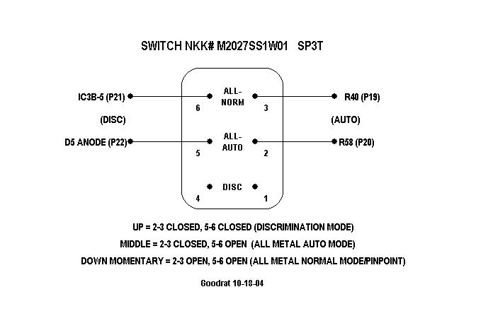

                Switch revision
                This switch has a type of binary coded operation. They call it a SP3T. I have this installed and it makes a lot more sense to have a switch like this. Only one switch and you get disc mode, all metal, or all metal momentary with normal tuning for pinpoint. It is a $10 switch though.

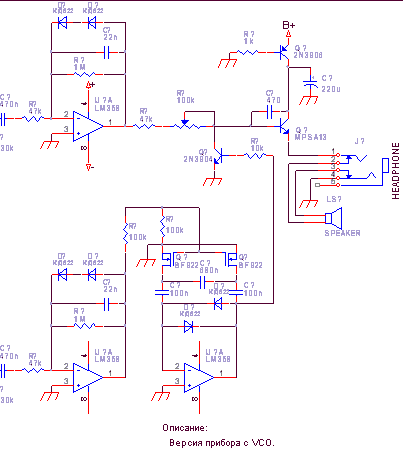

                      VCO Plus
                      I think to do it for Volksturm... new option. you can take it to update of your project. to you attention very effective and simple logarithmic VCO has been offered by Ciklon and Anker.
