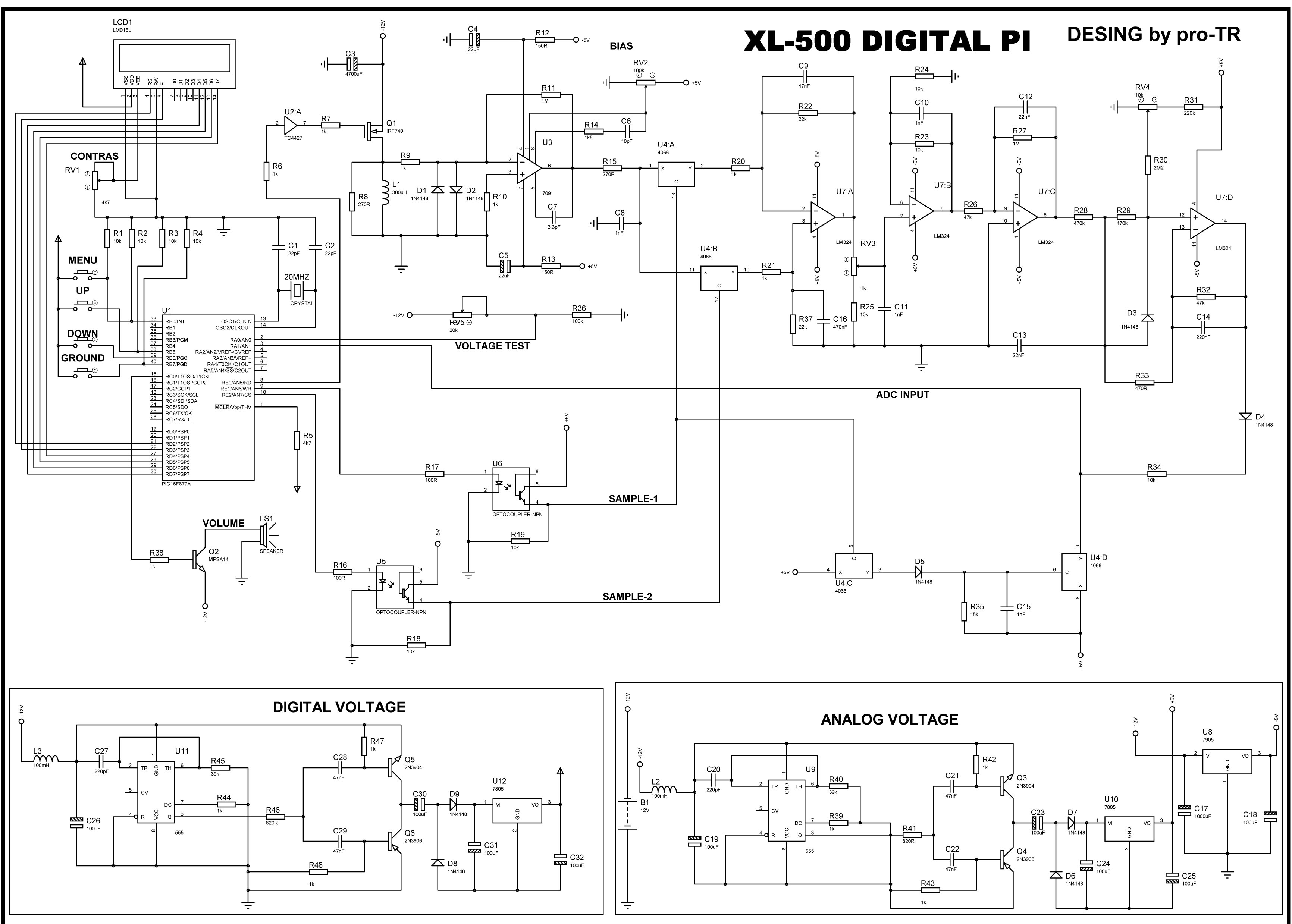

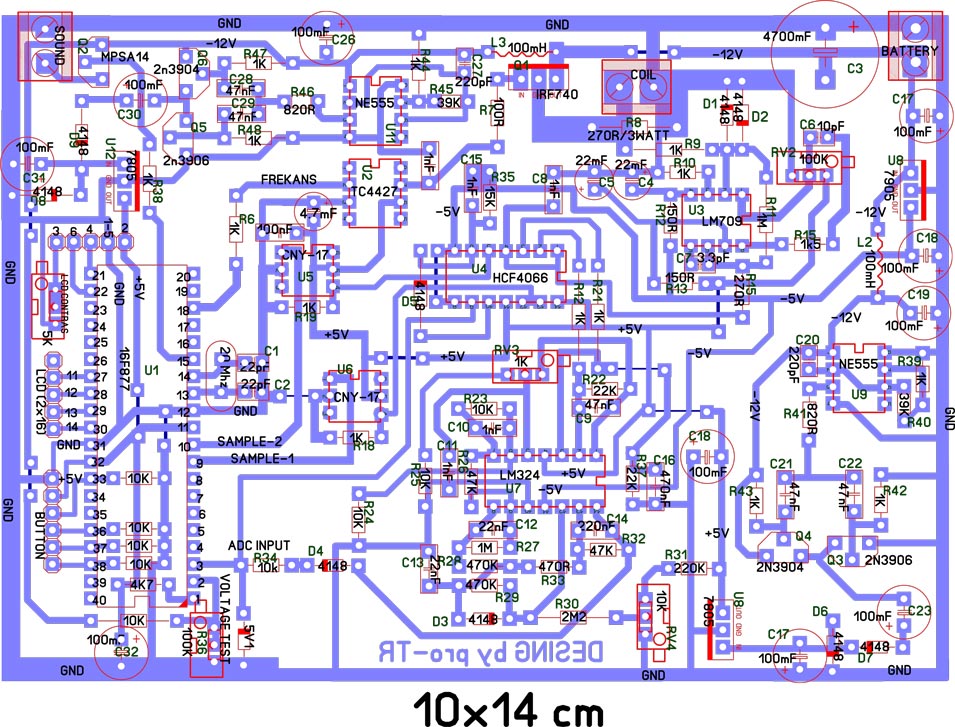

    PCB scheme was okay. Please if there are mistakes, we fix the errors. I do not know English. I'm sorry.
    ok micheal.
    available on the pcb will take time. create the circuit, run it. software would be as follows:

      Dear ahmet19. As success with the software? You have already collected the device? Results?
        hi, plz pcb orginal an hex file
