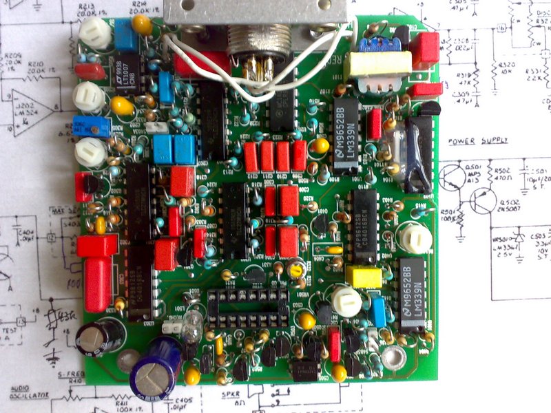

    I copied Fisher included but I started making boards yet.
    Has anyone ever copied from the original above mentioned device?
    During the repair the device I was able to improve the device characteristics and depth led to a modest 35cm in a country the size of the case 10mm.

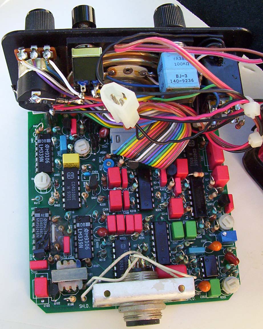

    there are two versions of F-1266x. one is two boarded and another seems more modern is single borded. what one you do?

      kt315 not be angry, but the Serbian translation is bad (has no meaning).

        Maikl,
        can you share good quality semiprofessional photos of the PCB of both sides? this guy gives nothing! the forum is VERY READY to give all info, but the forum itself is needed in the fresh info incoming too more than his. I need neither in good Serbian not in good English not in translation.
        waiting anything from you... maybe you see these at Serbian forums anywhere...

          kt315 completely agree with you: "good quality semiprofessional photos of the PCB of both sides". I would not have given a comment (that would not re-occurred and insulting arguments). I'll just say that I'm suspicious: "modest 35cm in a country the size of the case 10mm".
            35cm u yemlji nije skromno , al niste naveli velicinu sonde koju ste koristili i dali je koristena fabricka sonda ili pravljena dali je dd ili koplanar , takodjer niste naveli nesto kao problem pa to i navodi pretpostavljam i maikla i kt na sumnju i raymisljanje oko dubine u yemlji .

              There is Fisher's one more version 1266. Look distinctions with a payment KT315.

                your PCB is more modern. date marks of IC's on my photo are 93xx, on your 96xx 99xx.
