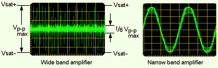

      Homefire, please read my posting #7 to understand why the circuits in your links are primitive. Posting #7 contains information for design of modern BFO type metal detectors, but it is only a part of design principle. The problem is how to design amplifier used in search oscillator.
      The following description of improved principle for search oscillator is not to **** KT315 and Maikl that BFO metal detector has future, but is just continuation of analysis started with posting # 13. Those who believe that the principle of metal detecting with search oscillator (BFO) has no future, should be interested what principle has a future. Let we analyse the best operating principle for a future MD without search oscillator. I described three main things of this principle in posting #13.
      Let continue with question "How to classify a BFO metal detector in frequency domain if there are only two types? Whether BFO is narrow band or wide band?"
      The TX coil of search oscillator creates magnetic field with "noise induction". In oscope (in time domain), noise induction seems different from sine induction and pulse induction, but how seems frequency spectrum of noise? As you know the noises are different in "color". Wide band means "white" noise.
      We can design a metal detector using white noise generator to drive TX end stage. The TX will operate without oscillation. The BFO MD is specific case of this design because instead noise generator we use an amplifier having very high gain. The gain can not be achieved using in amplifier only one transistor. Our amplifier should amplify internal thermal noise until output starts to saturate.
      Let we use in search oscillator an amplifier with adjustable bandwidth and gain. Imagine a MODE switch having two positions: NARROW BAND and WIDE BAND. How seems output of such amplifier at different modes when feedback is disconnected. It can not oscillate.
      The left figure of attached image shows output when MODE switch is in position WIDE BAND. The gain is increased until output starts to saturate. The noise seems as a band thick no more than 1/8 to 1/6 of distance between saturation thresholds.
      The right figure shows output signal at NARROW BAND position. We should increase the gain to obtain operation near to saturation. This is most important effect of narrow band operation because increased gain means increased sensitivity. The visual effect is as if there is a chaotic modulated oscillation, but in reality is amplified noise at a narrow band.
      After we designed a search oscillator operating as narrow band or as wide band metal detector, remains to write in the operator's manual when BFO MD should operate with MODE switch in position NARROW BAND and when in position WIDE BAND. Since this question is as quiz relating not only to BFO but to all kinds metal detectors, I will put discussion also in section "General Electronics". The title of this thread will be something like "Block diagram of RX for ultimate metal detectors" or something more short.
