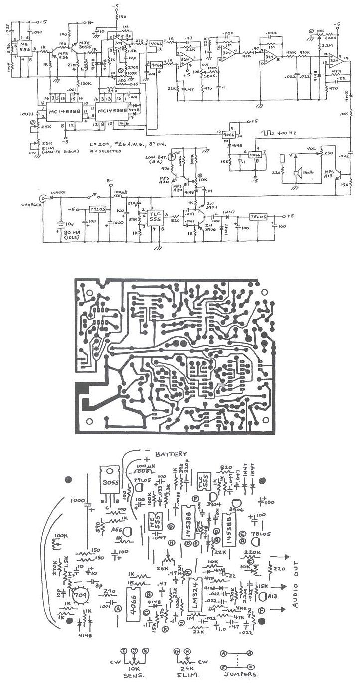

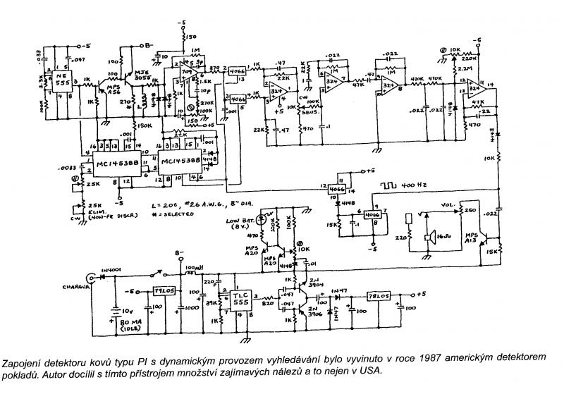

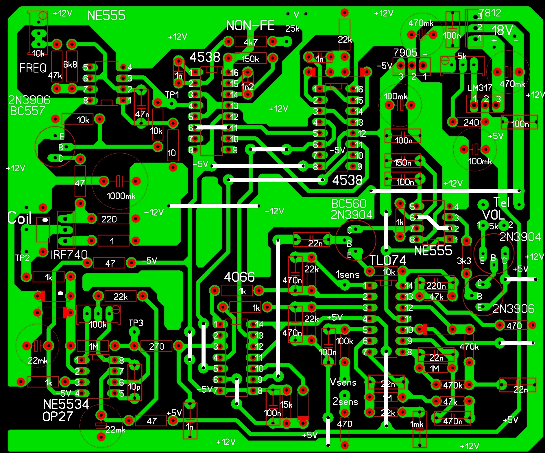

    Who is the scheme to the PCB?
    This is very familiar to me.Give more details.

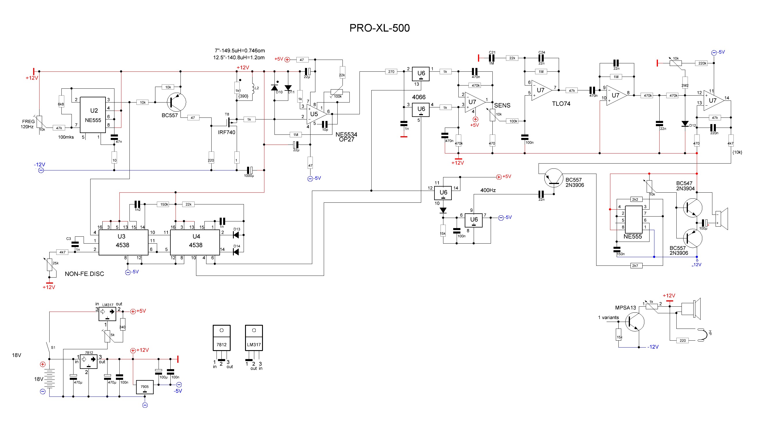

      It is, I think, based on the schematic & pcb that is in post no 14. I see some "modern" components Ne4434/uA709 , IRF740 etc. and higher volt 18 / 12...
      Do you have the sprint layout file from it ?
      Regards.
      Ap
      in the past I made a working board from the pcb that is in post 14, it is working good ! no disc ! only all metal as most PI detectors !
        For ApBerg
        Hello ApBerg!!! I found the scheme to the detector. This modification xl 500. Scheme to check. If you awake to the PCB, do please long. It is they you have a good turn out. Yours!
          XL500 mod

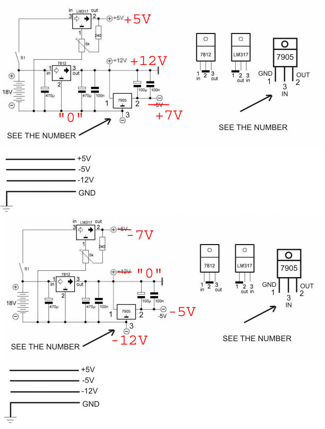

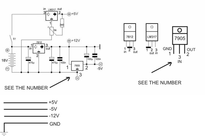

          Hello, everyone! This scheme is "HL500 mod". The power unit is 100% incorrect! LM317 (+5 v) will not work! 7905 (-5v) is not correct! 7812 (-12v) incorekt,to be replaced in 7912 and to include correct !
            sorry for bad English G.L.
            Good observation! That power supply is in trouble.
              Warning In the scheme a lot of mistakes. You need a lot to refine.
                errors about irf740
                alot of error

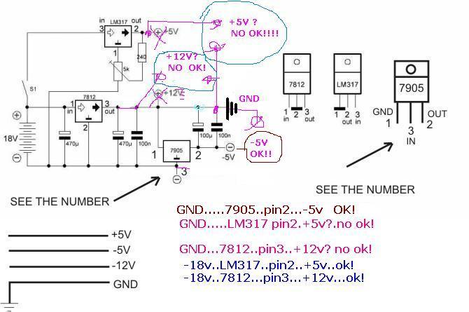

                  Hello furum,
                  I have tested POWER SUPPLY OF THE XL500
                  It is OK 100%, please take your protoboard and test in 10 minutes...i have
                  and i thing all the schematic is good!!!!
                  Have nice day
                  Alexis

                    Hi, Aleximes! I think you're wrong! Look again shematic PS XL 5OO. OK?
                      Hello Georgi
                      I have post in another thread power
                      See i have explain this time with colors
                      if you make this powersupply and measure voltage between green line (GND) and the others you have +5V, -5V, -12V
                      just what you need !!!for the Xl500 PI
                      The only inconvenience is if you use 3 Gel Cel batteries of 6V to sum 18V
                      very heavy
                        Please note that the scheme is nowhere common ground, Where draw-12V, in fact, probably, GND. And I think that the power of +18 V, it is unnecessary. 7812 can be thrown out and do a good power supply from the battery +12 V
                          very heavy

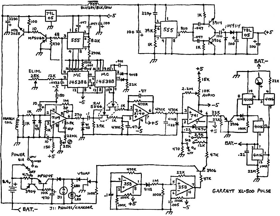

                          certainly you are wonderkind and garett's engineers are idiots vs you. why you did throw THE CONVERTER +5V from XL-500 on the scrap-heap?
                            REAL Garrett XL-500 schematic here.
                              Hello KT315
                              I know the schematic from many years ago and i have in my archive....
                              Ing garrett !!!....Because with a converter you can work with 8,4V and the pro500Xl work with 18v without converter!!!!!see
