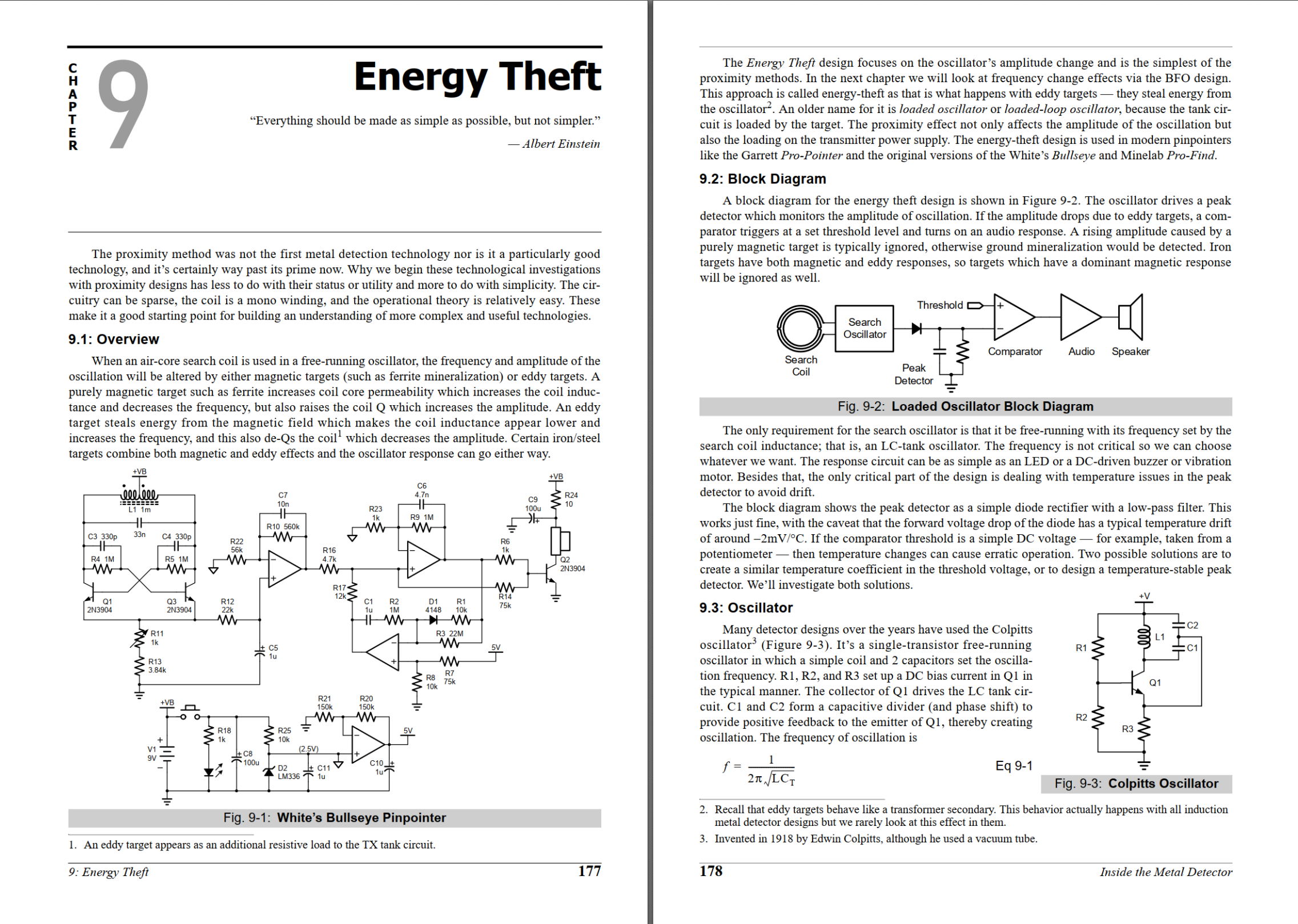

              • Been following this thread off and on for years. There are certainly some knowledgeable people on this forum! Can anyone provide a circuit theory of operation for the MD20 as it stands today? I think that would help a lot in understanding where possible improvements can be made.
                Thanks!
                • Originally posted by jtz54 View Post
                  Thanks!
                  It's a Colpitts oscillator, the amplitude changes depending on the magnetic coupling to the target. The sine wave is rectified to produce a dc level and modulate the audio signal. The frequency changes too but that variabke isn't used.
                  • It's a classic "energy theft" design, covered in Ch 9 of ITMD3.
