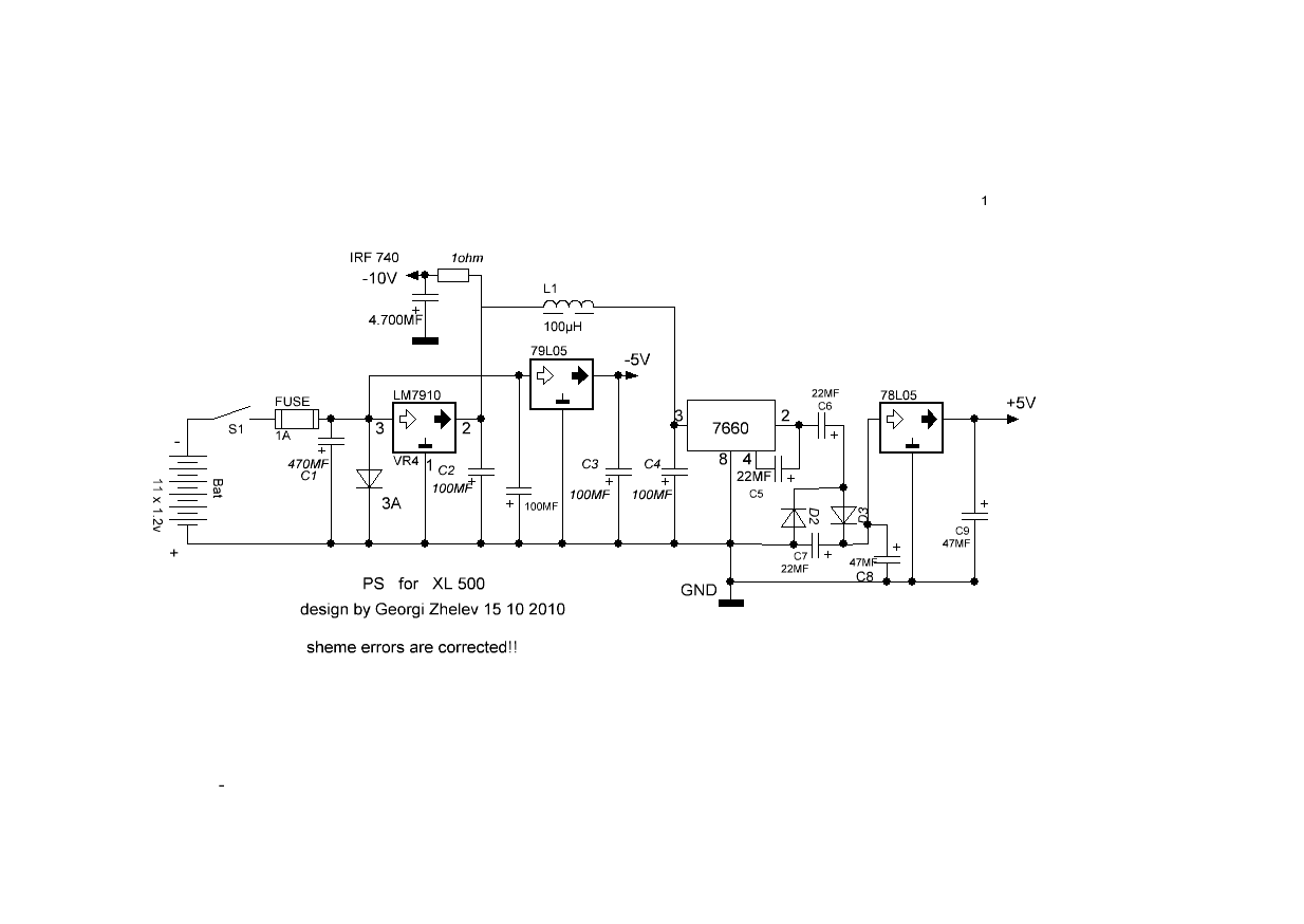

Power supply XL-500
    Georgi, the size of paper for your circuit diagram is not designed properly. Too many white field around a small circuit.
      PS
      Здр. mikebg!Разбрах ,че не стана както трябва,но за първи път ползвам S PLAN 7 за чертане на схема и не съм на ясно кое как става .Защо не мога да направя корекция на схемата,нямам такава опция.
        Right klick on the circuit picture and select "Open with" Paint program. Then Edit>"Select all" and move circuit in upper left corner of sheet. Then move bottom border and right border according circuit dimensions.

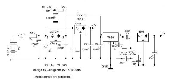

          PS XL500 (cor.)
          PS XL500 (cor.)
            Thanks friends for this nice team work to make a good power !!
            Best regards !
            Ap
              Thank you Georgi very much.
              Your resized schematic:
