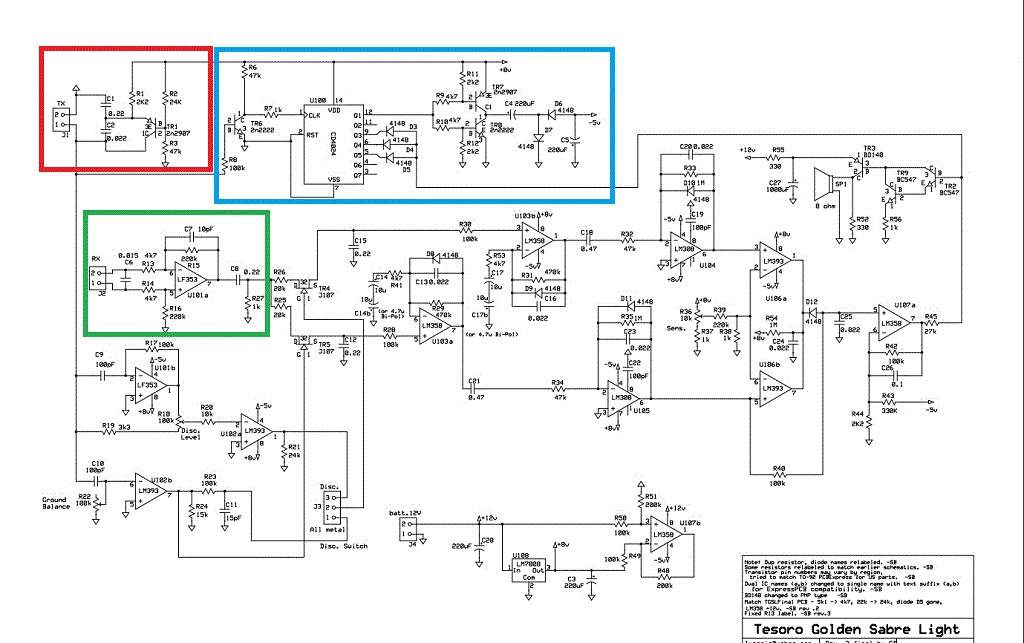

    My advise would be to use a commercial coil in your project (at least for the first stage) otherwise you'll probably fall at the first fence.
    Have a look at the Tesoro Golden Sabre Lite (TGSL) ->
    Your quickest route to success IMHO would be to build the TX oscillator circuit and RX pre-amp from the TGSL, and to use one of their coils with the 5-pin plug. These coils come up on eBay quite frequently.
    Alternatively you could get some ideas from the projects section ->
    Good luck!

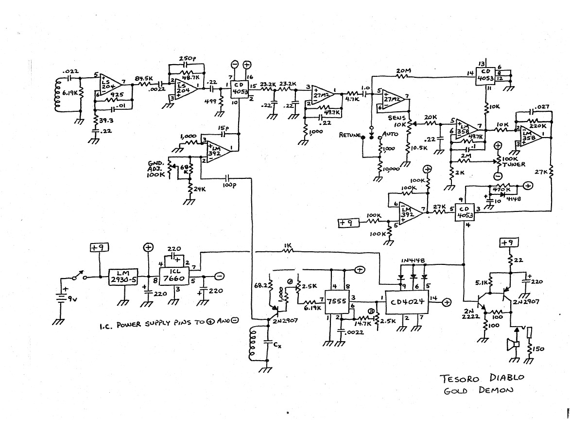

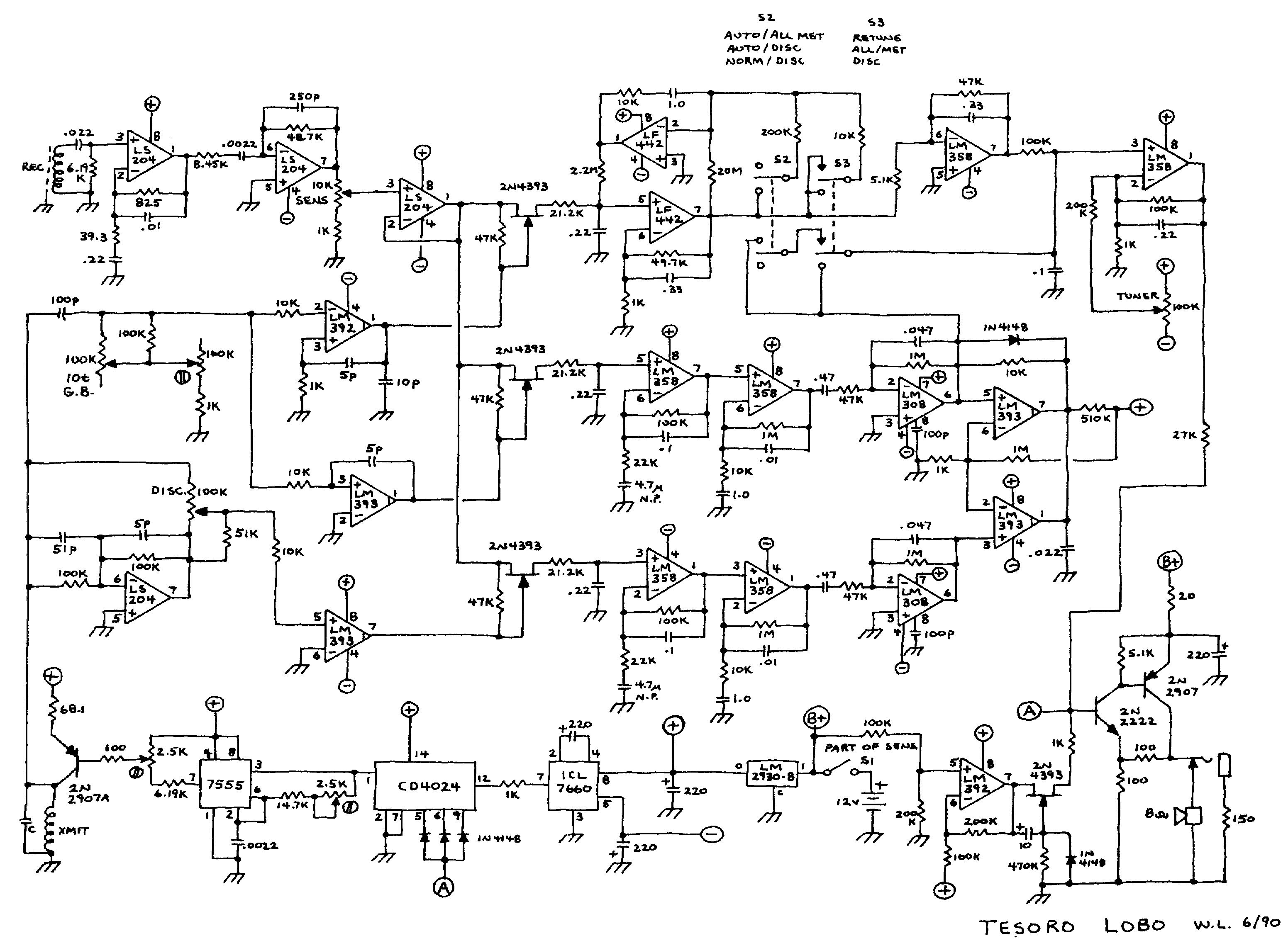

      Advice from Qiaozhi is o.k. but you can also look here for the schematic from the Tesoro lobo or diablo , there is a nice transmitter and receive circuit in it
      Go for 18-19 kHz, but 200-1000mA (1 AMP) is a to much

        I agree. For this particular application, where the coil is to be driven from a micro-controller, then the Lobo or Diablo would be good choices.
        Here are the schematics ->

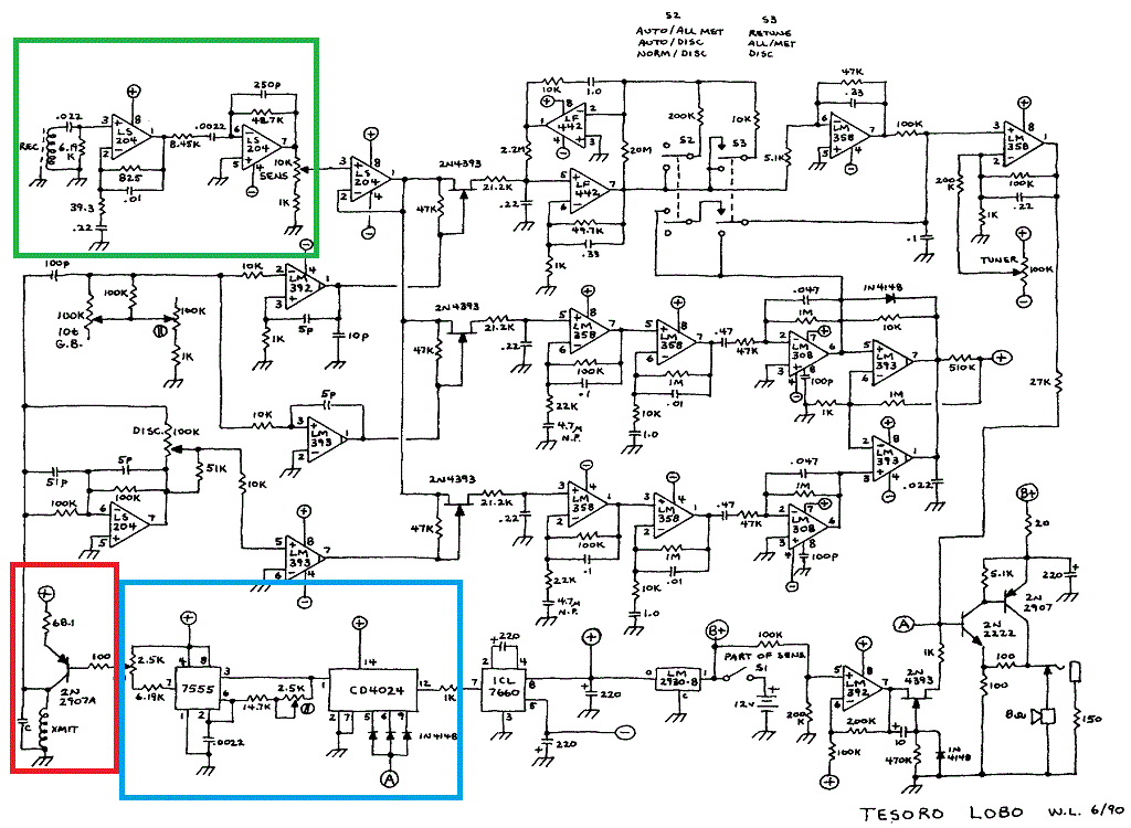

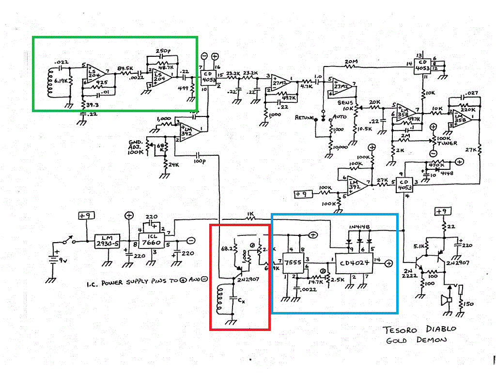

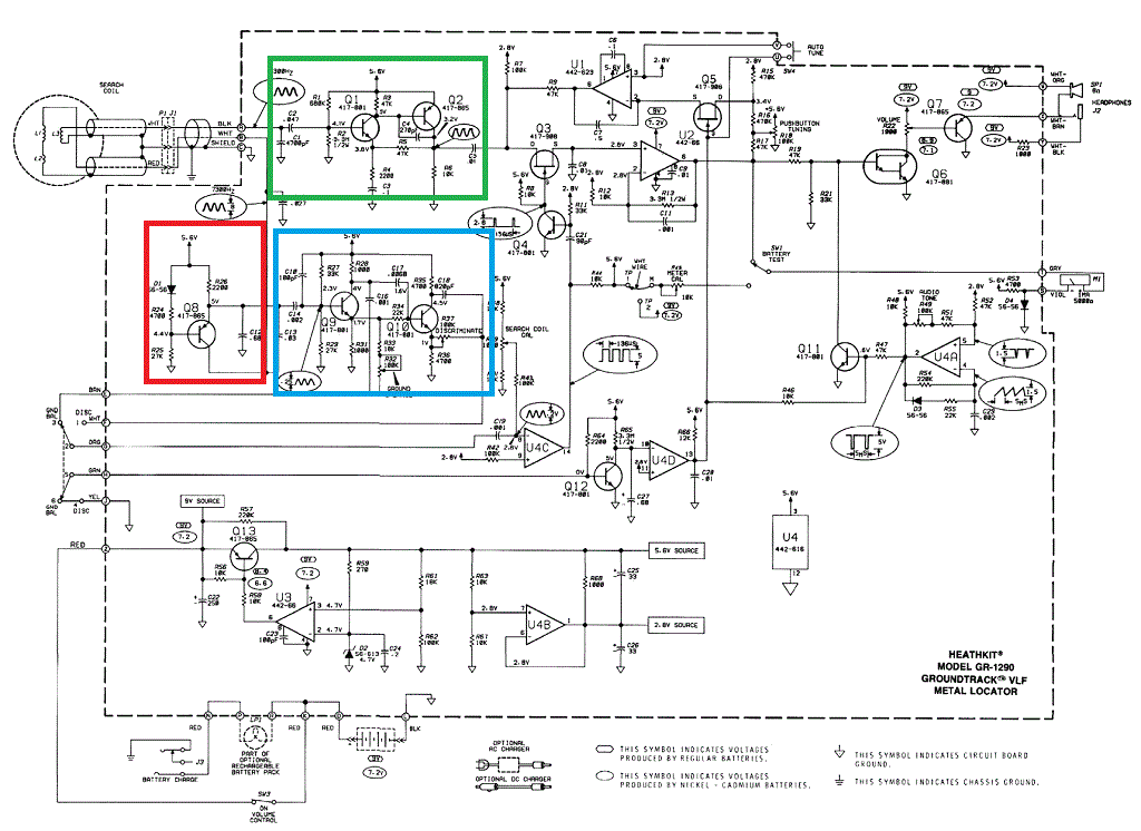

          So I walked through the 4 different schematics, and here is what I got. Am I close?
            Some more thoughts as I look through the schematics.
            TX Amp: All 4 use some from of a PNP transistor as the amp. Most are using the 2n2907a with the exception of the heathkit which uses a MPSA55 transistor. Easy for me to chose a amp circuit.
            TX signal gen: I see what looks like a flip flop, and three variations based on the cd4024. I think I drive the TX signal generation circuit with the Arduino. Any objections?
            RX opamp: I see two different approaches, but I think the dual LS204 will give me the best results.
            Sound like a good plan?
              Obligatory. Why else would use Arduino? All signal processing to fall into Arduino.
              Tesoro front modules are good choice, I think.
              Wish you full success!
