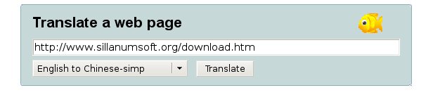

                      Try using the BabelFish translator -> http://uk.babelfish.yahoo.com/
                      Enter the website address and select "English to Simplified Chinese" translation.
