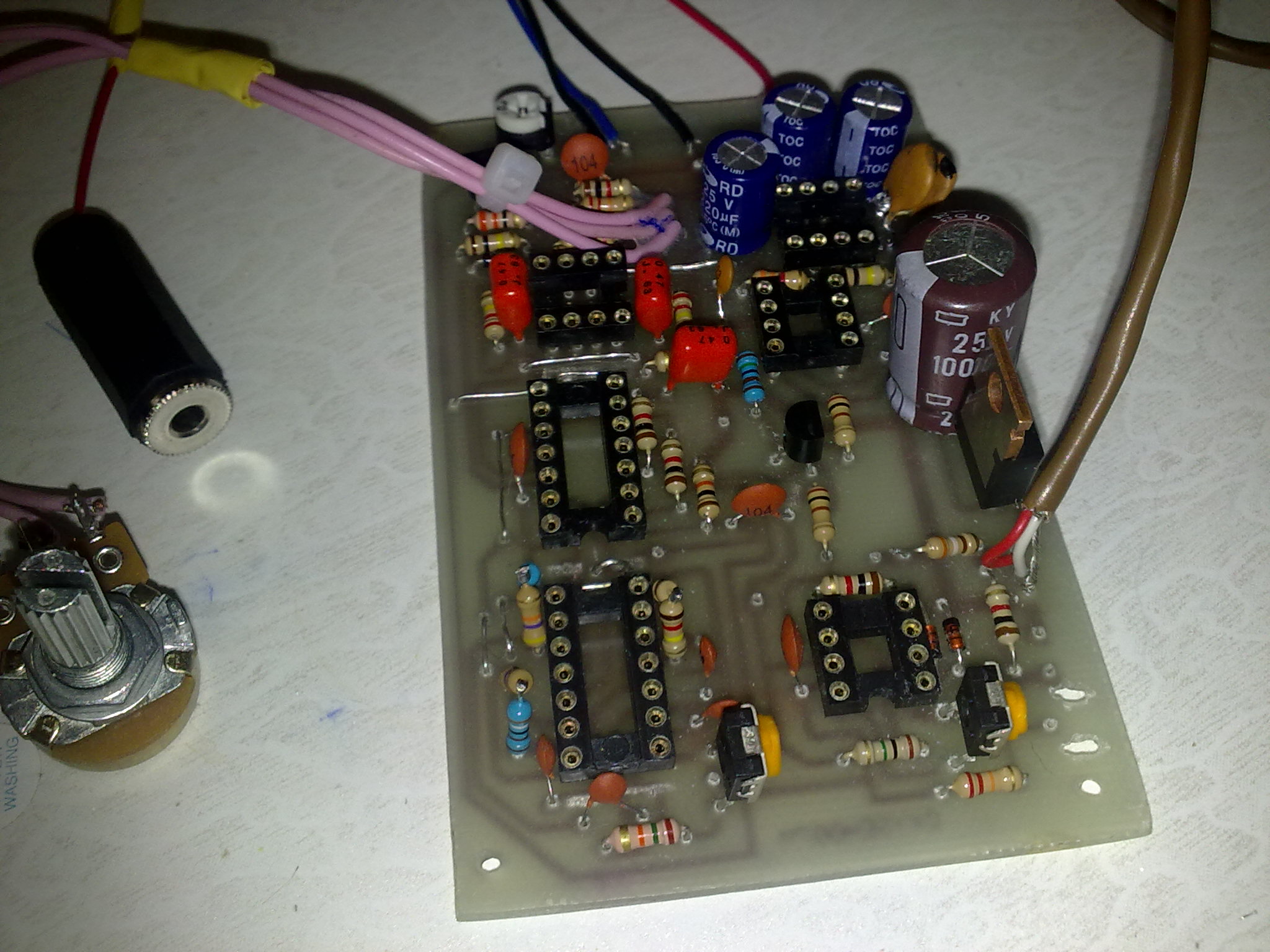

    i remove the 7805 and verify it, it is broken, and may be my 7660 damaged too because in last test its pin 5 was +0.8v but i am not sure yet.
    i am using headphone and i am sure that the two transistors in the correct locations. i will buy 7805 tomorrow and i will do what you say dear bklein.
    many thanks for your helps

        i chenged the 78L05 and pin 8 of 7660 is +5.13v and pin 5 of 7660 is +0.7v so may be it is damaged, true?
        the current consumption is about 200mA yet. i do this test with removed coil and 390 ohm resistor and all ics except 7660.
        thanks to your help

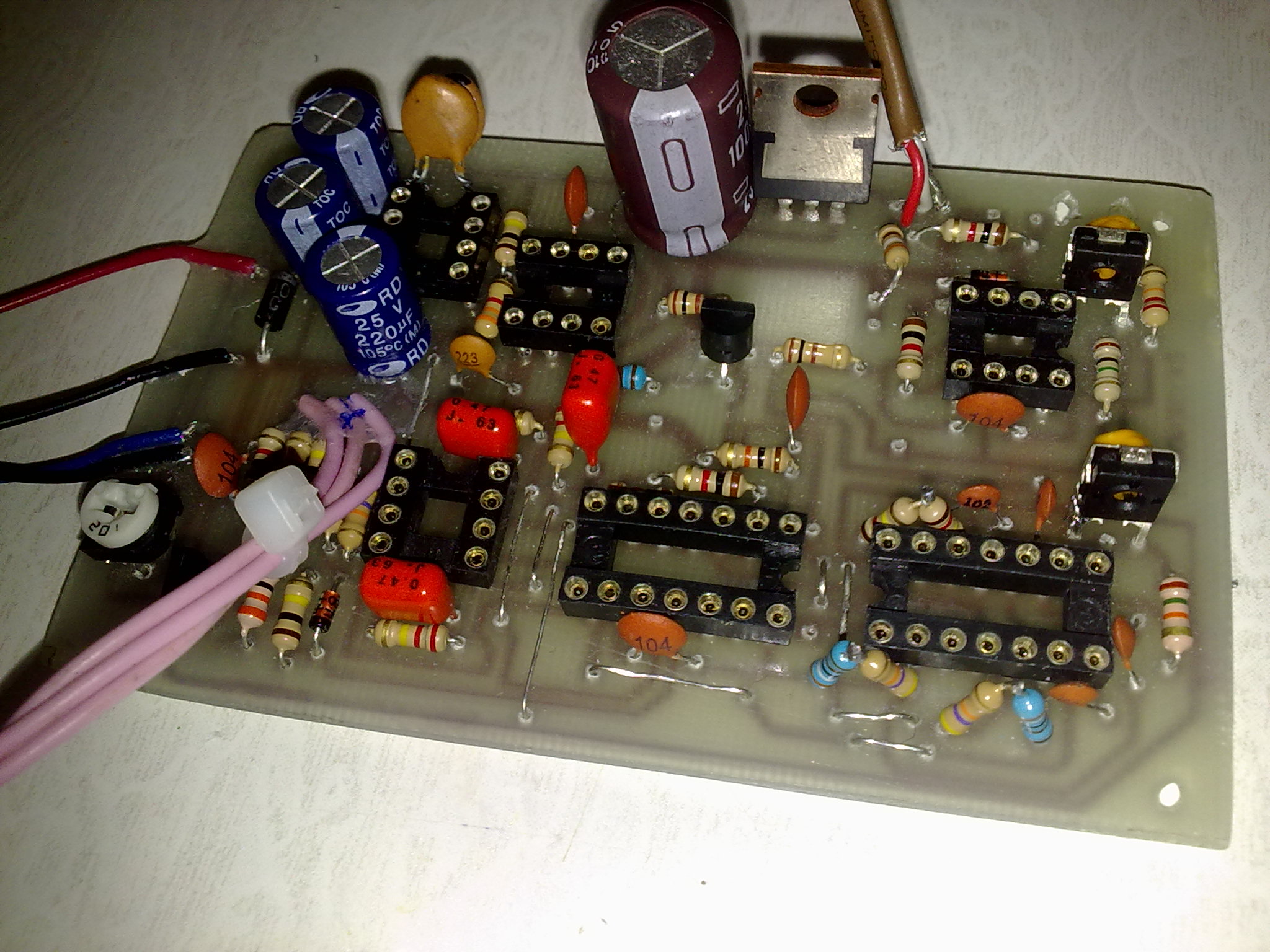

          Sounds like you may have a solder short. Something is loading the -5V down (up?).
          It can only provide about 10mA. Can you lift pin 5 and tie just the electrolytic cap to it and see if you get -5V? Take the headphones out for now too. Check soldering pictures from other builders to see if there is a solder short or just post several shots of yours.

                          decouples the thread that photo. if there is-5V to pin5 is a short somewhere.
                          • #43
                            Hi cristi71
                            i separated the thread that you show on your photo and with removed coil, 390ohm and hedphone and all ics except 7660 and test again the pin 5 it was +0.9v.
                            waster of current is 19mA now.
                            i ordered a new 7660 but it dont arrived to me yet.

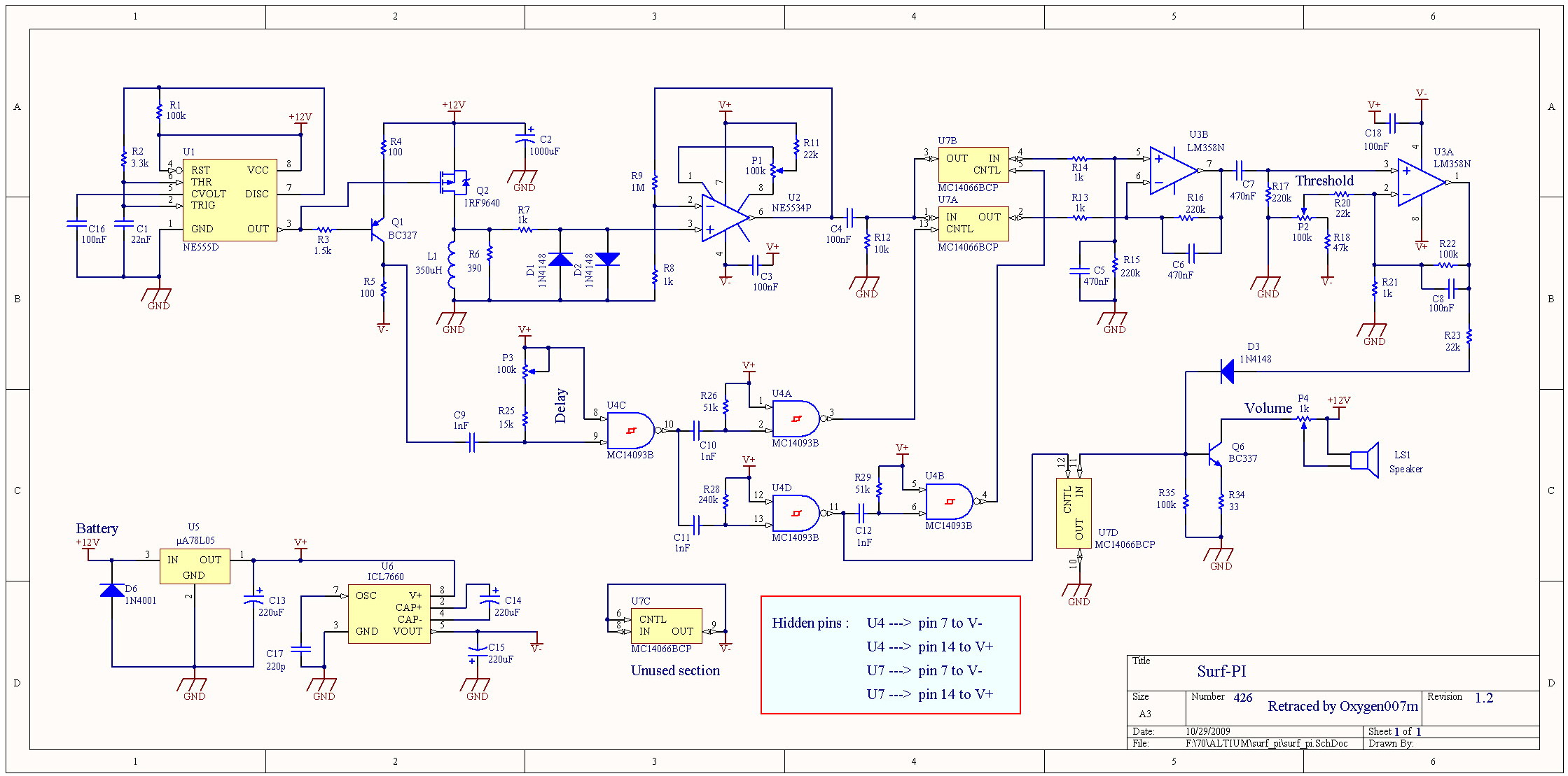

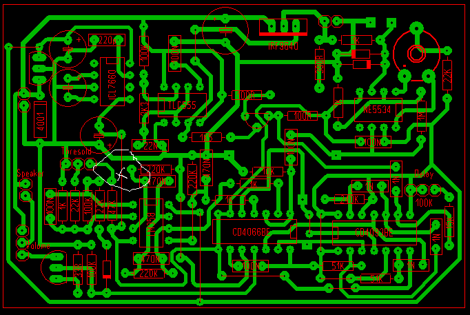

                              one question:
                              what is the correct shematic that i must follow it to solve my problem? please if any one heve it, upload here.
                              with many thanks
                              silver
                              • #45
                                surf pi
                                probably this schematic
                                can you post picture of board around 78l05, and picture of bottom of board ?
