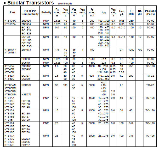

      i today buy all components that volksturm sm+gb need but cant find transistors!!! this component are very very extinct in my country, so can i use any other transistor instead: BC146 , 2N4923 , 2N4920

        Can you please clarify? Are the transistors above the ones that you cannot get or the ones that you would like to use?
        Do you mean what transistors can be substituted for BC146 , 2N4923 , 2N4920?
        I had substituted the western equivalents (above) for the original Russian components so
        that is how I got them. Where are you located? Maybe we can figure it out from there if you cannot place an international order.

              yes i connot get the bc146 , 2n4920 , 2n4923.

                  I still cannot help you because I don't know where you live.
                  Maybe do an internet search from the original components?
                  http://matthieu.benoit.free.fr/cross/russian_equiv.htm

                    Hi silver
                    i cannot get those transistor too but i get thistransistors that i thing those are ok but i am not sure yet;
                    KT816 = BD238
                    KT817 = BD237
                    KT315 = 2N2222 ( BC146 is an old type and is extinct in my country)
                    to dear Don
                    wath is your opinion; we can use those transistors?

                      I would be careful about what you substitute for the KT816 and KT817. Looks like the BD238 and BD237 have twice the current rating over what I used, so probably ok. KT315 - > 2n2222 is probably less critical.
