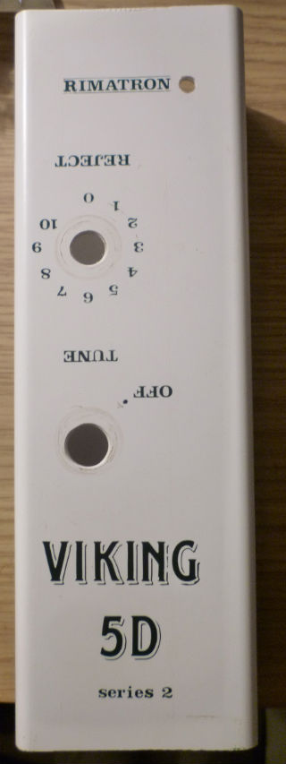

    Hi

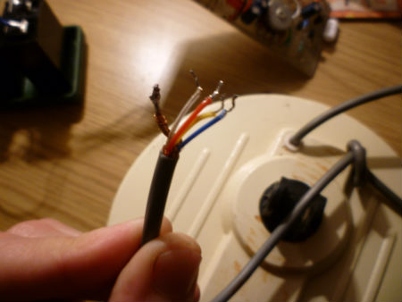

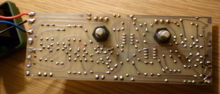

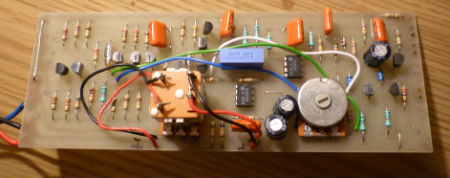

    I picked up a Viking 5D series 2 made by Rimatron and it's been taken apart. I have most of the bits, Coil battery holder speaker case ect its just the coil and speaker are not solder to the pcb anymore and I'm not 100% sure how to work out what goes where. So if anyone has a schematic of the Viking 5D series 2 or even better a photo they can give me. Any info on where to start It would be a real help.
    I can post photos of what I have and maybe some one could work it out the circuit board seems pretty basic.

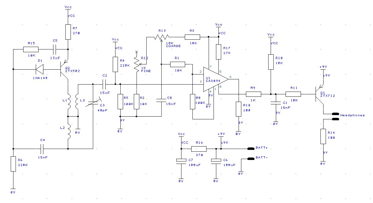

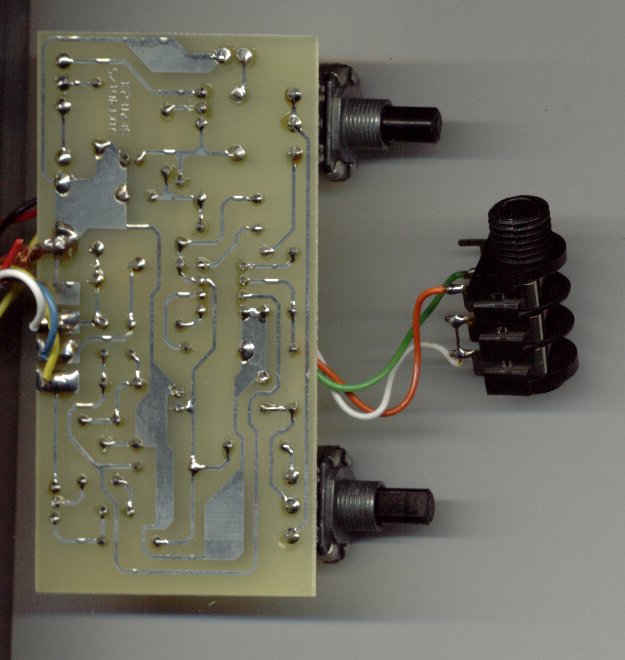

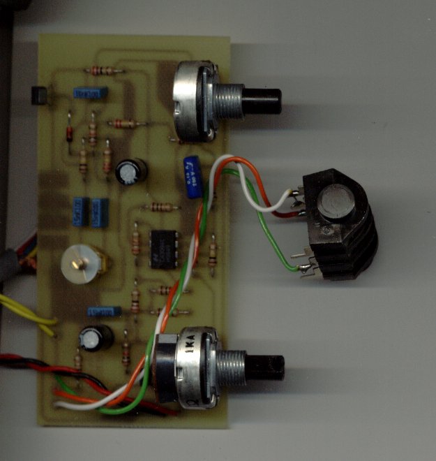

    Here's a couple of photos of my Viking 5 Series 2, that I took before I sold it, plus a schematic.
    Hope this helps.
      Hi
      Thanks for your replay I already found your post using the forum search But my pcb/ case dose not match the one in the photo. Even when I google it I can seem to find one that it matches it.

        Sorry, I don't have that one. CScope have really confused things with their model names / numbers. I've noticed that the designs, which originated from Rimatron, always have a "D" at the end.
