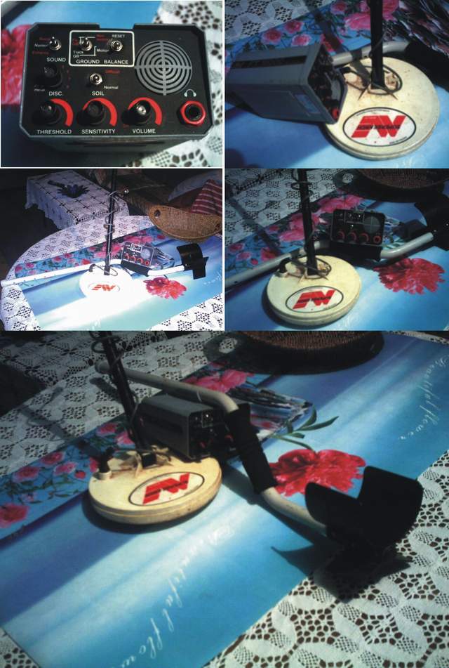

        I just wanted to start new topic, than i saw that it already exist!
        Yes, i had it for cuple months and than exchanged it with one friend, for something else.
        It is possible that i will return it again in future.
        It is "collector" - FT16000, skips nothing in soil.
        Really sensitive and extra calm on heavy mineralized soil.
        Can pick even smallest coin or grain in soil.
        Only drawback is not so stiff and good discrimination, but than again; it was made for nugget hunting - not for "discriminative" targets.
        Could use a bit larger coil, although this one is also nice.

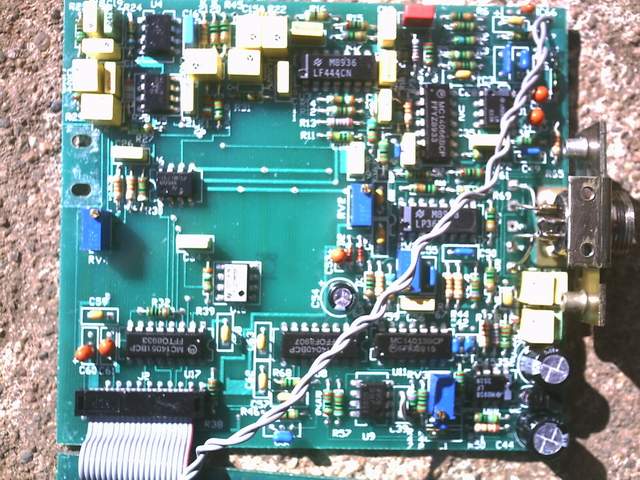

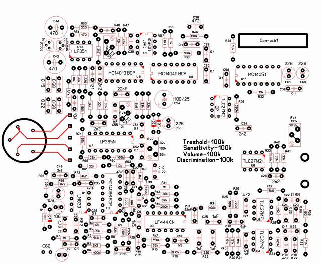

        I only made raw sketches of components placements, sort of reminder, if need.
          second one...

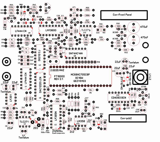

                          Minelab FT1600 and Gt16000
                          Hello guys since this topic is still not very old I will add one really
                          crucial part to it.Have you realized that the FT16000 is one off from the rest of the MINELABS worth it's weight in Gold.For the unknown
                          reason that is has and it shows all the I.C numbers and there are not blank out or painted or silicon over them like all the other models.Where they try to hide or protect the patent of the main
                          components I.C'S I think some of you will be going Uh that's right.
                          First Minelab Goldseeker 15000 most blank out follow by the GT
                          a few showing most covered in paint or coded.Next Ft16000 maybe
                          by mistake or place of production,slipped out like a normal
                          appliance with all the data numbers.Following FT16000 back to normal mystery numbers.On top of that they are very hard to repair
                          with the delicate circuit board tracks.And there is alot of them not working out there.One weakness on the Gt is the Tantalum 20uf
                          capacitor that seems to go crack and split with time and moisture
                          with climate or not usage.The FT removed that capacitor next to the St100 transistors but then the transistors seem to go too.
                          Regarding those transistors I can't find any data on them other then
                          they are Mosfet with Drain Gate and Source acting as a switch maybe because they are sensitive to Static or High electricity.I have an Ft16000 that someone repaired or tried to fix before and they replaced the ST100 transistors but made a mess of the circuit tracks
                          and used the legs of transistors to join contacts.It's not working or detecting properly,with a constant uncontrollable threshold in all
                          metal mode.Maybe they are gone again since repaired was done.
                          But it will be a nightmare to replace them with the previous work
                          done.I'm thinking because the near CD4093 I.C was also replaced
                          maybe try that one first.Anyway before this gets to long I'll wait
                          for any comments opinion or guidance help on Data with the St100 or replacement equivalents I think a 2N7000 will do but
                          would like to make sure.
                            Hi Conan
                            Concerning the replacement of the ST100 fet. A BS170 is almost identical. A 2N7000 will work but the D and S pins are reversed. See data sheet for pin out. I have used both of these on Sovereign repairs.

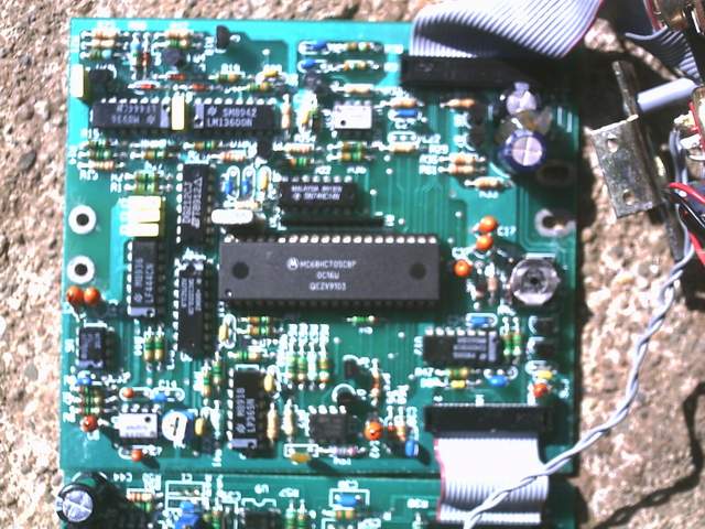

                              Position of I.C's
                              second one...
                              Really good work to have and photo copy in case I.C numbers are not there to fix and repair.BUT it could be misleading for a person.It just needs to be emphasize that some I.C's go upside down or sideways.Like example the CD4093 Mounts with the numbers upside down.And thank you ALTRA for the spot on equivalent on the ST100 Transistors found them in RS Components BS170 for only $1.20 for a pack of ten.
                              What was the problem before changing them and was the CD4093 next to them O.K. Thanks for your help
