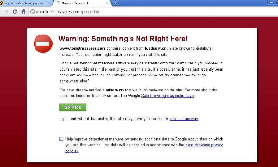

      this url http://www.tomstreasures.com/probe.html just sent my antivirus in a spin ?

        this is the page i get when visiting this url
          The link displays perfectly with Firefox using Linux.
          Also ... with Explorer in Windoze, AVG says: "Safe: This page contains no active threats".
          What anti-virus software are you using?
            i'm using chrome.my isp provides me with anti-virus derivative of avg ??
              Maybe you should download the free AVG version and use that instead.
                just tried and the same thing happens .have a look at this url
                  No Problems here, using Firefox with NoScript Addon.
                  The Script from adserv.cn got blocked by default, and its not needed anyway.
                    thanks for that
