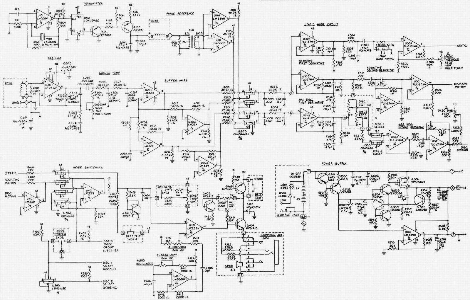

    Have just purchased one of these in a "butchered" state.
    All components on both boards are clean and there aren't any signs of having been/removed replaced. However, all the controls have been rewired wrong.
    Some of them are broken and the leads from ribbon connector are hanging loose or no connected at all. Even the battery connectors are missing so needless to say it is
    in a non working condition.
    I really need a clear circuit diagram to be able to sort this mess out and I know
    some of you have these. Can anyone please be kind enough to let me have a copy?
    I will be most obliged.

    Try this -> http://www.geotech1.com/forums/showp...3&postcount=62
      FISHER 1265X METAL DETECTOR

            Hello . It is actually a discontinued VPO104n3 P-channel FET . So NTE326 should work . Look at the pdf data folder and also a nice clear schematic from this forum already !! Other opinions are welcome .
            Best Regards...........Eugene

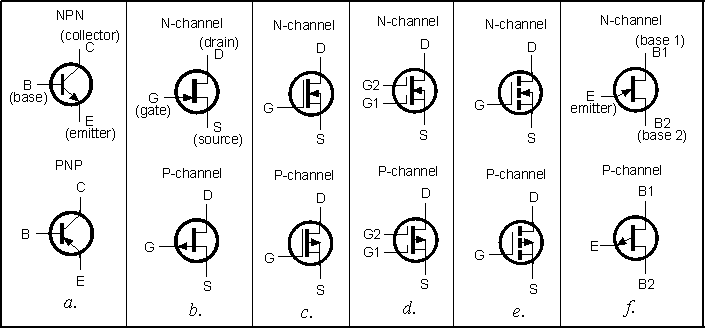

                I have found a replacement FET for the VP104ne used on this detector. However, it does not work and think I might have connected it wrong?
                From the pin out data I have obtained, the NTE326 shows a sequence of S-D-G for the pins; Source going to the positive rail of the circuit. The VP104, as fitted, has Source to + but the centre pin is the Gate, the Drain being the outer pin as opposed to above.
                Am I right or wrong?

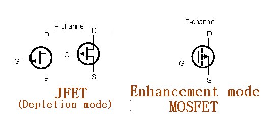

                    Bad news:
                    The VP104N3 is enhancemode mode MOSFET. NTE326 and 2N5460 are depletion mode JFET. These are different function devices and are not interchangeable.
                    Depletion mode devices are normally ON with zero volts input and get turned OFF with a voltage lower than the source pin (using absolute numbers). Enhancement mode devices are normally OFF with zero volts input and get turned on with a voltage higher than the source pin (using absolute numbers), more like a BJT transistor.
                    I say "absolute numbers" because when describing P-channel operation, negative numbers are normally used. That can get ambiguous and confusing.
                    VP0106
                    VP0109
                    TP0606
                    These are all P-channel enhancement devices and should all work to one degree or another but I am not prepared to say which one would work best. Leaded devices (through hole) are getting harder and harder to find with the advent of SMT.
                    Supertex, NXP, and Vishay are good sources for information (and parts, depending on your location).
                    Don't guess. Check the pinout (and function) on a manufacturer's data sheet before installing a replacement.

                        Yes it is an enhancement mode mosfet . VP1008L . Same as used on 1280x [see parts list] . Here is the correct data sheet pdf below . I am still looking for correct substitution . Always a work in progress until it is fixed .
                        Best Regards........Eugene
                          I used to think that this 1265 power supply was sucky because LTspice showed poor load regulation. That was my mistake.
                          I've corrected my errors and repaired the simulation circuit and have to say it looks great. No joke.
                          You can have near perfectly symmetrical, well regulated 4V outputs even as the battery drops to 8V. After that the rails droop symmetrically.
                          Of course my version is only a simulation, but it's good. Maybe that's why Fisher went to the trouble of developing such a complicated circuit, and not just because they had extra parts lying around... big boss walks in and says, "we have extra parts lying around. Somebody needs to use them".
                          BUT
                          if you don't use the prescribed enhancement MOSFET for Q506 (or a reasonable substitute) and instead use a JFET, although you might have power it will not be the same. For that matter you could use a jumper for Q506 to save trouble and $$$. That's my two cents.
                          edit: In all honesty I did make some minor adjustments in the power circuit before I got it working 'freakin' good. I did it through empirical means; trial and error. I am hardly qualified to modify the circuit because I do not understand how it works.
                          I removed the comparator pull-up resistor ( R508 ) and installed another capacitor alongside C501, connected to +4V. I don't know if these mods would be so very great in real life, but they look good on my PC.
                          edit 2: That's not all. I also relabeled +4V 'ground', and ground became -4V (which wouldn't make it work any better but it does makes it easier for me to detect asymmetry, or operational anomalies).
