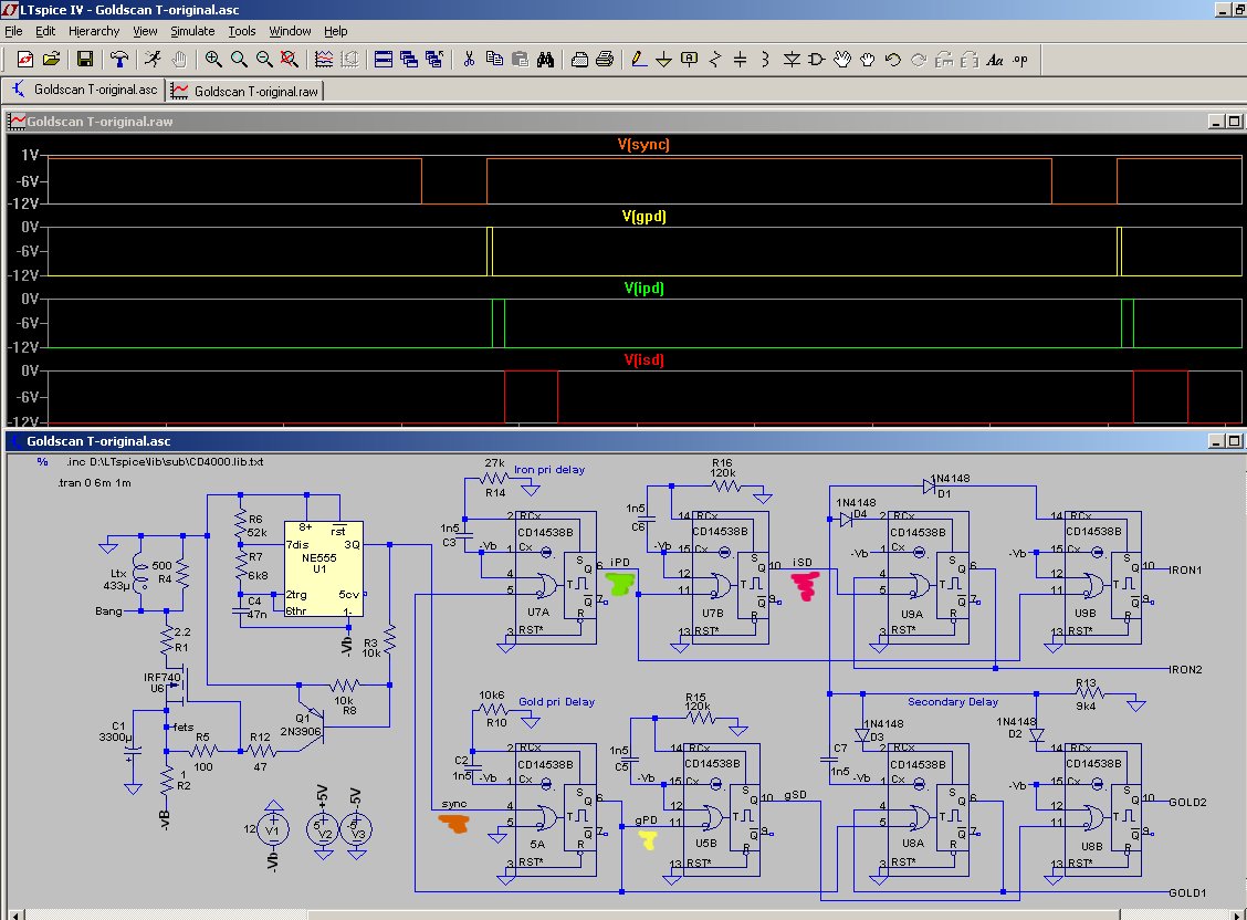

    i have a problem 4538 IC , GOLDSCAN IV , U7 input pin 5 only one pulse input but output pin 6-11 and pin10 has double pulses out. Is this my pcb error or there are right pulses at output ?

        You should have a single output pulse at U7-6 for each input pulse on U7-5.

          GS4 is begin the work 50% with these double pulses. first i have to solve this pulse problem. I read the Baracuda update and Geo problem was same about the pulses.
          Sample pulse not begin after end of the main pulse then other 4538 make it double. connections all ok. i changed all 4538 in stead of new IC.
            This picture U5 pin6 output pulse and 5534 pin6, sample pulse is not end of the main pulse.

                  i prepared new pulse maker board with 4 CD4538 IC, this is better , i can adjust all pulse width and delay times.
                  Each sample pulse width 50µs adjusted. i don't know real what it was.
                  555 output main pulse width is 545µs minimum, current drain really much this MD.
                  Only working SEL1 and ALL metal mode. These modes are using gold channel (SW1-A GND pot).
                  SW1-A directly gold channel without GND pot (SEL2) not working, constant bip sound.
                    lt spice unrelated to the original pattern of goldskan4

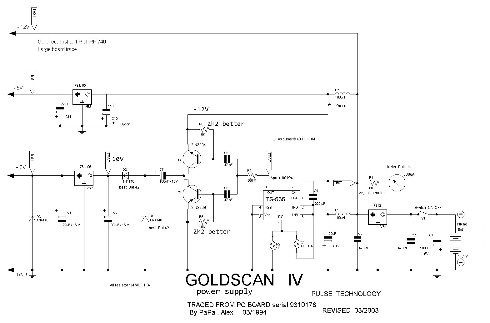

                          Hello guys I need help because I'm not able to have the voltage of +5 volts, can someone help me ... thank you.
                          goldscan IV
                            Well, what do you have? You have not told us anything.
                            You should have about 10V going into the 78L05.
                            If you don't, then make sure the diodes D1 and D2 are good and properly oriented. Same goes for the transistors T1, T2.
                            The circuit looks funny around the transistors but it works good the way it is drawn.
                            Notice there are some recommendations for changing 10k resistors to 2k2 and changing 1N4148 to BAT84 but those are not important and if you have good parts
                            and everything is properly oriented the +5 power supply should work.
