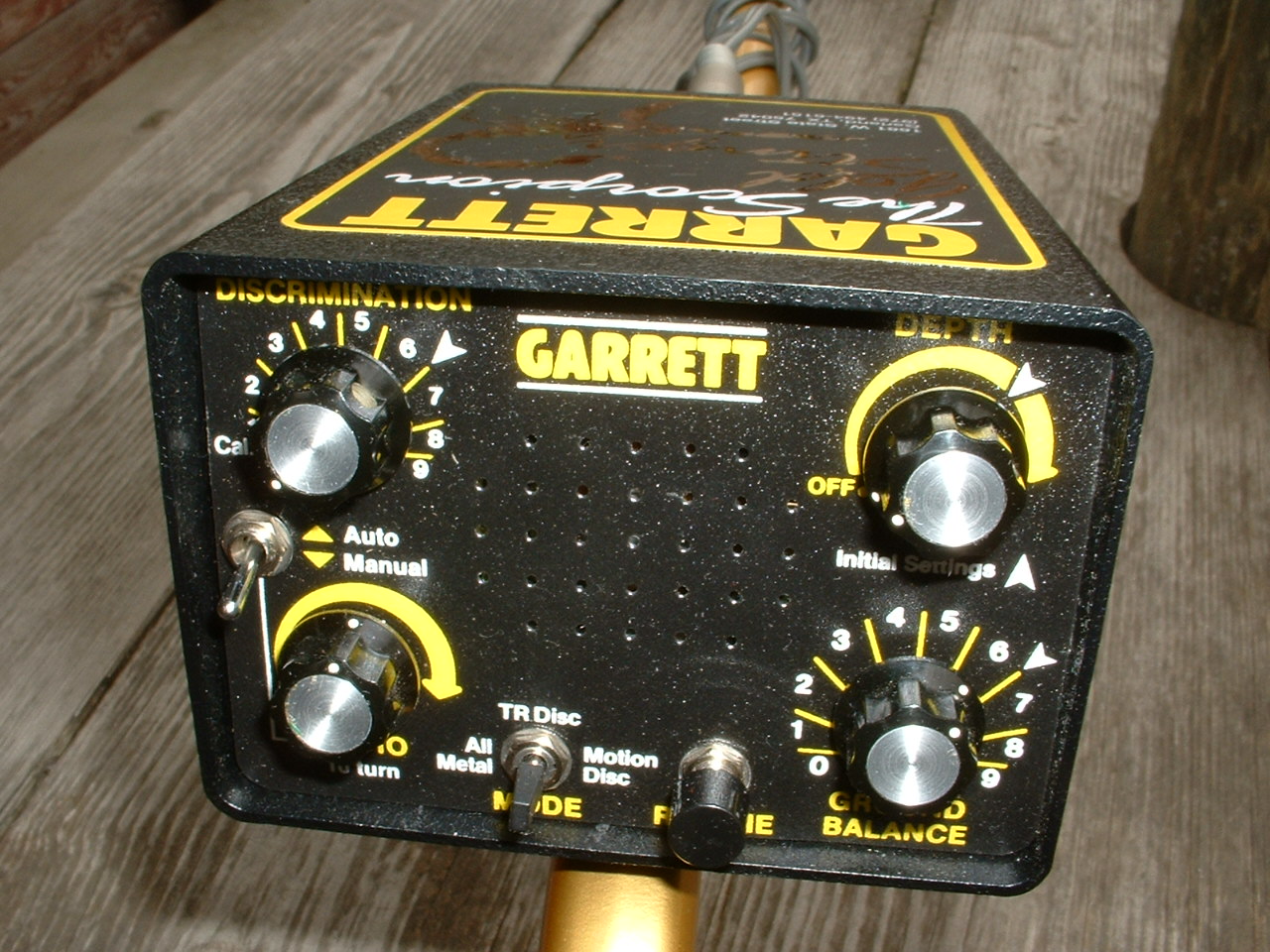

Could anyone make some photos from inside for this detector, please ?
Garrett Scorpion Gold Stinger

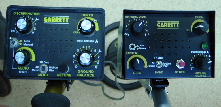

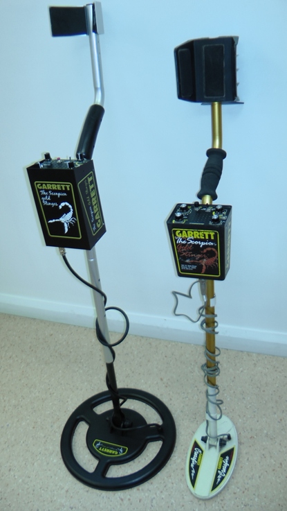

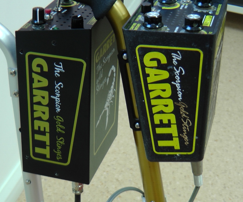

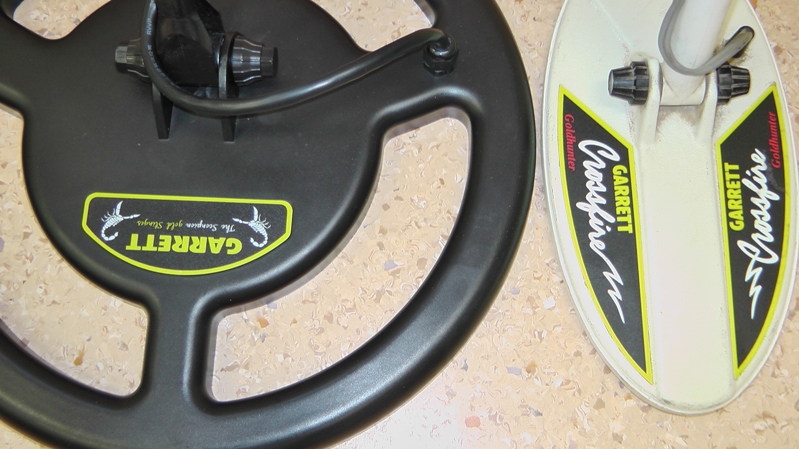

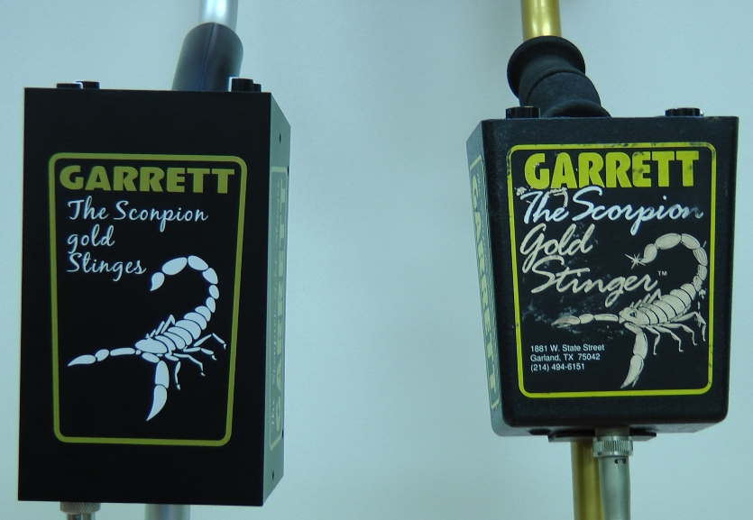

Compare the pare – Garrett Scorpion imitation.
There is a legend about Asian metal detectors being a copy of western one.
Yet I was not able to spot it on net so I went out to find any. It is not easy to find MD in this big place – they do not sell it in regular shops but in sort of warehouses. Yes they have many westerns detectors to offer but they are original and priced x 3 what we can buy in the west. ( OKM, MINELAB, GARRET , NEXUS, GPRs – they just handing to me via the door from next room. They have about 5 original models but no copies.
Then disappointed I have visited electronic parts outlets and bingo !!!
I have got it for “foreigner” price $120, not copy but imitation of GARRETT ?
It sells with 12V battery and charger and it has Garrett appearance only – the rest is original engineering and it works. Have a fan to look.

Hi, I am back heome, but the first test on Australian coins was fantastic - it could not see any but all local coins picked all the time. Then I have checked it on my translators cat grave - the cat was bured 2 years ago with silver plated chain about 0.5 m under and no problem to detect. More testing later ...
