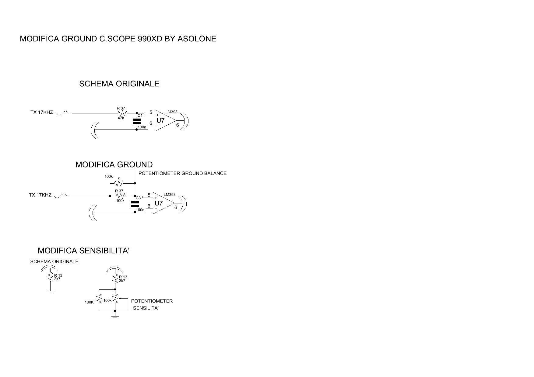

for changing the sensitivity I have copied from the 1220b to the modification of the ground is my own invention, the metal part of the potentiometer is connected to the virtual ground to limit the noise, I added a third change, a low pass filter on every channel all metals as present in the scheme of 1220b.Originally posted by TH Jim View PostHi Asolone,

The modification serves to decrease the sensitivity of the channel gain all metals,
potentiometer to the maximum amplification is the original,ruotand the potentiometer to its maximum resistance value decreases the gain of the circuit , you get a better threshold that is more stable and the sound of the channel vco is much cleaner and improves performance on small objects like coins and deep and medals, also in the midst of many signals is easier to distinguish sounds good.

Both are good , 1220r is good for coins, 1220xd is good for militaria, 1220xd 1220r-1220b-go deeper,has a fixed adjustment of the audio level of discrimination , while the 990 is adjustable, I prefer the 990xd for the opportunity to adjust the discrimination audio vco.Originally posted by pelanj View PostAnd how about the today's 1220R or XD? Are there some other good non-motion machines? Is there some physical limitation in depth compared to the motion machines? I am seriously considering getting one, as I have used a Whites 3900 and a Viking 5. I liked the way they operated, but the sensitivity and depth were not great.

these metal detectors are not suitable for research on mineralized ground like beach or volcanic soils, with the modification improves performance. I modification10 c.scope 990xd of friends and everyone was congratulating me.
many people do not like metal detectors no motion, I love them, depending on the sound emitting I know what's in the ground
you have to use headphones, and move slow with the search coil for optimal performance
the sensitivity is equal with 0 ohm potentiometer and decreases by increasing the value of the potentiometer, the result is better stability of the threshold , vco signal is much cleanerOriginally posted by Eugen View PostHi Asolone!

I only use it to audio disc meter, I jumpered the selectorsOriginally posted by Eugen View PostHello Asolone!
