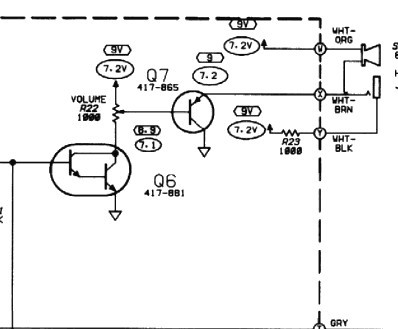

I have successfully modified.I added a PNP transistor
SURF PI can increase the speaker
Yhl, if you use 8 ohm speaker and the same battery, your modification is not successfull because the additional circuit increases battery drain and creates interference by supply rails. To avoid interference, you should use separate battery. The resistance of speaker should be more than 8 ohm.Originally posted by yhl View PostI have successfully modified.I added a PNP transistor

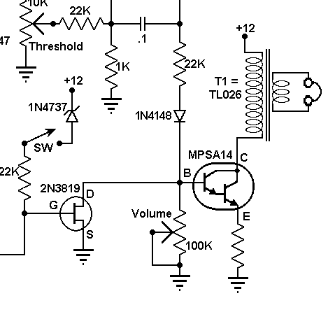

This Modification gives Very Good Results.
The Transformer is Very Small, only about 0.5 inch square.Attached Files

A Ferrite Core Transformer is better for HIGHER Frequencies, Not usually good for Audio.Originally posted by Davor View PostI was considering calculating a ferrite core transformer for this purpose, but I'm afraid it will be a nasty one. Quite difficult reaching a non-saturation range for the primary.
Although you could do one on a Small POT CORE.
The TL026 Transformer I Specified is small and quite easily obtained.
However a TL001, TL003, TL008 or a TL013 should also work quite good.
I could Mail you a New one, but the postage is more than the transformer.Originally posted by Davor View PostYes, I have a small bag full of ferrite pot cores, but as you say, not optimal for audio. They can be ruined if allowed to saturate, and that's bad.
