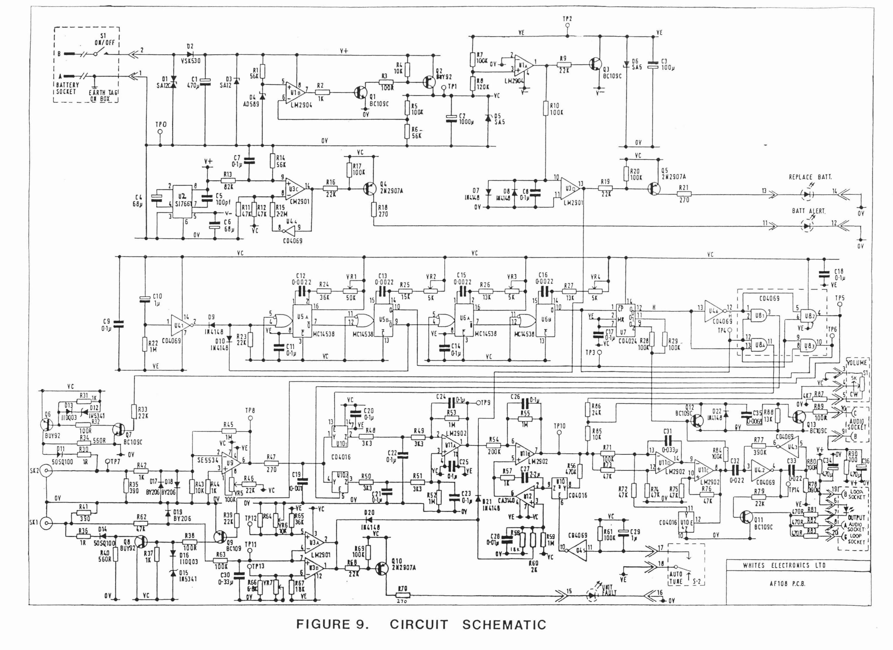

      Now I have to find which pot adjust the sample delay time I think.Im going to be looking at that schematic for a while.I think I will have big one printed at kinkos.Thanks a million Carl.
      The signal driving the TX output stage can be monitored at TP5.
      U6A and U6B are dual monostable multivibrators used to generate the main and secondary sample pulses. Without looking too closely, I think the pots are as follows:
      VR1 = main sample delay
      VR2 = main sample pulse width
      VR3 = secondary sample delay
      VR4 = secondary sample pulse width

        I have alot to learn about pi circuitry,thanksfor your help. If I connected the coil terminal to a scope I would only see the transmit pulse correct? I will have to pick up the sample pulse on another channel to actually see the sample pulse delay time on the screen,correct me if I am wrong.Secondary sample delay sounds new to me,since its bipolar I wonder if it samples on the positive and negative pulses?
          Yes, you will need a 2-channel scope to see the main sample delay relative to the TX pulse.
          Have a look at the Hammerhead article here -> http://www.geotech1.com/cgi-bin/page...head/index.dat
          It uses a similar arrangement for producing the main and secondary pulses. The secondary pulse is used to eliminate any signal from the Earth's magnetic field. In the AF106, U11a appears to be a differential integrator that amplifies the difference between the two samples.
