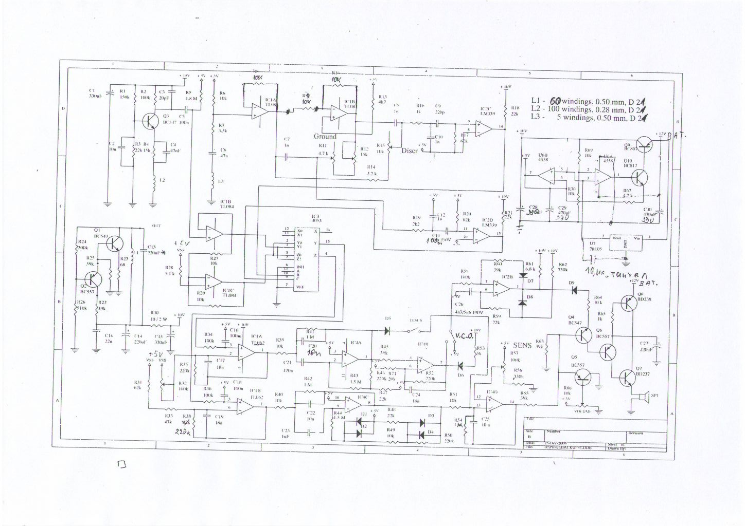

Golden Mask Schematic
  • #91

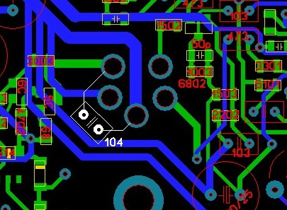

    When there is no help from others... than there is only one way to go:
    [ATTACH]35242[/ATTACH]
    [ATTACH]35243[/ATTACH]
    Maybe you can remove letter "o" from second picture. I have two 7khz gm coils and i would like to use them with admiral circuit. Just to see how tx and rx is connected to 5pin ham-connector...

              will You, please, tell me what this L3 supposed to be?
              • #97
                Originally posted by cvele View Post
                Hi Ivconic[ATTACH]37180[/ATTACH]
                Concentric coil ????
                Used to balance the coil ????
                Would have been my guess but doesn't look to be wired like one
                • #98
                  L3 provides a signal used to generate the two phase shifted Ground and Disc reference signals fed to IC3. I think Ivconic described this in a post somewhere but I can't now find it.
                    Yes. At "Magnum on steroids" topic.
                    Golden Mask coils are having similar morphology.
                    Additional windings are added on TX coil and connected to sync demodulator.
