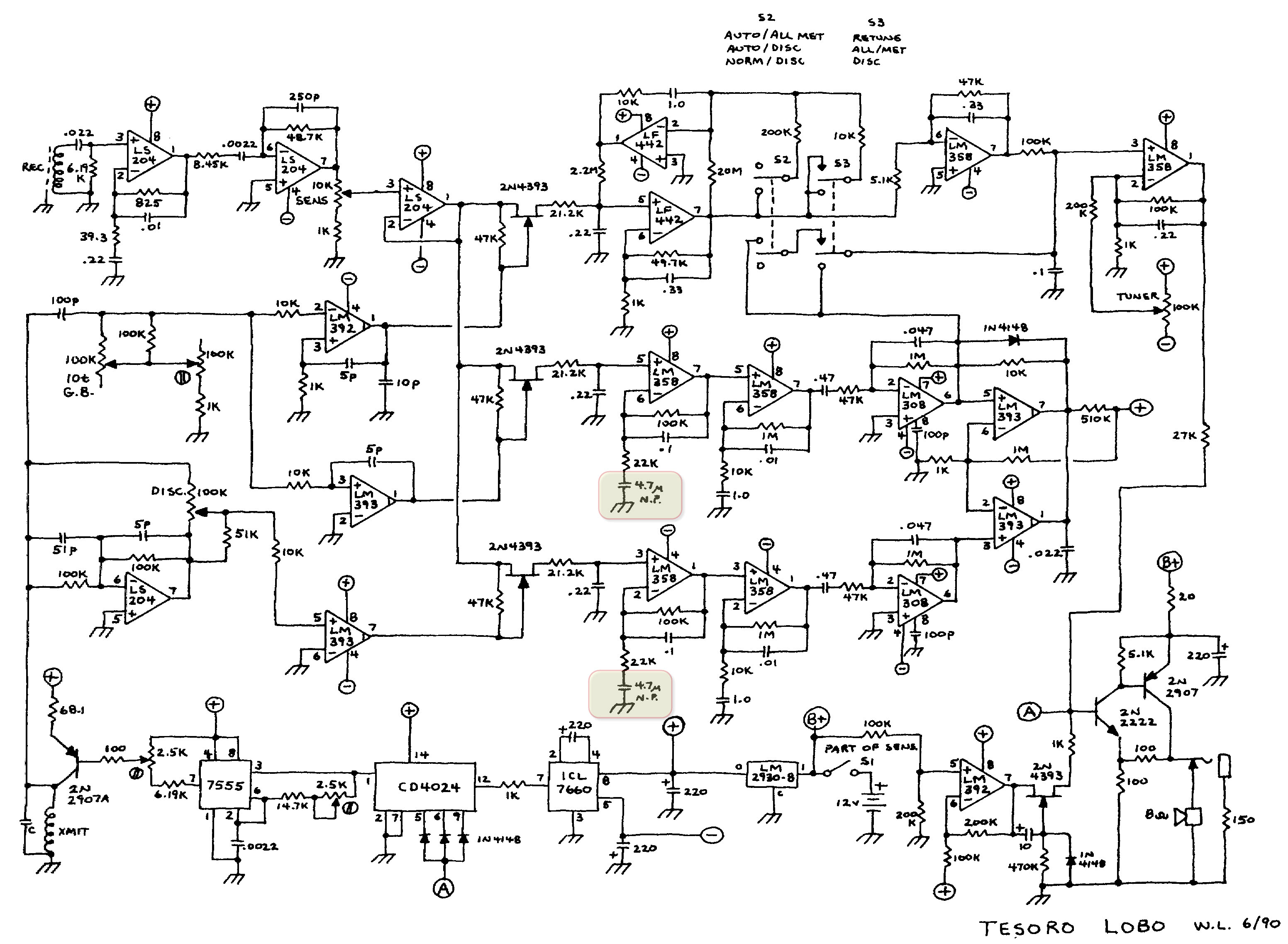

                • Lobo it's ok...BIG MACHINE
                  The schématic foma has little error but after correction all it's ok. It is possible to improve dicrimination
                  thank you legaucho et ametech. the package lobo.rar 17Mb is verry useful.
                  correction:
                  adding 51k on dicri. (not present on schemati foma) and 82k for R10 (see rar file)
                  Futur test:
                  replace r17, r19, r20 (23.2k) by 21.2k
                  G.B has two potentiometre. 1 pot 100k on pcb and 1 pot 100k on face. (see schematic "TESORO LOBO W.L 6/90". for me it's the best schematic.
                  30cm and more on 2euro coin
                  25-27 on 20cent euro
                  discri Aluminium-GOLD very interesting
                  you can see result on youtube:
                  http://www.youtube.com/watch?v=u168T...ature=youtu.be
                          Thank you Eugene. There is the website redram give very good information and result on vidéo.
                          But all schématic of foma don't give the good connection on G.B. For the good connection G.B see scheamtic W.L 6/90
                          For my tests:
                          I improved discri with 470k on R10 (visible on a foma schematic).
                          Yes Predica 2, i work with 22nf on Rx because this coil is 28.15 mH 50.5ohm.
                          I dont want 28.15mh but after make 65tr of 0.28mm and like foma's schematic i mesured with ohmeter 50.5 ohm. After i make a essential LC meter for mesured coil and discover this value

                          • révision of my other message:
                            all schématic of foma don't give the good connection on G.B and dicri. For the good connection G.B and discri see scheamtic W.L 6/90
                            For predica 2;
                            sorry but I did not understand your message. You advise me to go down to the value of 24nf to 22nf for have -12 ° phase shift ???
                            best regards...
                            • William Lahr Schematic.
                              • acording to this schematic
                                with RX 10mh-22n-20kh (10 kh resonance give -12 deg)
                                28mh 8.6n 20kh
