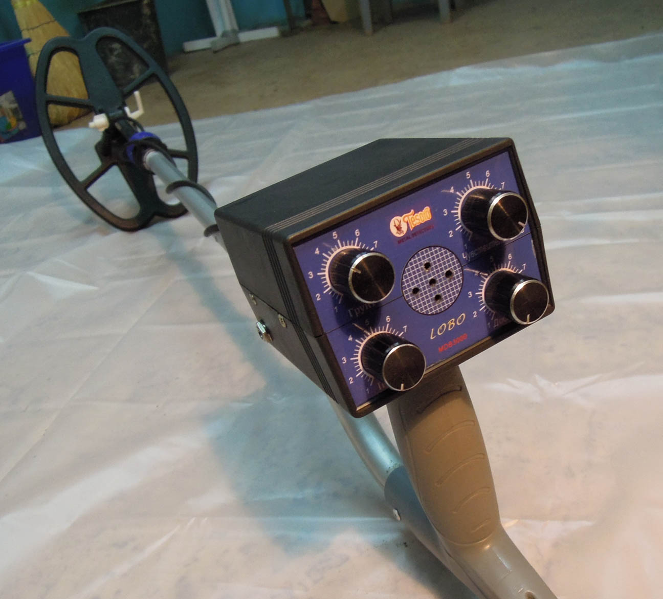

    • someone is selling Lobo. you have to get this result!

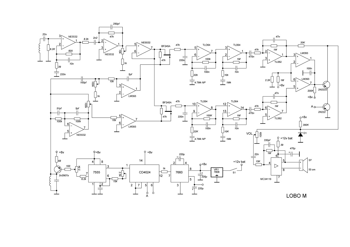

          • lobo schematic moded

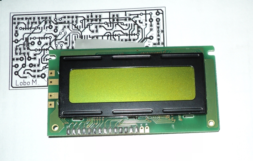

              • a layout of lobo M from vlaser.
                LOBO M.rar
                • oh yes
                  the lobo m layout is really good
                  i will get some double sided foto pcb from bungard the next days
                  so i have a good base to escape from my mother in law over christmas holidays

                            What kind of diode is D1? Same sound circuit is used in "verator 3" and "thunder 7".
                            • LOBO M.LAY6, IC 7555 pins 3 and 6 connected. I think this is not correct. Should be pin 2-->6.?
