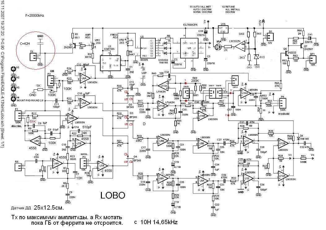

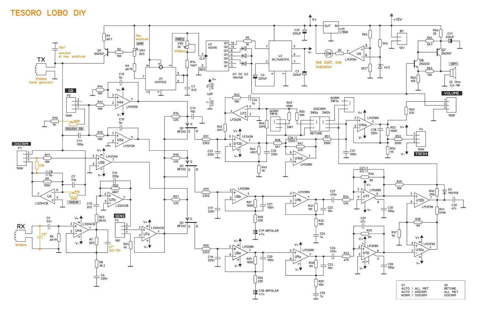

      • Please, can you publish the schematic revised correctly?
        • it was done according to this diagram, my Lobo works at 17.5kHz, C14=250pf, the RX coil should be set to 18.1kHz, I haven't done that yet, and I still need to check exactly. IC, U4B, in parallel with C9, instead of a 100K resistor, a 500K trimpot should be placed, also, on Lm392 responsible for battery monitoring, instead of 3k3, a trimpot for fine-tuning the threshold is placed. I used a probe from a Golden Mask, and it is very close to the inductance of a tesoro probe, for a device at 17.5kHz
          edit: I also had to remove R5, for some reason with it, IC7660 wouldn't workClick image for larger version  Name:	LOBO Sch.ORIGINAL.jpg Views:	0 Size:	196.0 KB ID:	415570

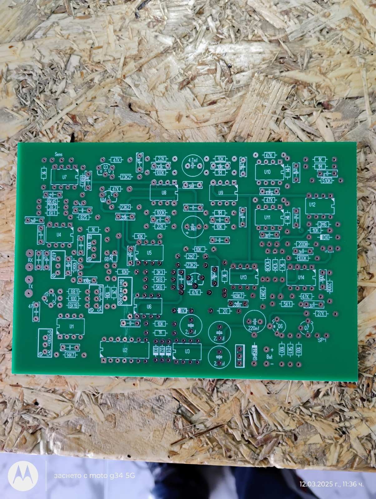

          • the easiest way is to get this pcb, and if it is identical to mine, you need to make two simple changes on the back, and the enjoyment can begin.

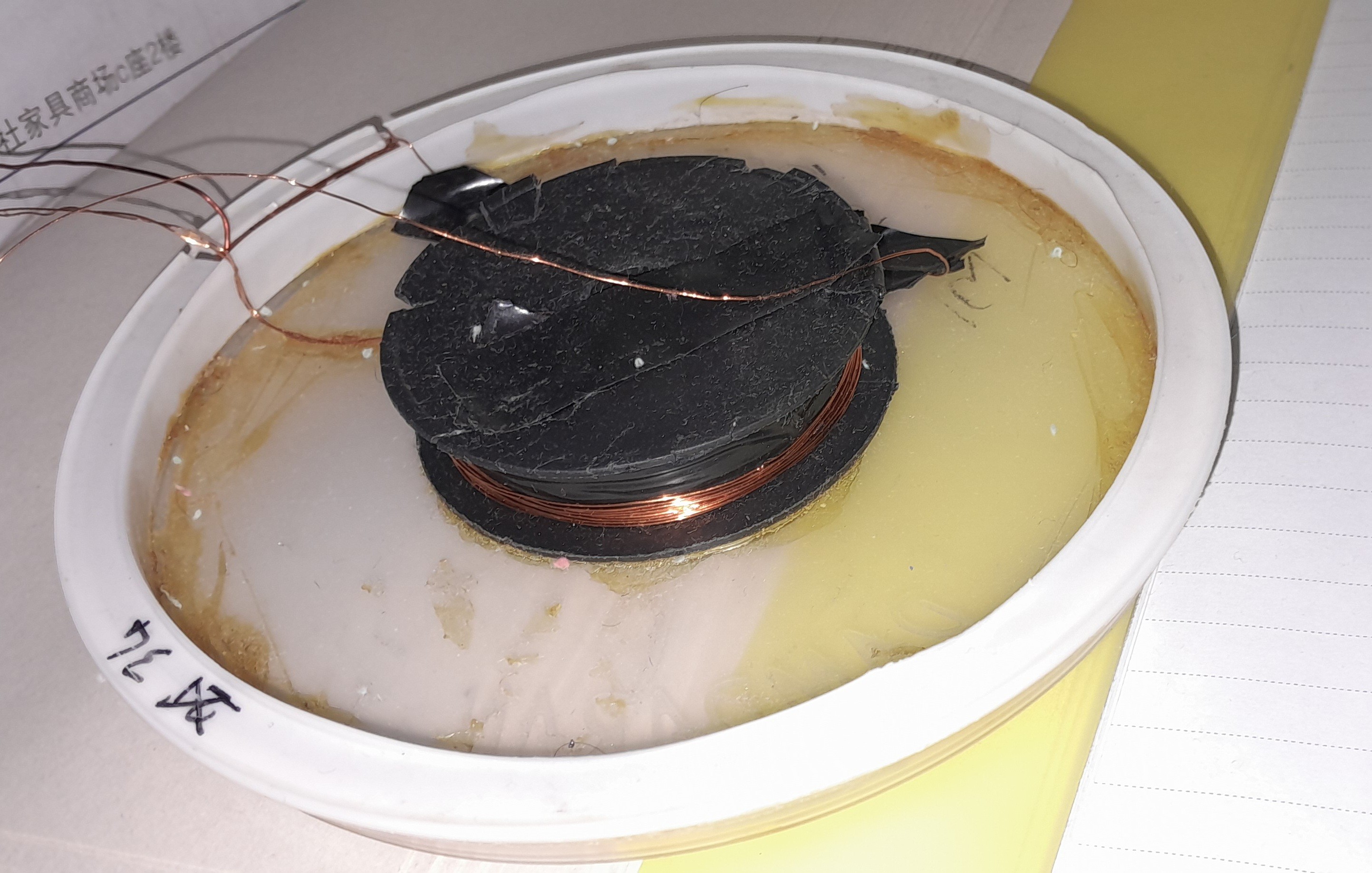

              • Originally posted by ZL17 View Post
                My Lobo is working, but there is a problem with the coil (Tx - 170 coil wire 0.2 - 47n, Rx - 65 turns with wire 0,3 - 6n8, 25 x 12.5) - can not see well in the "all metal", the "discrimination" is much better, but after adjustment potentiometer on the 30% no longer sees metals (R10 - 100K). By moving relative to each coil, I noticed that at some point the speaker is silent, and here begins widzić metals. In the most optimal point on the oscilloscope is a graph as in this picture of "my lobo" (measuring points at the exit to the coil). With a genuine Lobo noticed that the chart here is a little different (photo of "original lobo" - the second sine wave is almost flat despite the same oscilloscope settings). When I try to get a graph similar to the original in my lobo stops working properly (adjustable potentiometers on the board also does nothing). My question is whether it can change the number of turns in the coils? Thank you for all the answers.
                1. My Lobo
                [ATTACH]25623[/ATTACH]
                / 2.Oryginal Lobo
                [ATTACH]25624[/ATTACH]
                thanks for very nice photo .
                the RX voltage of orginal lobo have +90 degree phase with TX voltage!!

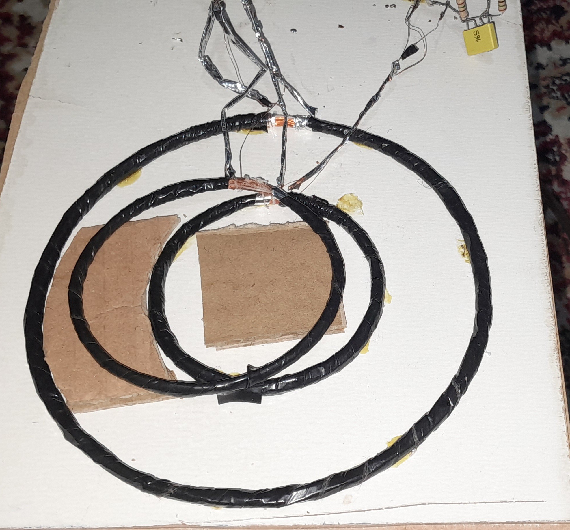

                      I made several coils, 2 of which are 5x10 DD and the 3 of 5 and 6 inch concentric.
                      I did all the tests with in All Metal mode.
                      Concentric coils are more sensitive than DD coils. But their problem is that they are not well balanced. For example, the output voltage of the receiver part does not fall below 1.5 volts when the sens is maximum, but for the DD coil, it was easily reduced to 100 millivolts.
                      So for concentric coils I have to set the SENS to half or less for the threshold sound to appear!!
                      I would totally welcome any ideas that would make the concentric coils balanced
                      coil3_6inch was the most sensitive. A small piece that is in the attached pictures from distance 5.5 to 6 cm detected by SENS on less than half!!
                      but I don't know how much it weighs and whether this amount of sensitivity is good or bad!!
                      coil4_5inch detected the same piece at 4.5-5cm with SENS on about a quarter.
                      The coils have a phase problem because I used 4558 instead of ls204 and I think the phase of the receiver is different from the original one and unfortunately I don't have a 2-channel oscilloscope to measure the phase!!

                          • Originally posted by LukaZ View Post
                            Click image for larger version  Name:	s-l500.jpg Views:	555 Size:	50.1 KB ID:	415578
                            Could you post photos of these modifications? I have everything set up and I have questions about this modification and the capacitors to use to have one working frequency or another?
                            I have the same board assembled as you.
                            • I can, why not., but in about five to seven days, when I have access to my pc, because now I'm roaming., until then, I'm interested, did your device work?, I guess it didn't, because, in my case, the connection was missing, if I remember correctly, in the part of the input stage, and one branch of the power supply was missing, I forgot exactly which one on which IC., also, it would be interesting to see a picture of your board from both sides, if there is a possibility for it.

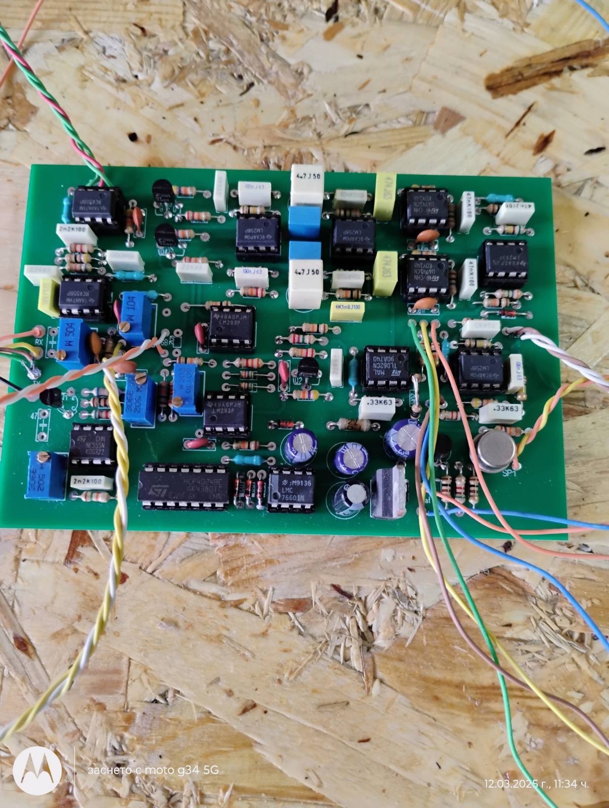

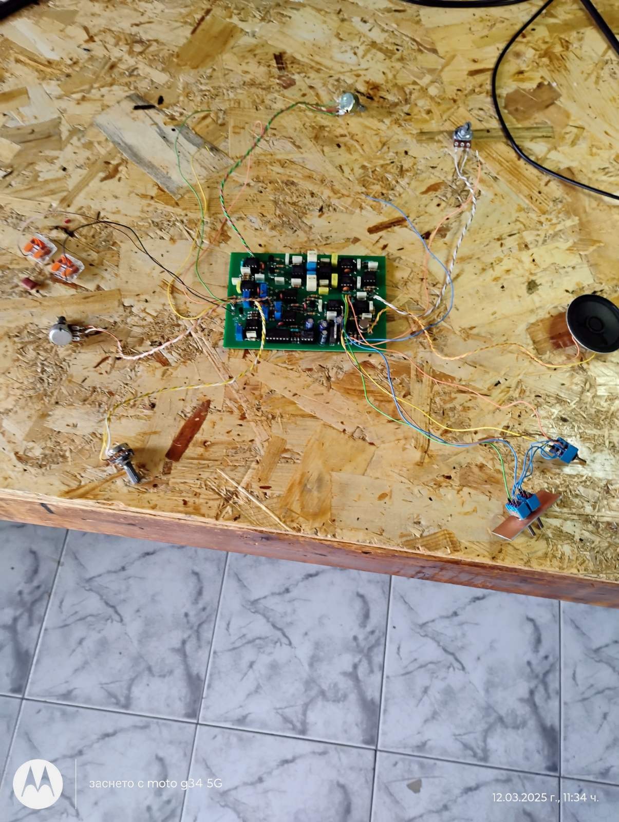

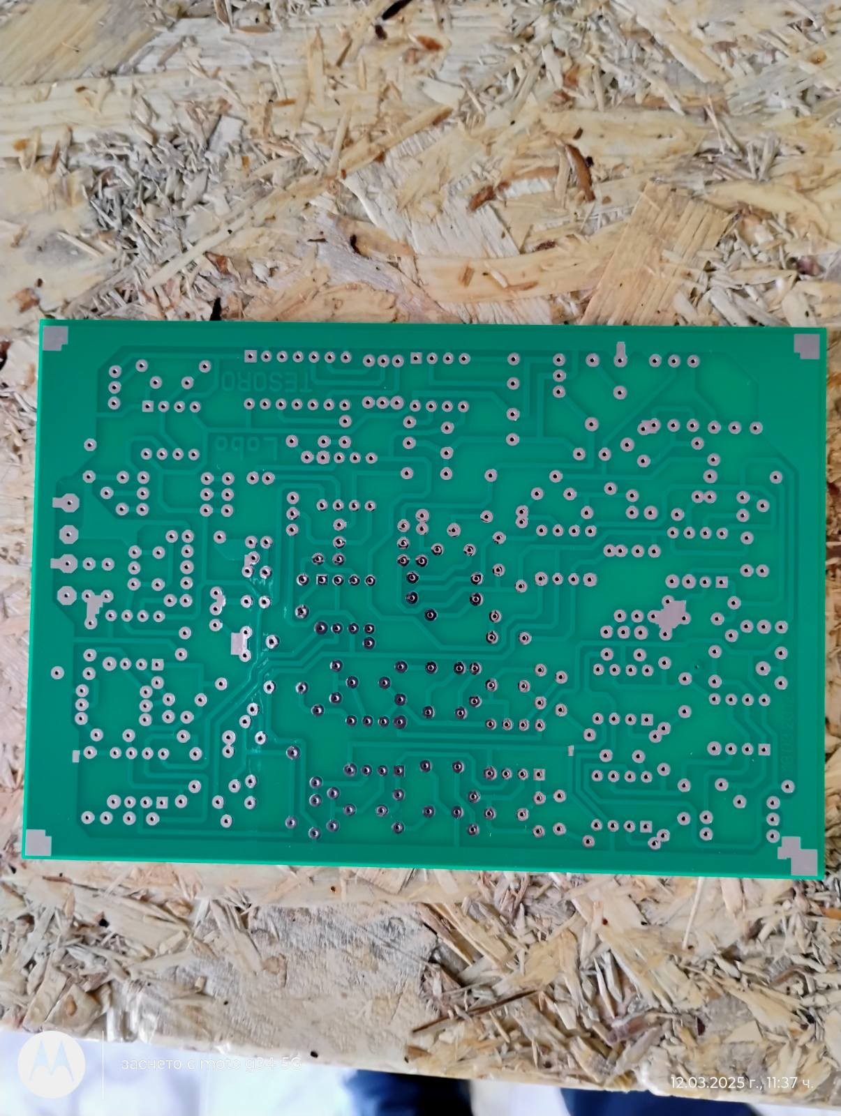

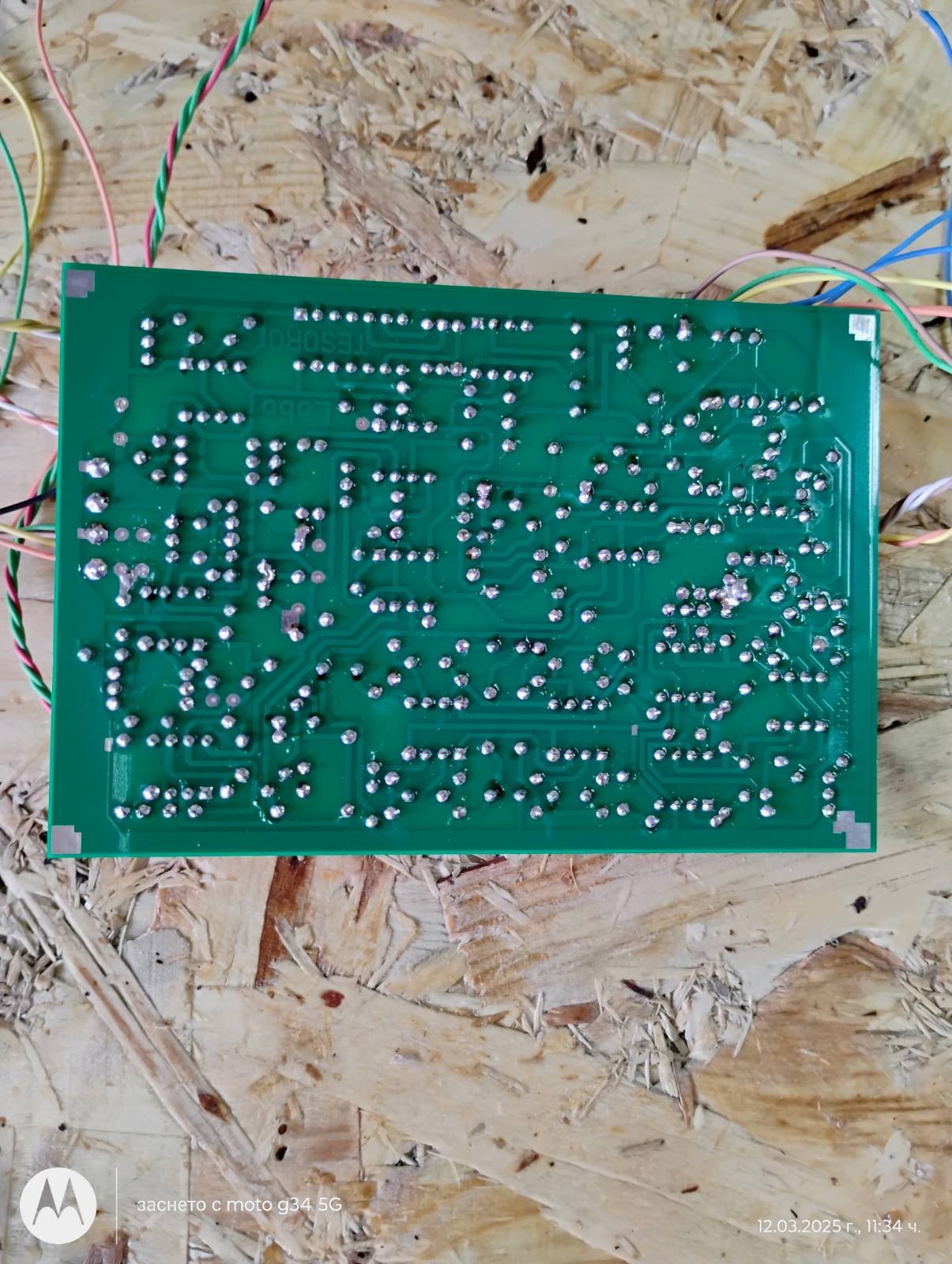

                              • Hello, it doesn't work properly for me.
                                There is a sound from the general background.
                                Click image for larger version  Name:	viber_изображение_2025-03-12_11-38-12-466.jpg Views:	0 Size:	385.9 KB ID:	435129
                                Click image for larger version  Name:	viber_изображение_2025-03-12_11-38-12-490.jpg Views:	0 Size:	367.0 KB ID:	435132
                                Click image for larger version  Name:	viber_изображение_2025-03-12_11-38-12-437.jpg Views:	0 Size:	350.5 KB ID:	435130
                                Click image for larger version  Name:	viber_изображение_2025-03-12_11-38-12-198.jpg Views:	0 Size:	442.9 KB ID:	435131
                                Click image for larger version  Name:	viber_изображение_2025-03-12_11-38-11-999.jpg Views:	0 Size:	344.9 KB ID:	435133
