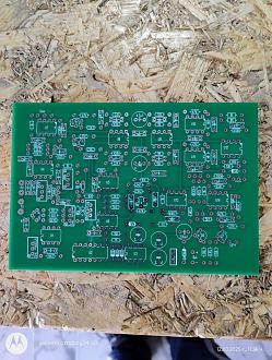

                            Could you post photos of these modifications? I have everything set up and I have questions about this modification and the capacitors to use to have one working frequency or another?
                            I have the same board assembled as you.
                            • I can, why not., but in about five to seven days, when I have access to my pc, because now I'm roaming., until then, I'm interested, did your device work?, I guess it didn't, because, in my case, the connection was missing, if I remember correctly, in the part of the input stage, and one branch of the power supply was missing, I forgot exactly which one on which IC., also, it would be interesting to see a picture of your board from both sides, if there is a possibility for it.

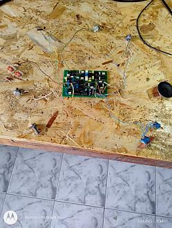

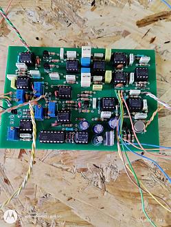

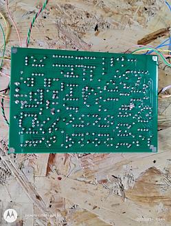

                              • Hello, it doesn't work properly for me.
                                There is a sound from the general background.
                                Click image for larger version  Name:	viber_изображение_2025-03-12_11-38-12-466.jpg Views:	0 Size:	385.9 KB ID:	435129
                                Click image for larger version  Name:	viber_изображение_2025-03-12_11-38-12-490.jpg Views:	0 Size:	367.0 KB ID:	435132
