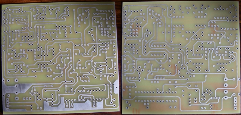

      Hello all
      My PCB is arriving from Beta-layout, I must work now.
      I will keep you inform.

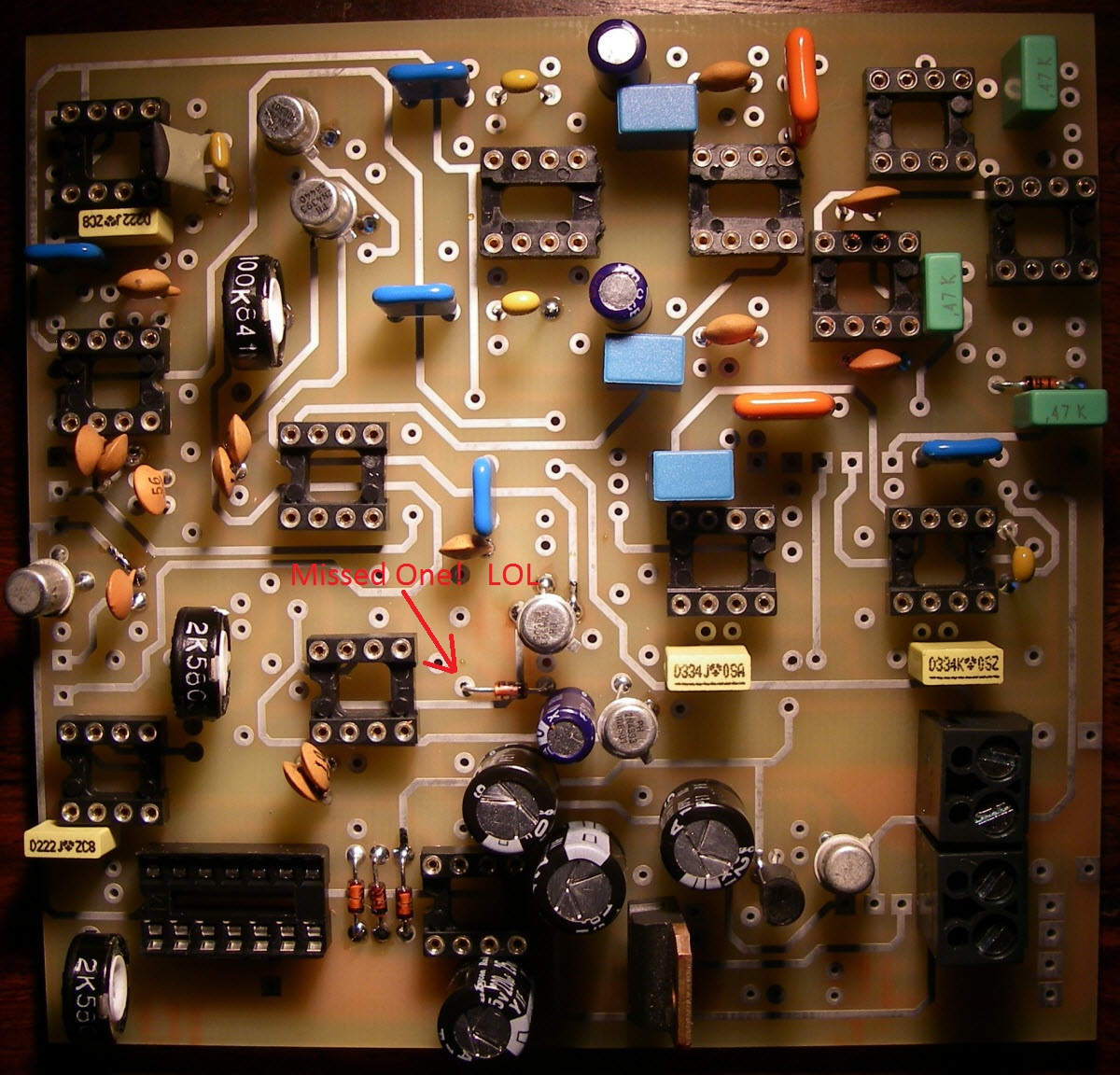

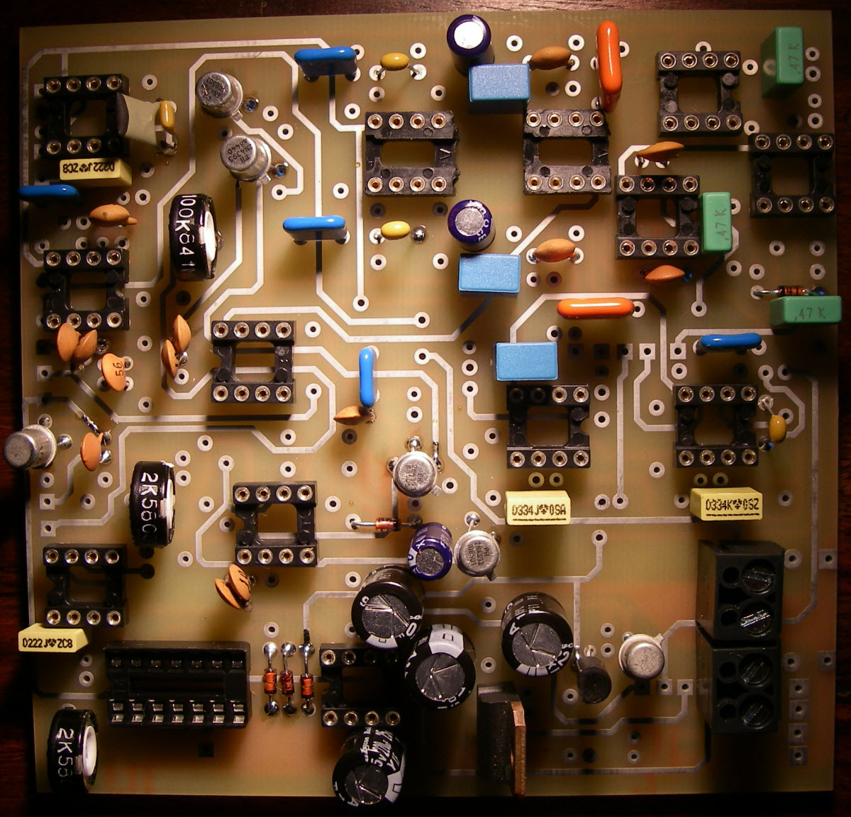

          Hello all,
          Now some components on it, this is enough for today .
          • #95
            Looking good there!

              Thanks "homefire", I don't miss this one, the copper path for this diode is below and the weld is well made, thanks again
              • #97
                That's cool.
                It looks like the solder wicked up the others to the top pad.
                Seen none on that one.
                Your Da Man.

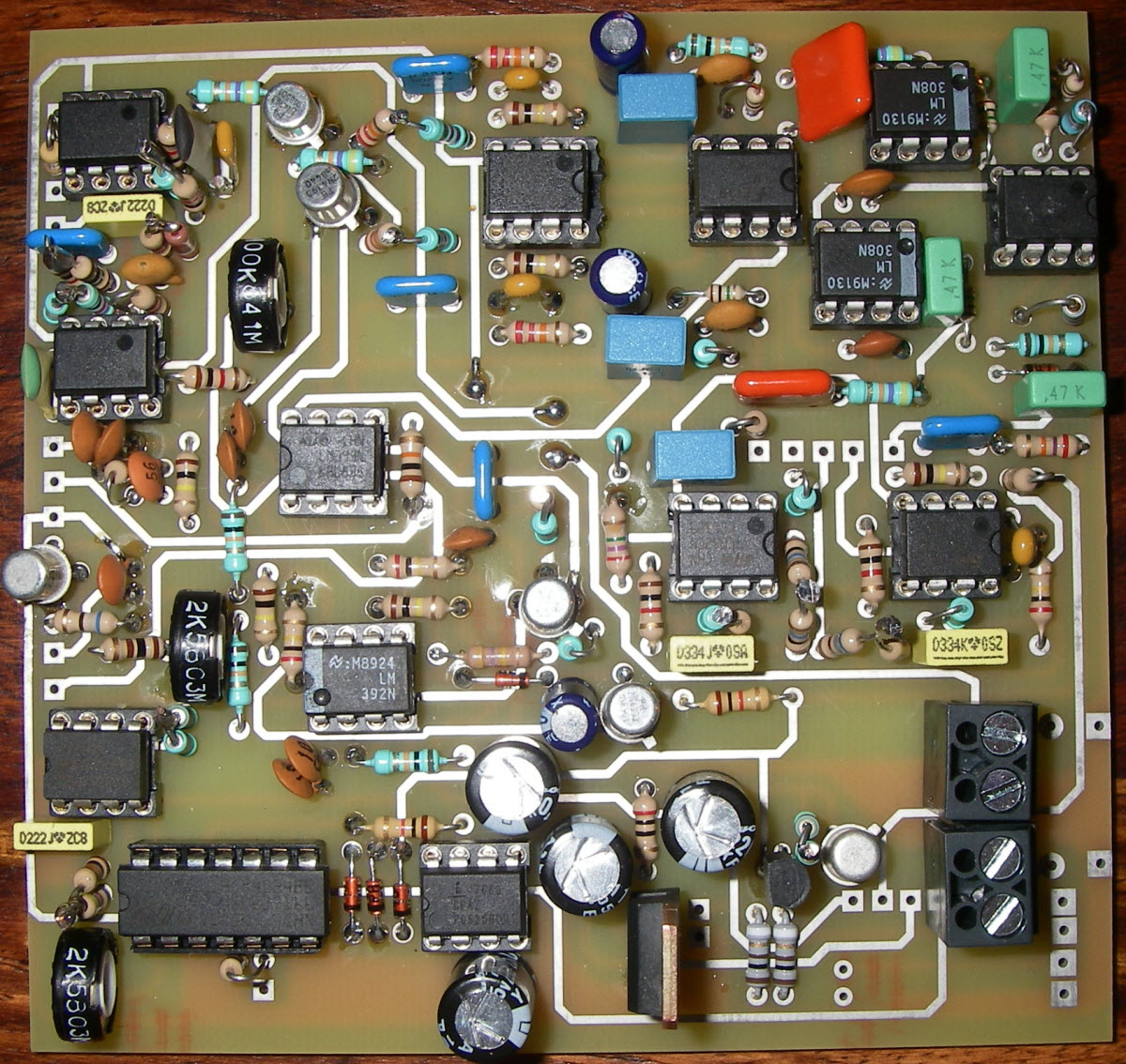

                        • Hello all,
                          I have put all components on it.
                          All the best
                          • Hi Legaucho
                            In original lobo photo i see precision capacitor and metal film 1% resistor.
                            Look at brown capacitor and resistor around rx stage.
                            Low thermal drift components, and low noise are important in rx stage and phase shift stage in other stage they aren't soo important.
                            I hope you will havent problems but if you note instability or noise you can try change that components.
                            Bye Maxbiri
