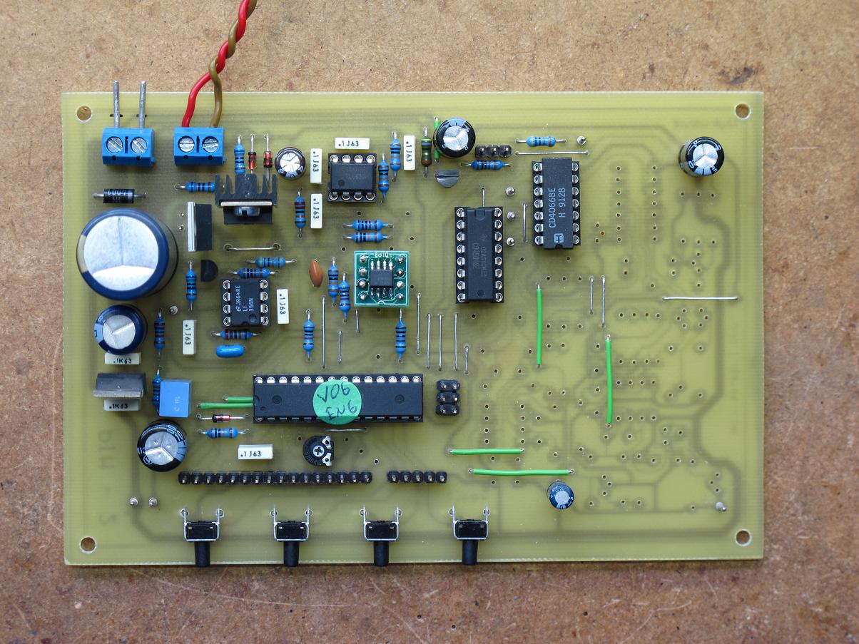

        elbombaci, thank you for programmed ATMega8 V06, but PIM2 didn't work. At startup,
        I get a "Coil Error". I try different coils without effect. The PCB works fine with V05 before modification.
        Jürgen
        • #94
          Hi Miata, thanks for photo.
          This problem due to PCB. You scrape your PCB as the following photo.
          Your damping resistor must be:
          560R~680R for 35cm Coil
          470R~680R for 1m2 Coil.
          Best Regards

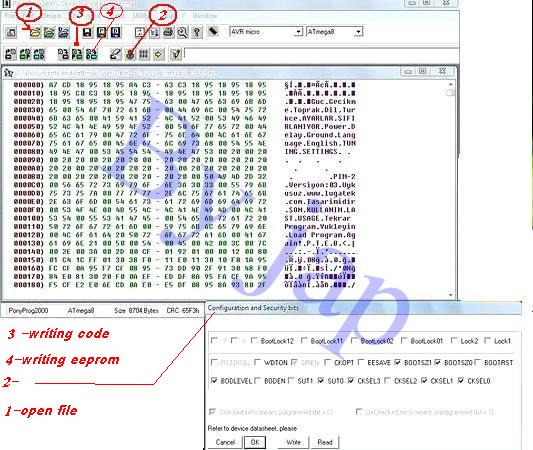

                    • Hi volcano
                      To this stage you have a Hardware(programmer) + Software to do programming avr- I can explain first in the software that you use-- to choose the writing code from file code type,and choose writing eeprom from the eeprom . types depending on the type of programming selected File Type code,eeprom.
                      --So programming will be on two, according to choice in the List choices of software--
                      best time
                      j.

                          ok jap I use PonyProg2000 - Serial Device Programmer
                          Version 2.07a Beta May 3 2007the
                          the eeprom is ok
                          but the flash (code) (write failed)
                          • Hi volcano
                            follow 1234!!!!!!!!
                            what ver use?-There is comment on it must be followed!
                            best time
                            j.
