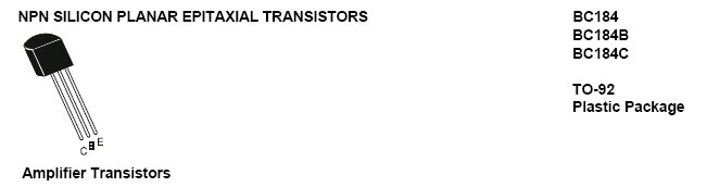

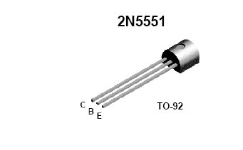

            what transistors are you using ?
              I used the 2N5551
                2N5551 and BC184 are 180 degree reversed for pins - have you inserted the reversed from picture on easytreasure ?
                  Like this
                    the position of the transistors and have taken into account
                    that are different
