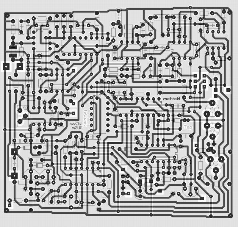

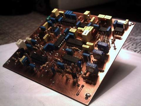

      i only thought i could help others- i buy one minelab musketeer this weekend and had the idea to redraw the pcb this was a special version build for or from deep scan detectors (metal case, and maybe a mod on pcb but i´m not sure will see it when i got the detector next days)

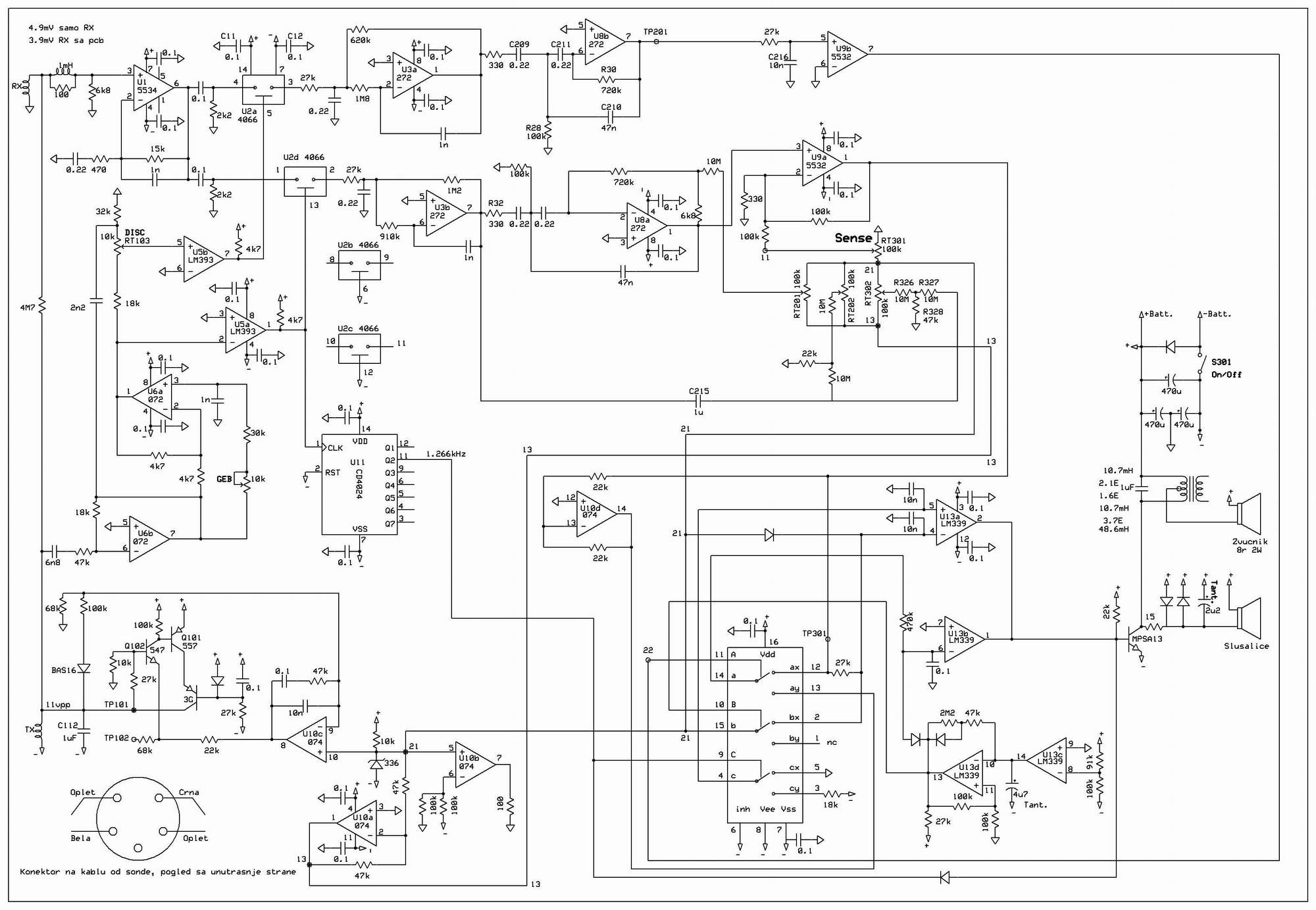

              Yes, i traced it out last autumn. Musketeer and Relic Hawk too.
              I think Qiaozhi posted those works somewhere on forum.
              If you analyze those files, pay attention only to Relic Hawk schematic, because it is accurate and checked few times.
              Later i was lazy to draw again schematic separately for Musketeer, but i just used Relic Hawk schematic and excluded extra parts which are not present at Musketeer.
              Doing that; i might made some mistake and left or missed some component.
              Fact is that Relic Hawk and Musketeer (all versions) are based on exactly the same "platform" and literally are the very same detector - with difference that Relic Hawk is having some extra parts which forms switching circuits for 3 separate modes of operation: S,M and L.
              While Musketeer is not having those parts and is settled up as only "S" mode at RH.
              So... logically; RH schematic is more complete and more accurate.
              Now is good time to compare this RH schematic with our earlier efforts to make it right.
              In meantime i made 4 Musketeers and those are working just nice.
              Cheers!
                  can you do pcb photos under daylight and share?
                  (please, NOT camera phone made, NOT under room light condition made, NOT blure made etc.)

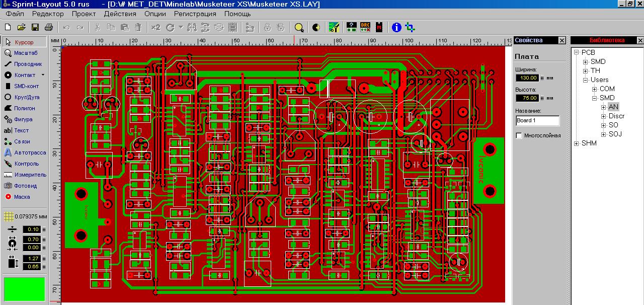

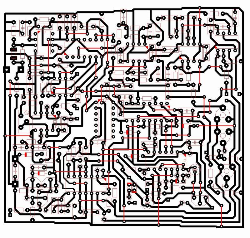

                      ivconic , I want to build the musketeer, do you recommend me to use your SMD PCB version or to build one from scratch (from the schematic) using DIP.
                      Thanks.
                        Thanks.
                        SMD is better choice.
                        Use this one , it is "revisited" version from 2022.
                          Thank you!
                            ivconic, can you check if the file MMusketeer_2022IC.sch inside the zip opens for you? For me it does not open, I can open only the .lay files. Thanks.
                              Install this: https://www.expresspcb.com/
                              There is the Schematic part in the package, whch will open it.
                              I am using it for decades, to draw my schematics.
