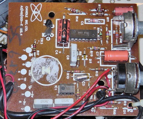

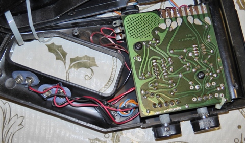

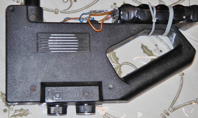

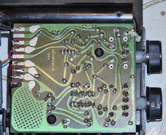

TR200 PCB photos
Hi, it was my son's detector 10 years ago. It works - the only mod done to it was to replace 2x9V batteries with 5cel x 1.2V pack + NMH0509D. I use this mode for years with other 9V detectors. The detector is made of IC1-LM741CN, IC2-4016BE, TR1-BC214B, TR2 and TR3-BC184B. It detects US 25c from above 20cm in air and go silent with nails.

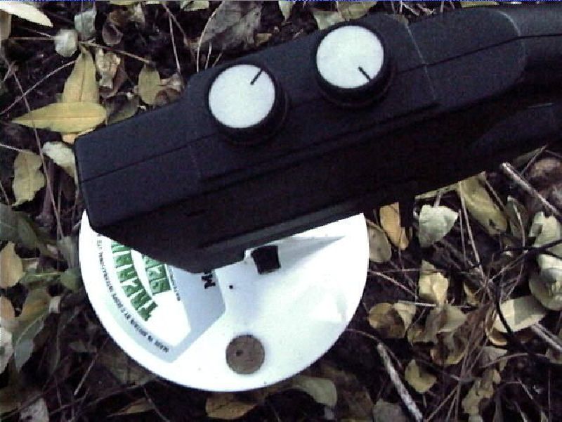

I came back to this detector for experiment - how deeper it can go with number of simple mods to be applied - just to see what can be done. The coil is only 6in (15cm). It works as static detector.

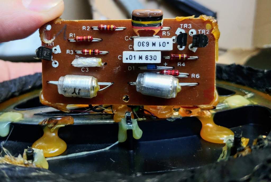

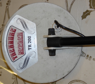

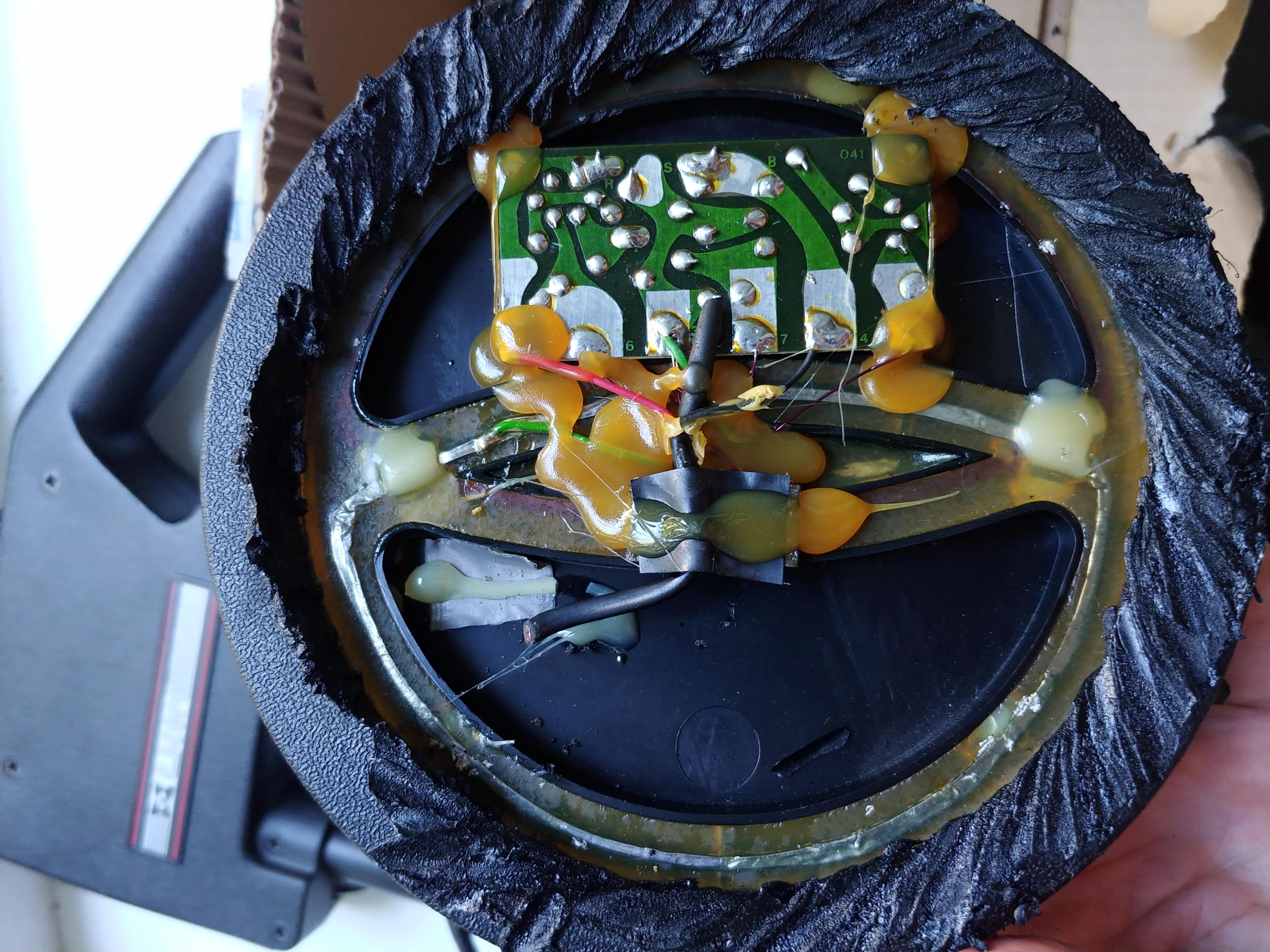

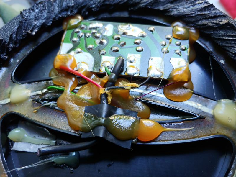

C.scope TR 200 Coil inside
Here some pics inside of C.scope TR 200 coil
Looks similar to an old C.Scope.
