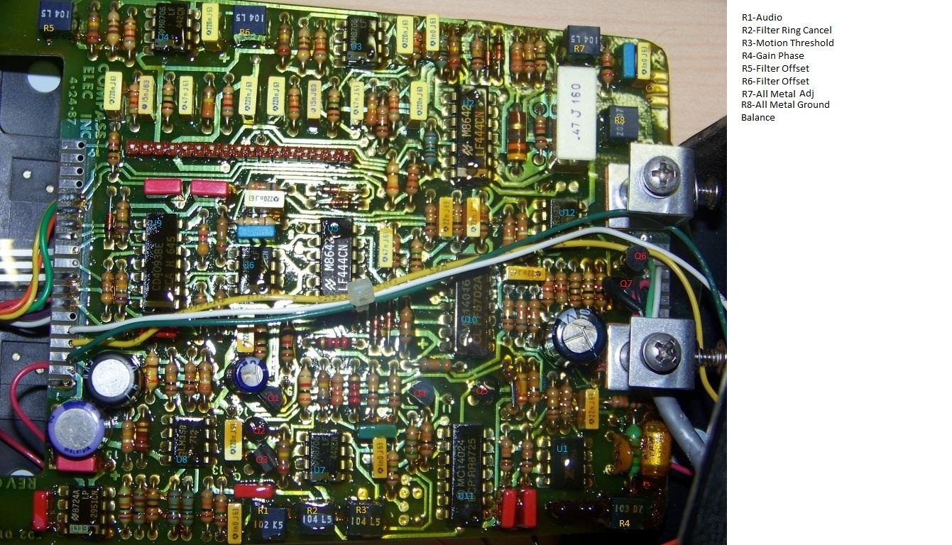

    ....Want to get an XP-350 for a project....I was told a while back that this detector has all of the ports or whatever to add components to upgrade it to an XP-Pro...I bought a Coin Scanner as a Parts detector and plan to add the meter and maybe other controls to the XP-350..I already have an XP-450.....and in the rare case that I could not locate an XP-350....I could use this instead but at the moment would rather leave it intact.........would appreciate any comments .....Thanks....Joe

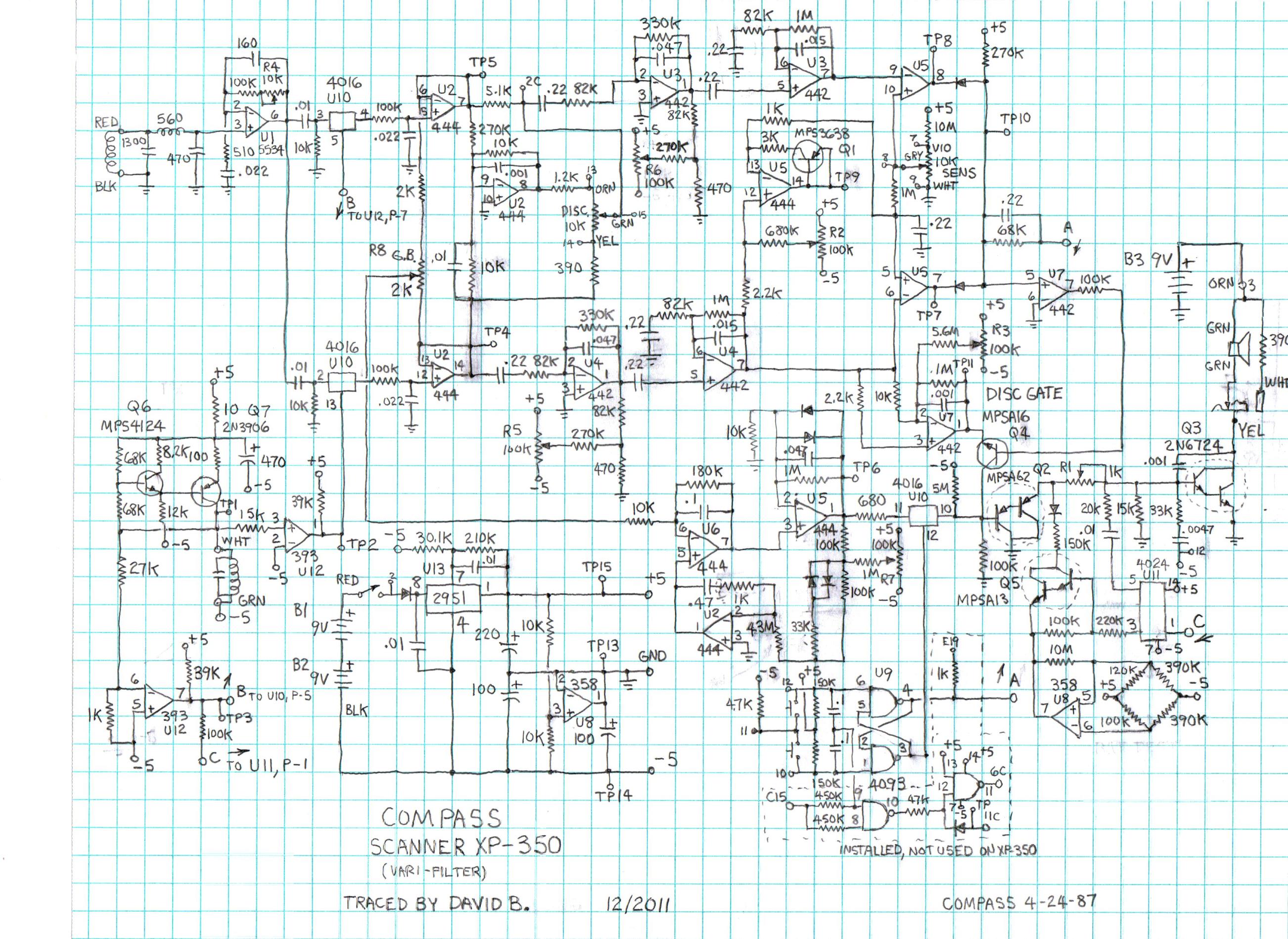

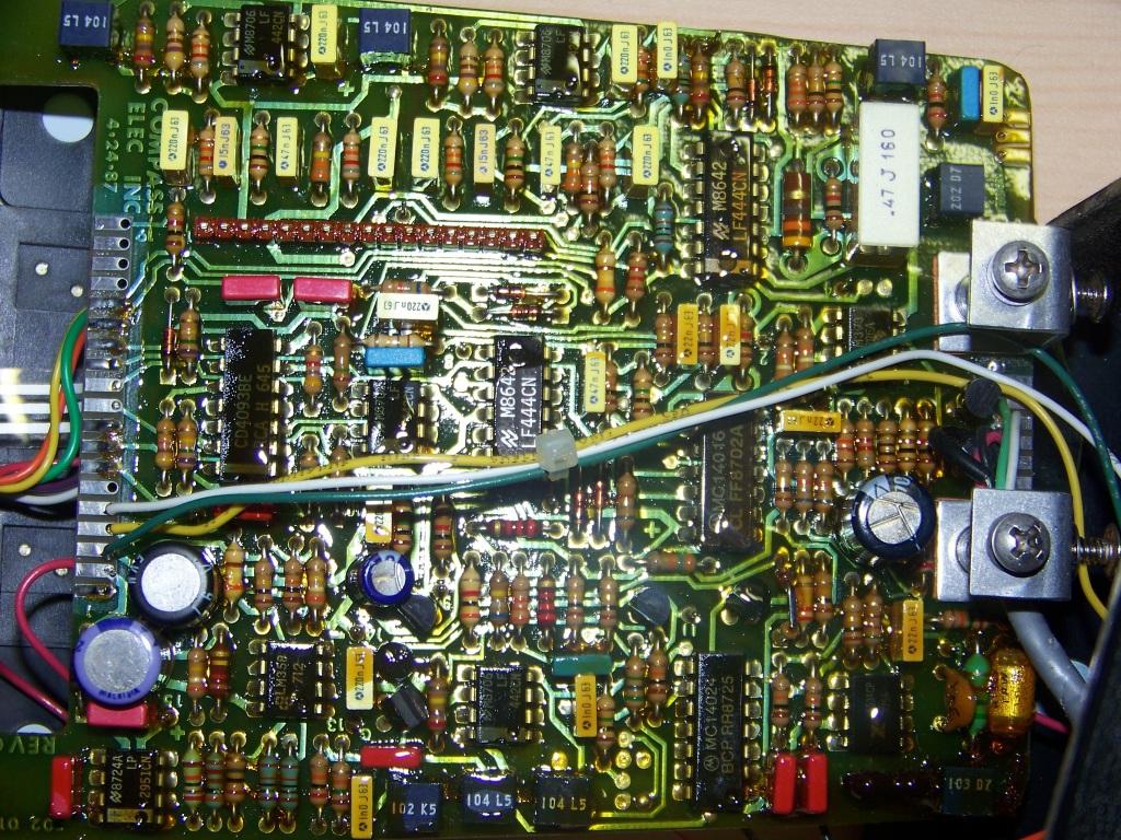

        The XP-350 bd is the same as the bottom bd. used in the 2 board Pro. There is a picture of those 2 bds posted on this forum under coin scanner Pro. I have made the schematic for the Xp-350 and I will post it after I put it in a neat one page format. If the top bd on your pro is in good shape or at least repairable then you should have what you need for the conversion. The top bd circuit is for notch and target ID but the bottom bd circuit is the actual detector. I don't have a schematic for the top BD.
          Compass XP-350 schematic
          Here is the freehand version

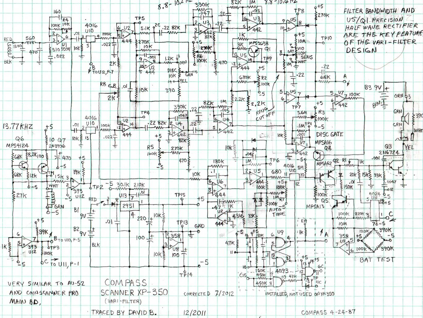

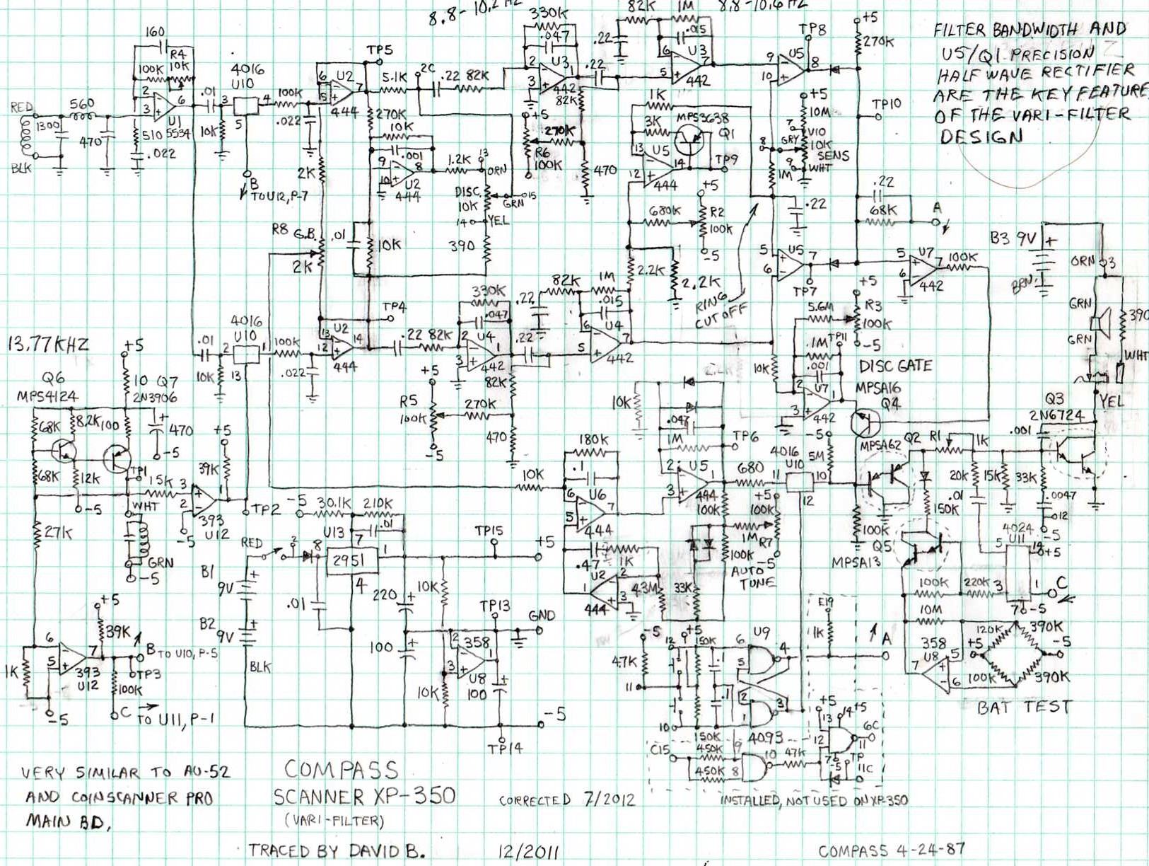

            I found errors. Resistor 82k which is connected to U3(1) should be connected to U3(5). Analogically situation is with U4.
            Mrand
              You are right. I see that when I transferred the drawing over to a one page format I connected the offset adjustments to the wrong side of the capacitor. They are supposed to adjust the DC level on the non inverting inputs of the last filters. I don't think that I screwed anything else up.
              When I get a chance I will take this detector to work and save some scope wave forms from the test points. I spent a lot of time tracing out this 25 year old detector. I hope this drawing will help some people with troubleshooting. I sure do appreciate all the different detector drawings that others have posted. I hope that others will continue to share. Not sharing metal detector schematics is pure evil.
              DavidB
                Corrected schematic. Does anyone know where the vari-filter patent is or if it was even granted. All the detectors that I have seen say patent pending.Click image for larger version

                          I almost have the entire schematic for the top BD ( notch, target ID) completed. I just started looking at it again this week. Pretty soon I will draw up the whole thing in Altium. I plan to route a SMD BD with some upgraded parts and a few changes for this. Would be nice to have a compact lite weight version of this classic favorite. Hang in there it is coming. I just have a lot going on.

                              There are some other mistakes that need correcting. The base of Q7 connects to the collector of U6, not the emitter and there is a missing phase shift .0022Uf capacitor at the input of U12 pin 3 that connects to the minus 5V.
