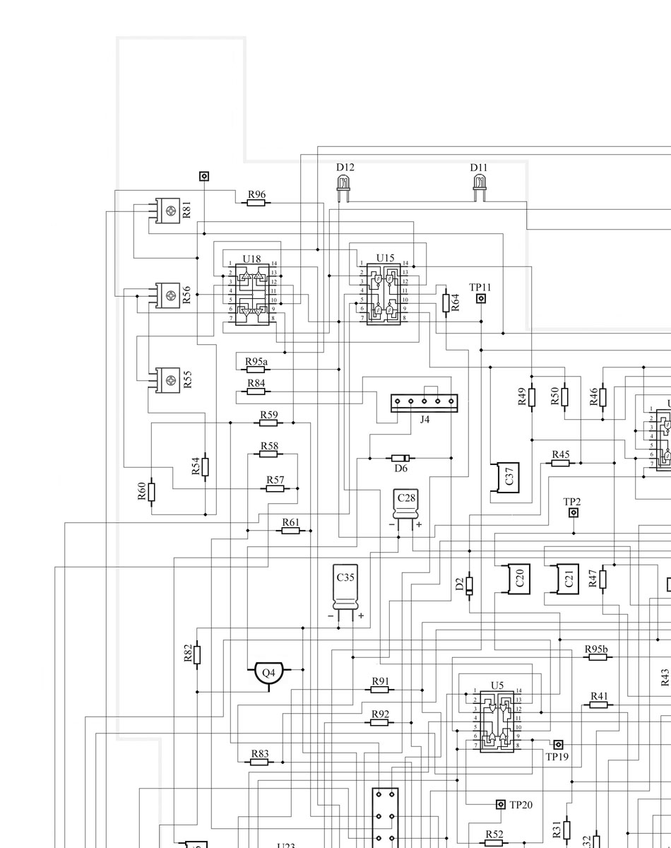

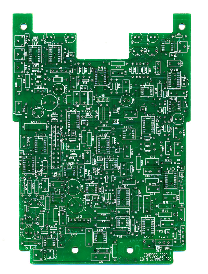

I have finished an electrical layout or diagram of the circuit board for the Compass Coin Scanner Pro - Pro II. Anyone that would like a copy of all the sheets in Jpeg format, PM me and send your email address as there are too many sheets to post here. Along with the circuit board are wiring connections also. Not to scale, it is just representations where they connect. I don't know if all CS Pro - Pro II circuit boards are the same as this one. I also have a corrected schematic if anyone would like this also. If any errors are found, please post the correction(s).
Compass Coin Scanner Pro - Pro II Electrical Layout

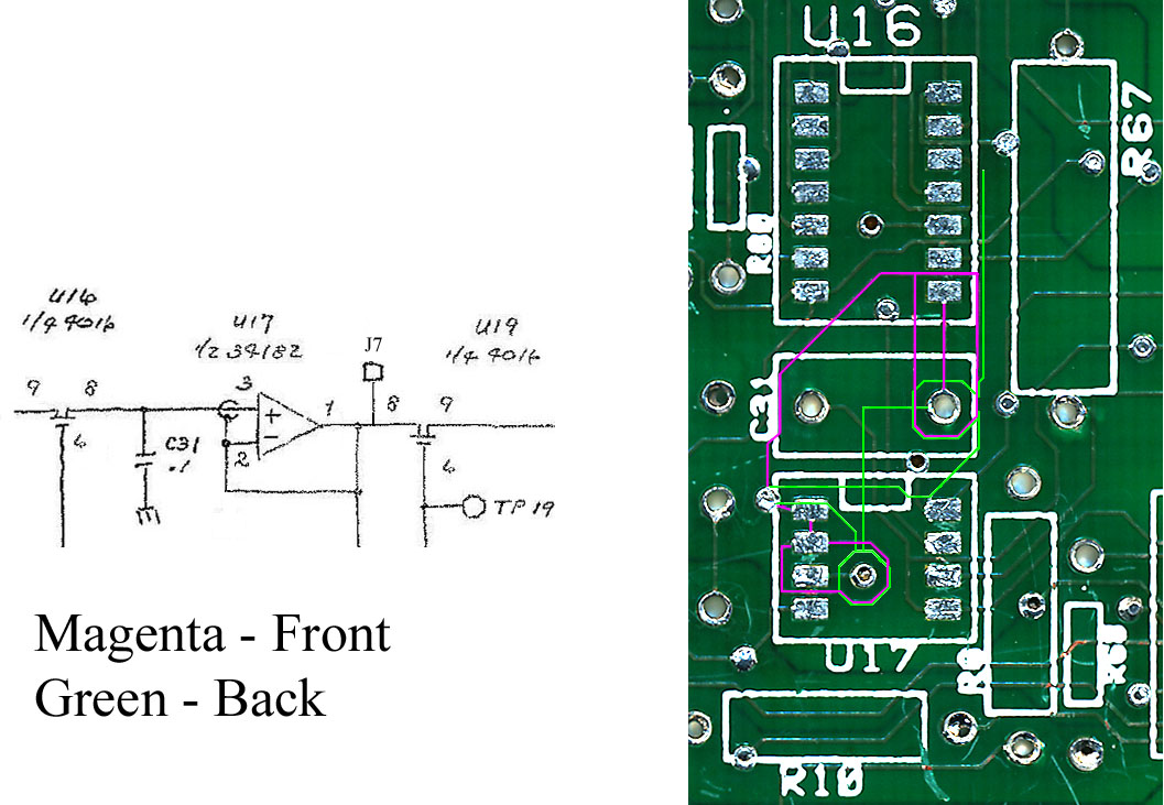

Question On CS Pro Schematic
On the schematic it shows a semi circle as shown below. On the circuit board the trace line leaves and then goes around and then comes back, forming a loop but it doesn't go anywhere else. There are 4 different places that it does this on the schematic and circuit board. Pin 2 loops around pin 3 but doesn't attach to pin 3 or anywhere else including any internal trace lines. Pin 3 goes to a thru hole then goes to C31. What is the purpose or function of this loop? These are the actual trace lines. The green trace line that stops goes to U16 Pin 8.Attached Files

It's commonly called a 'guard ring', and they are used to shield sensitive tracks from pickup of signals from other tracks, and general EMI pickup. They also prevent leakage currents flowing, as the voltage on the guard track can be arranged to be the same as the guarded track, as here. This would be used in sample-and-hold circuits, integrators, where a cap is storing a charge, or where currents are very low. They can also be used in reverse, to reduce emissions from noisy tracks. A complete loop isn't essential, but is commonly done.

Thanks Skippy for the information on the 'guard ring'.Originally posted by Skippy View PostRon.
