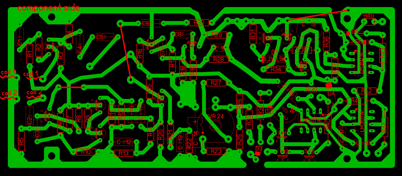

    For someone who already got experience with electronics, it may be easy to reproduce the PCB as it is confirmed to work. However, the one who attacks this as a project may have problems to get a working coil. A sensibility of around 23 to 25 cm on a 10 Cent (Euro) coin with an original coil (air test) will probably not be matched. My efforts to reproduce a working coil resulted in only 3 to 4 cm sensibility for a 50 Cent coin. Coil data will be provided later in this thread.

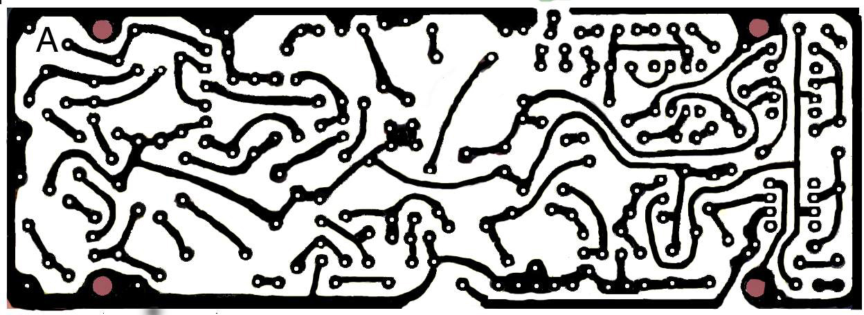

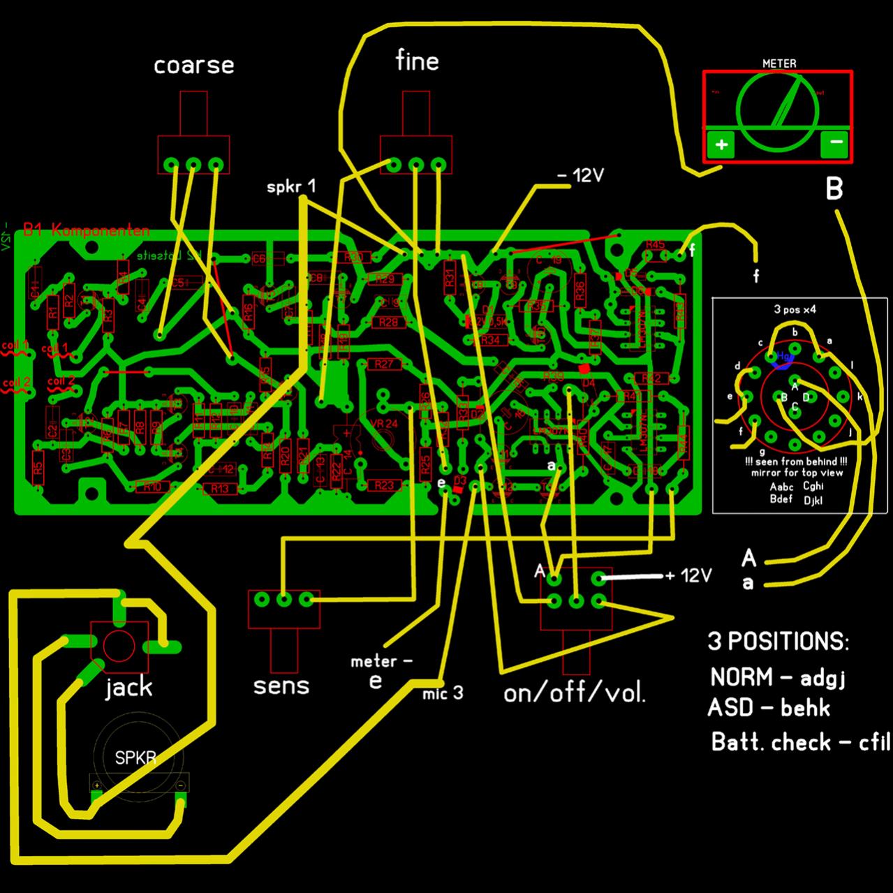

    The PCB works. I got one manufactured based on the Sprint-PCB file pictured below, it is working pretty well with an original coil. You may notice that the PCB done with Sprint is a bit wider (16 x 10cm) than the original PCB, original dimensions are 14,7 x 5,1 cm.

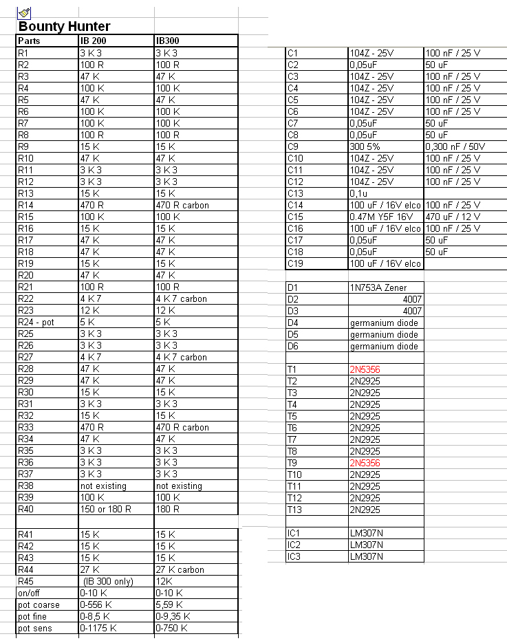

    Part list will be published below.
    Although the essential has been said, I have one open question to someone more advanced in electronics than I am (Don’t forget, I’m only a tinkerer.):
    Can someone identify for me the different blocks (TX, RX, oscillator, comparator (?), pre amp, amp, audio and so on) on the PCB?

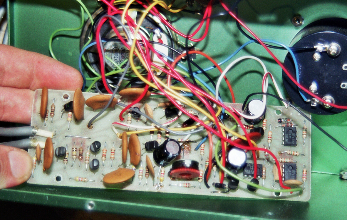

    picture of top side of the PCB

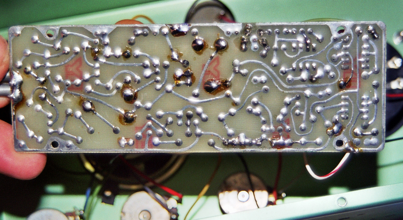

    picture of copper side of the PCB
    black/white picture of the copper side (147 mm x 51 mm)
    parts side of the PCB (printed file from Sprint-PCB)
    parts side of the IB-300 PCB with wiring (printed file from Sprint-PCB)
    part list
    here is the part list

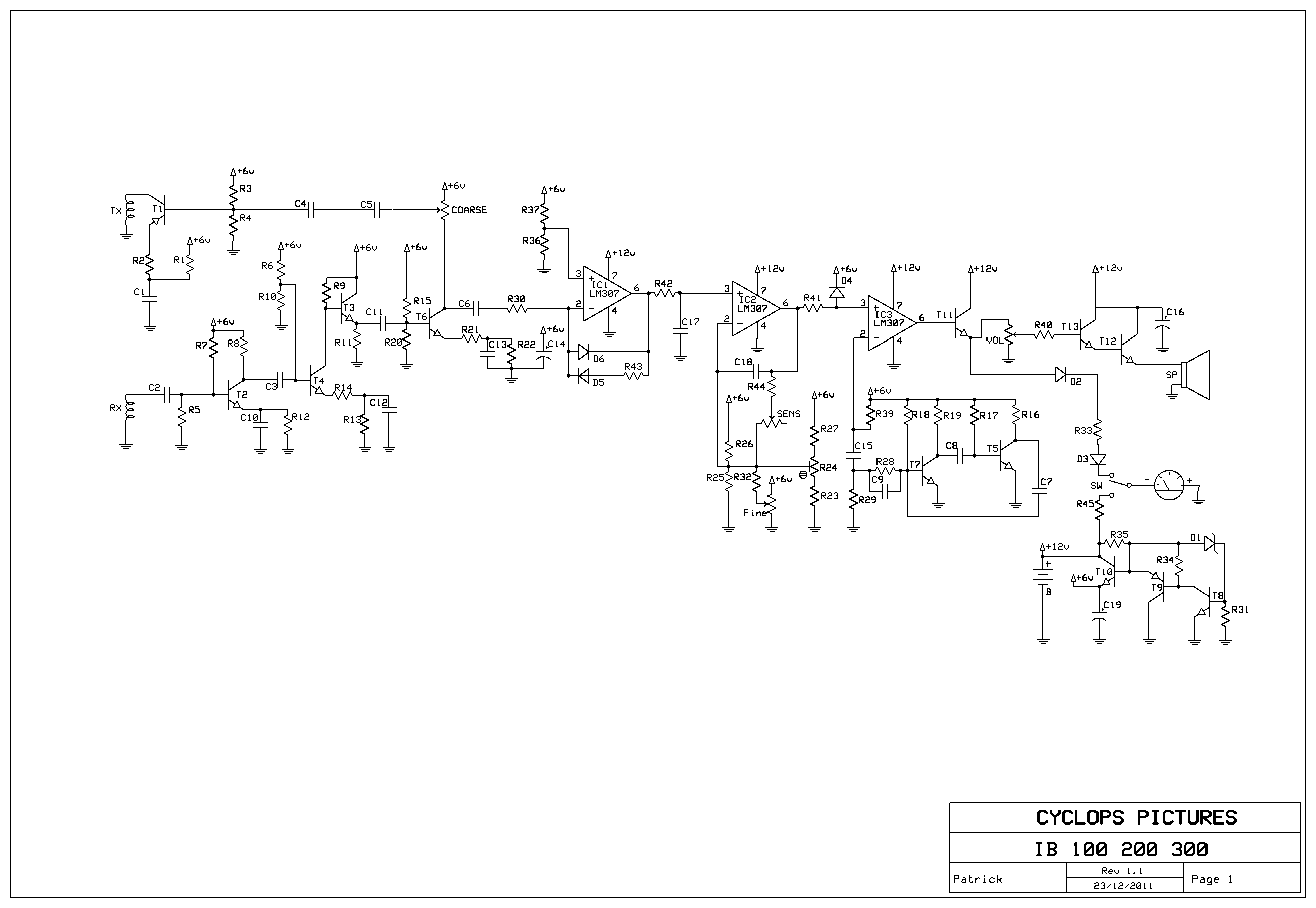

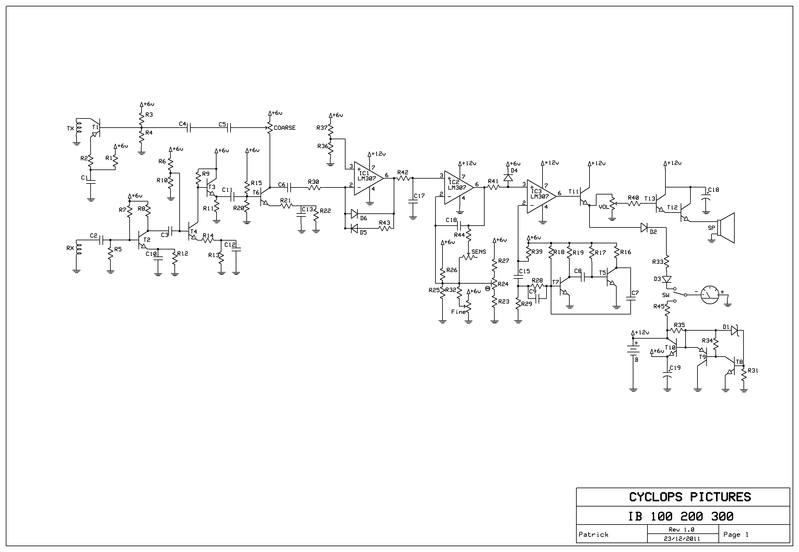

      Can you please post the schematic if you have it?
        hi porcluvr,
        i just did the PCB in Sprint, I tried to do schematic but failed miserably
        (that's basically one of the reasons I also failed to do a bloc diagramm)
        if some one can do it: thank you in advance
        cyclops
          That's OK - I guessed there might have been mis-communication. Maybe somebody will be able to RE the schematic from the PCB you've provided, it doesn't look terribly complicated. (But - it won't be me.)
          I have a few failures under my belt when it comes to trying to work backwards from a PCB.
          Regardless, I'm sure you'll have folks wanting to reproduce the IB300 based on what you've already put here.
            Originally posted by cyclops View Post
            hi porcluvr,
            cyclops
            Notify me if there are mistakes.
              oh, wow
              thank you Patrick
              it will take me some time to work through ( and learn a bit, i guess)
              i am impressed

                    corrections to the schematic
                    Hi Patrick,
                    After a first check:
                    C14 (electrolytic cap) went lost somewhere: it has to be placed somewhere between +6V and GROUND
                    C18 got a double count:
                    - C18 near R44 is OK
                    - C18 near SPEAKER (top outer right on the schematic) has to be renamed to C16 (which is electrolytic and actually missing)
                    Count of caps is OK after these corrections; but I still have to check the emplacements.
                    All the other counts seem to be OK, but I still have to check the emplacemnets.
                    (to be continued)
                    All the best wishes for 2012 !
                    cyclops
                      revision continued
                      Something I noticed and have to mention:
                      On the PCB layout pictures, the transistors are uncorrectly annotated "E B C" and it is my mistake . It's a relict from a time I tried to use substitutes for the transistors.
                      It shall be "E C B" and will be respected in the next revised drawing.
                      The rest of the drawing is correct (do not forget, I already produced a working unit).
                      Patrick did not copy my mistakes, so the schematic basically remains OK. I checked all the transistors in the schematic and their connections: all OK, it's correct.
                      (revision to be continued)

                        revision finished
                        Hi all,
                        It seems as there aren't any other mistakes in the schematic.
                        Thank you Patrick!
                        For my own personal convenience (my ears are the only interface to my detector) I made a basic version for those who prefer hunting without meter, thus saving two diodes (D2 & D3)and two resistors (R33 & R45).
                        I'll contact Patrick and look with him if he sees a need in posting a rectified scheme (see post 10 above).
                        cyclops
