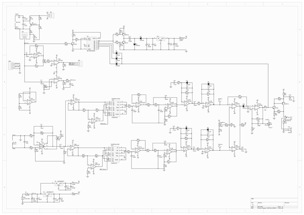

    Attached schematic of HEAVILY modified TGSL. Not sure if it will work (should) might require a LITTLE work. See what it does anyone?
    Uses Andy Flinds "Flindulator" demodulators (full wave) proceeded by 40HZ filters (to allow closer operation to power lines). An added threshold control AND sensitivity controls. Andy said these demods make the machine MUCH quieter as they pick of BOTH halves of the incoming signal. One are a BIG improvement could be made, is in the zero crossing detectors and the phase shifters. What Tesoro use is bluntly CRAP and amateurish. If ANYONE can get the two phase shifted signals up to a nice clean signal across the WHOLE range then this machine would be even BETTER.
    IF anyone builds this let me know how it performs.
    I WAS going to include Ivconics dual tone mod, but I thought I'd get the basic guts going first!

                    Looks wild with lots of extra op amps. It would be great if you could explain in detail what each of the added parts/sections does.
                    Certainly in principle a full wave SD should be better, as long as the extra parts don't kick in as much more noise.
                    Could you explain more about what you mean by "zero crossing detectors"? TGSL SD does not use zero crossing detection.
                    The output balancing resistors for the NE5534P probably aren't necessary I would think.
                    Look forward to hearing more analysis and results.
                    Cheers,
                    -SB
                      Simon you are right, a 47pF cap between pin 1 and 8 would suffice (silly me missed the AC coupling).
                      The amplifiers are a fairly low noise, so the design should be quite quiet.
                      The 40 Hz filters will take a lot of the noise present in other designs out, but may mean a slower sweep speed.
                      The two LM393's are ZCD's they square up the Tx waveform (they also incorporate phase shift). If you 'scope these outputs, you will see at the two LOWEST pot settings the waveforms are fairly sick looking, whilst at the highest they suffer fold-back and you get double peaks which mean all sorts of erm...cr@p on the switching waveform (some of which gets through onto the Rx signal).
                      Inherently Tesoro designs work, that's all, they are NOT state of the art by ANY means (neither is this for that matter) but it IS a lot more refined, especially as you said with the full wave lock ins.
                      I won't promise stupid performance (if any at all) in fact in the one I breadboarded, I put a LOT of stage bypass links in for example to take out the 40Hz filters (which MIGHT not be needed). This is meant to be the BASE of a platform to test different ways of approaching VLF design.
                      You could also repeat the integrators to get even better mineral handling (4 pole filters) if you liked - switchable Have play.
                          Which are the 40 Hz filters in your circuit? You said they were before the SD?
                          I know power lines wreak havoc with the TGSL, but I haven't figured out exactly how or where the problem is injected. The RX coil tank is certainly a 2nd order bandpass filter which rejects a lot of the power line noise. The Synchronous Detector should ignore most of the power line noise since it is a very very narrow band filter centered on 14.5 kHz. However, if the power line has harmonics near 14.5 kHz, that could be a big problem.
                          The amplifier section of the TGSL is a 4 pole (I think) band pass filter centered near 9 Hz, so it should reject a lot of power line noise.
                          It would be interesting to analyze exactly how the power lines do their dirty work.
                          Ok -- I thought you were saying you had an improved design there; rather you are saying it is an area for further improvement. I agree that those "sync pulses" get dirty -- the surprising thing is -- it doesn't seem to matter much! I designed a "cleanup" circuit, but never demonstrated any better detection with it.
                          The problem is caused because the TGSL oscillator omits the JFET feedback section and is instead "over-driven", causing a small bump on the sine wave. That bump gets differentiated by the sync-pulse circuit into a big hiccup, which can mess up the zero-crossing detection.
                          No wonder I like them!
                          Anything that can reduce the effect of noise in my workshop would be very welcome. I suspect that most of the problem noise is near 14.5 kHz and hard to get rid of.
                          I'd like to try some of these ideas out. I certainly have some nice power lines handy to test with!

                            Can see theres alot of hard work gone into the design, all we need now is one of us to make a pcb layout.
                            Many thanks
                              -SB
                              Just to expand on my own comment -- the sync pulse "dirt" is also partly due to the fact that the LF353 phase shifter is "underdamped", and when the inputs are over-driven by a large TX signal (the TGSL has a much larger TX voltage than the original TGS), the output "rings" after clipping the waveform.
