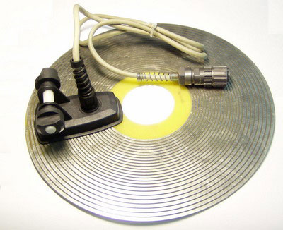

              SS performance isn't great. The printed spiral coil, somewhat short pulse width, and excessive sampling delay limit performance. All this is easy to fix. What's left is to pick a micro (any common PIC will work fine) and write some code.

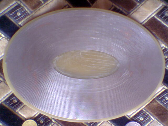

                          kt315 thanks for the advice but for now I will not make a second detector, because I am very satisfied Barracuda. What I will do his experiment with different types of coils for better detection of small gold. Some ideas I've picked up from Russian forum...
                            there is not the idea in these textolite coils, Maikl. if you had noticed (i hope) Andrej Fiodorov (andy) uses only basket type coil in last Clone as it has minimal parazitic feedthrough turn-to-turn capacitance. do not waste a time on them...
                              Yes i saw the coil of Andy and several other variants. I do not plan to make the "PCB coil" etching copper with classical PCB but only by means of wires. I have a lot of wire just a little time and I'll play around a bit ... Best regards.
