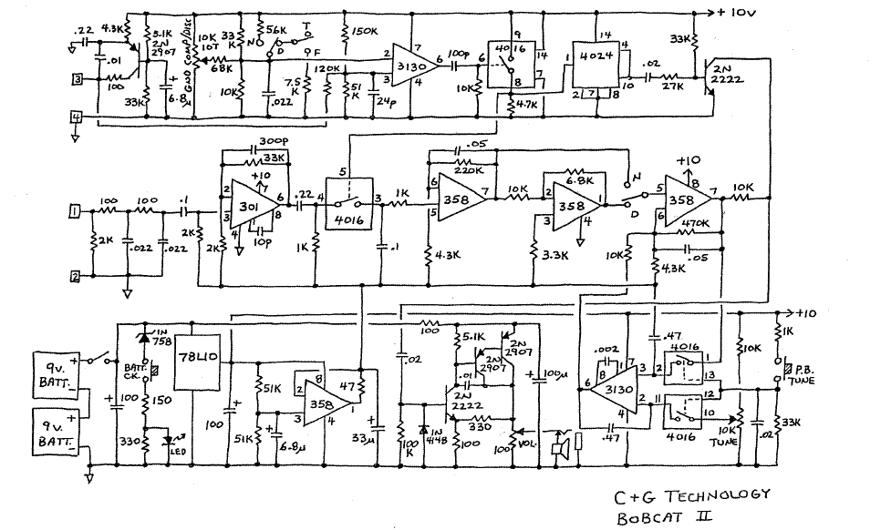

As the title indicates I need a schematic for a C&G Bobcat 2, and scans or a PDF of the operation manual. I have searched hundreds of pages online and so far all I have learned is I think this may be a rare model judging from the absence of anything useful about it online. I can say after using it (by guesswork as to operation) for a while and getting a feel for how it seems to work compared to many others I have used, I think I love this old machine. Even a little knowledge about the design and theory of operation would be useful. Simply amazing how much information is conveyed by sound alone after you get the feel of it in operation. This one has the push button auto tune function.

I haven't verified this schematic but it says it is for the Bobcat 2.

Thank you for posting this. Looking at the IC's I think this is a very good candidate for being the right one. Will have to take it back apart to be sure.
One question from careful study of this schematic is do you know if possibly there are errors in this drawing?
To answer my question I took my Bobcat 2 apart and hand traced out the complete circuit. What I found was the schematic posted above is correct, and not only is this the correct schematic for the Bobcat 2, but also the C&G model 200-1G is completely identical in every detail. What I do not totally understand is why the ground balance and discriminate are the same, single pot. How does this work? Hoping Carl will explain as I have never found the operating book for either model. The C&G TECHNOLOGIES Bobcat model 200-C is completely different internally. No idea why they gave it the same '200' series designation. I did not bother tracing it out as it's heart is a big black rectangle potted plastic block. As it has the same controls all I can think of is possibly it is the same circuit with 3/4 of it encased in a block of plastic. No desire to deal with methylene chloride to depot it and see. I can say however for anyone interested the coil is identical for all three models. A 6 inch coplanar, very standard design. TX coil is 15.5 ohms, 8.7 mH. RX coil is 8 ohms, 1.4 mH. Just in case someone decides to build or repair one of these models. Out of some 20 different models I own I still keep coming back to my Bobcat 2, I love this machine. So much so that I decided to give it a new life mounting the box and coil on the remains of a BH Tracker 4 I did not care too much for. Makes it much less stress using the MD out in the field and gave it a more modern look.
Only other thing I might point out is the values of the pots in the schematic above do not match what is in the MD in reality. Isolating and carefully measuring each gave 3K for the disc pot and 6K for the tune pot. No idea where C&G came up with 3 K and 6 K pots, yet this is what they measure. All other part values are identical except for some reason some use an LM301 instead of a CA3130 after the Gnd Comp/Disc pot. Unsure why C&G chose to randomly use one opamp over the other unless it is based upon what year the model came out, possibly a later design change? Leaving me with only one question to figure out. Is the Disc pot only Disc in Disc mode and becomes Gnd Bal in normal mode?

Thanks for your reply but it does not help. While Disc and Gnd Bal are similar they are not identical. What I was wondering was how did it become one or the other, since it is labeled both on the box. As near as I can tell it is changed by selecting Disc or Normal mode by selecting one opamp output or the other. Still not being completely up to speed on Disc and GB theory I had thought the only difference was the phase of the return signal. Yet inversion is the only difference I see between the two (study the diagram above). Meaning the difference between Disc and GB is 180 degrees whereas I thought it was less like say 10 or 20 degrees. Guess I still need to study.
