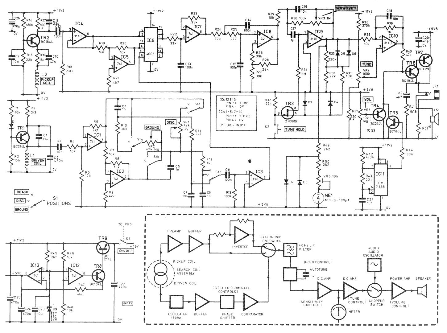

            What do you think about this one?
